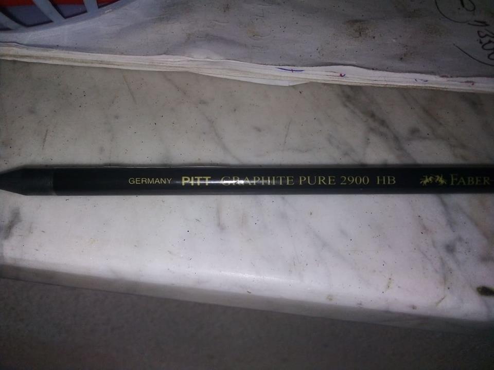

            • #51
              I used that.graphite pure
              resistance 65-45 ohm
              .Click image for larger version
