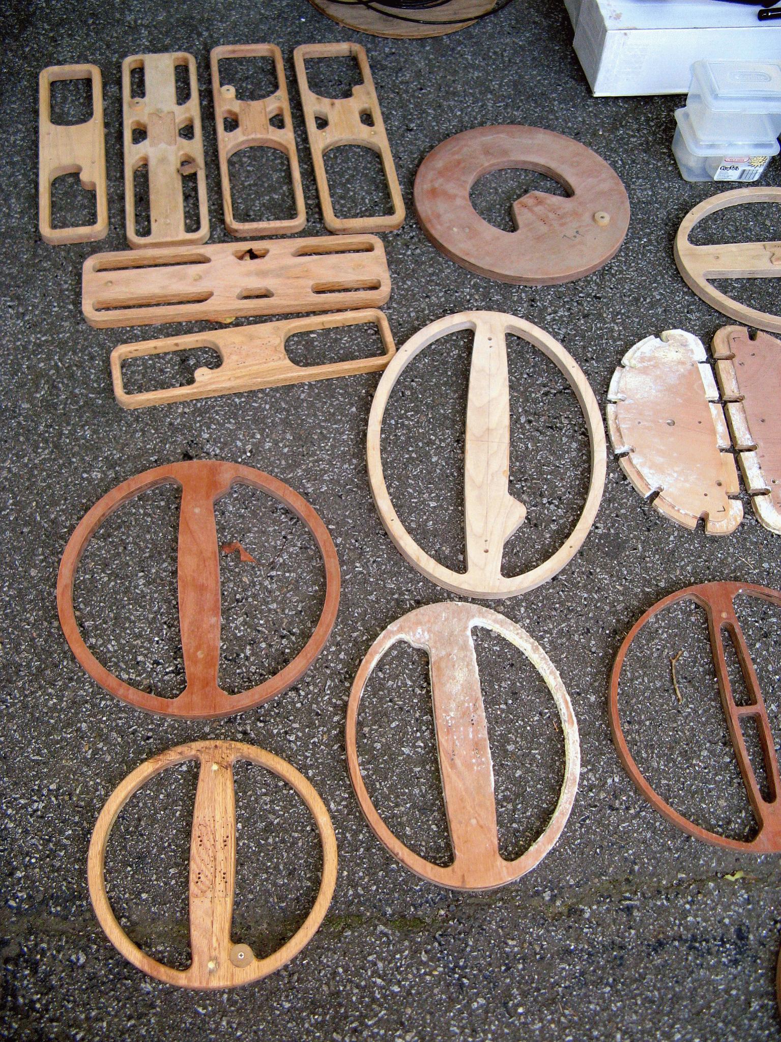

    Some interesting designs, all shapes and sizes.
    Think you just about have it covered .
      Just something I saw on another site somewhere. I need to make some new coils, but I want them to come out really nice like factory made style. It is kinda embarrasing hunting with crappy looking homemade.

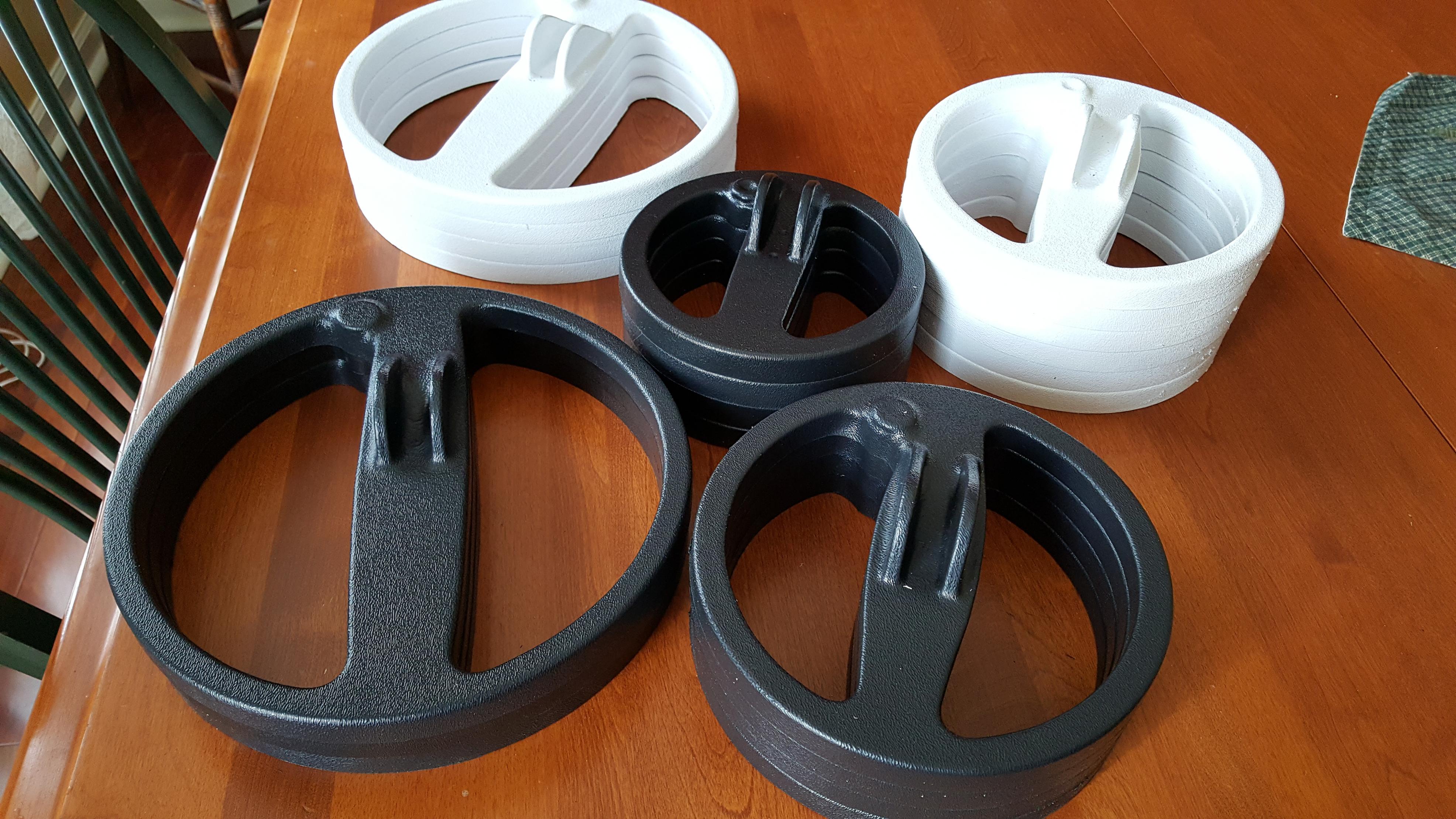

                I literally just bought some coil shells from Don Bowers (PayPal'ed him this morning).
                Have been emailing back and forth checking on what shells he has and our detector projects. So he does still make and sells these.
                He also lives only 100 miles (160km) from me.

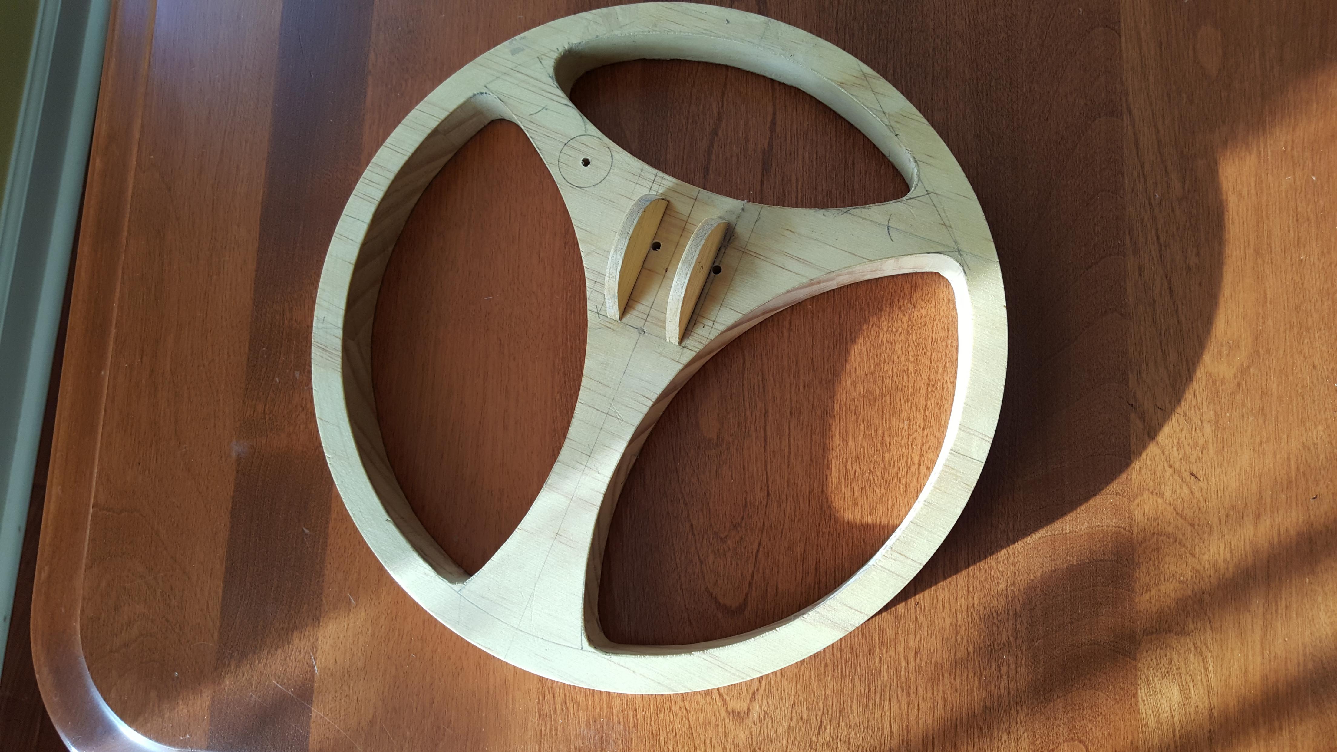

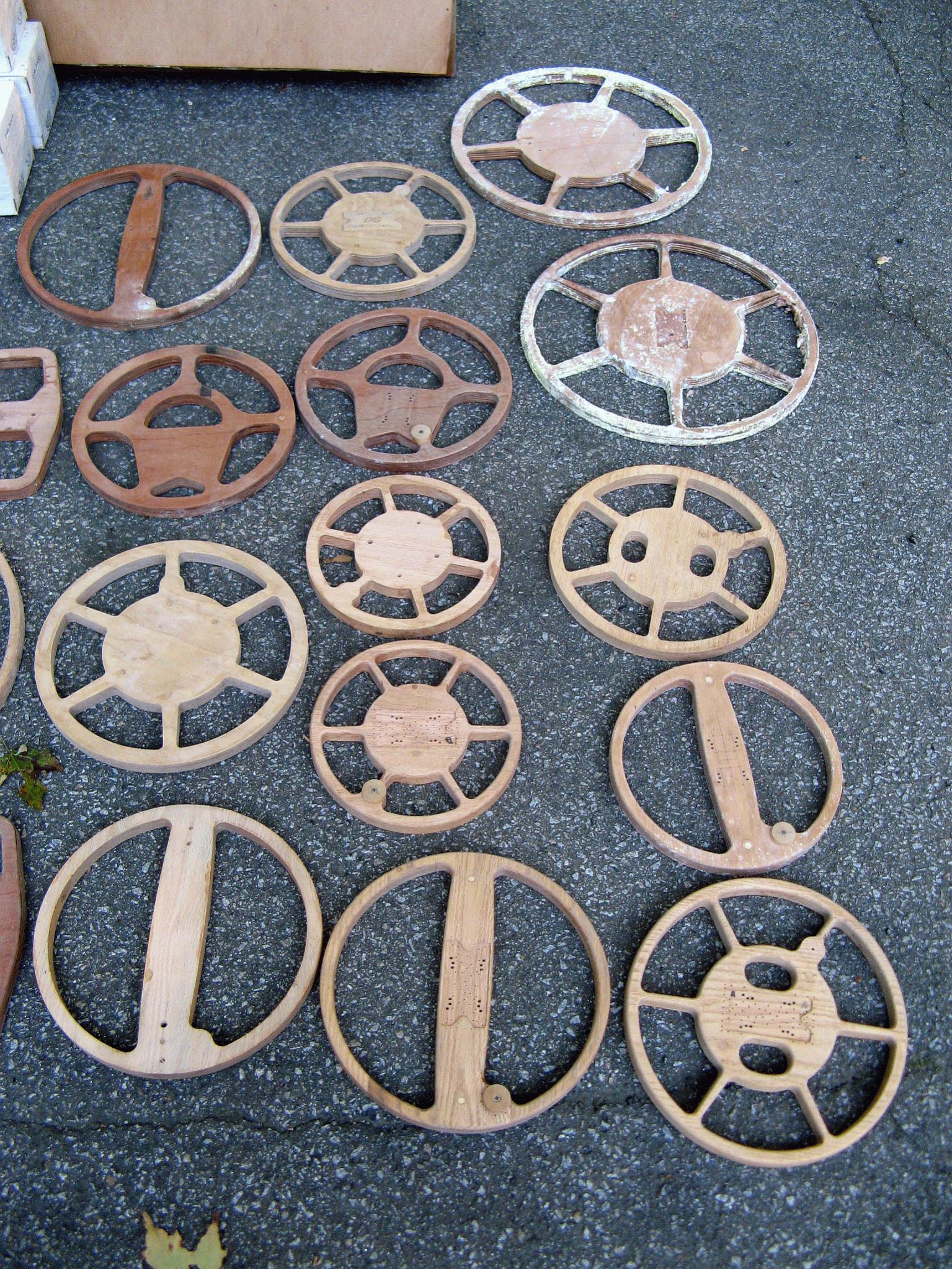

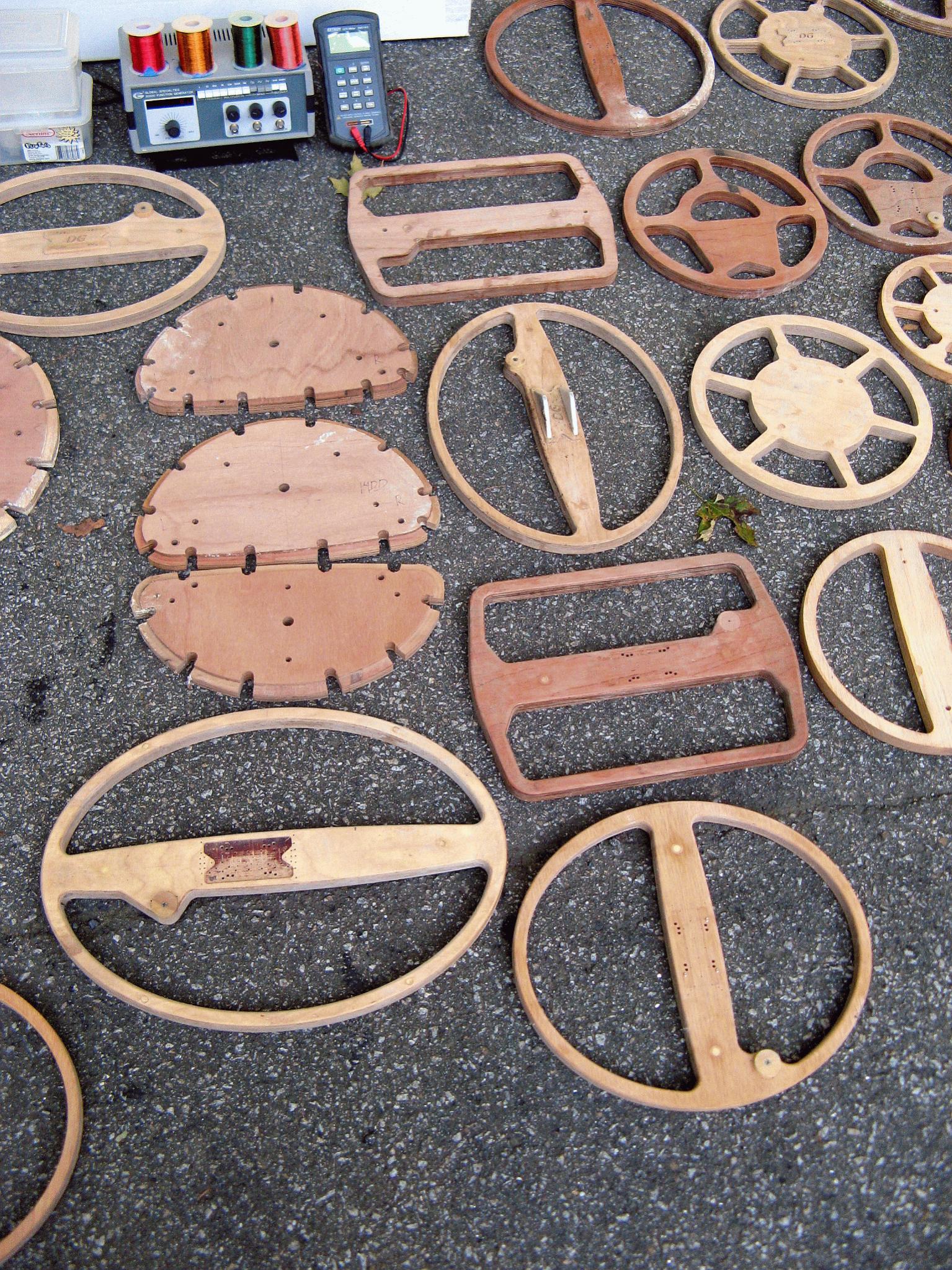

                  These are not my molds! As I stated in second post, I saw these on another site. As for making them, I have no idea, but they look to be made of wood, at least most of them.
                    Coil stencils
                    Some of them are plywood. Wood has strains only in 1 direction and in other is fragile (in thin ribs mainly). So I also mill all my stencils out of birch plywood with black/brown waterproof coating and I use nitro laquer for edges to keep it water (and mould) proof. On some of those stencils you can see mould on nearly half of their surface. Moisture and mould also twist these stencils... something you really do not want if you count time and material you sacrifice for it.

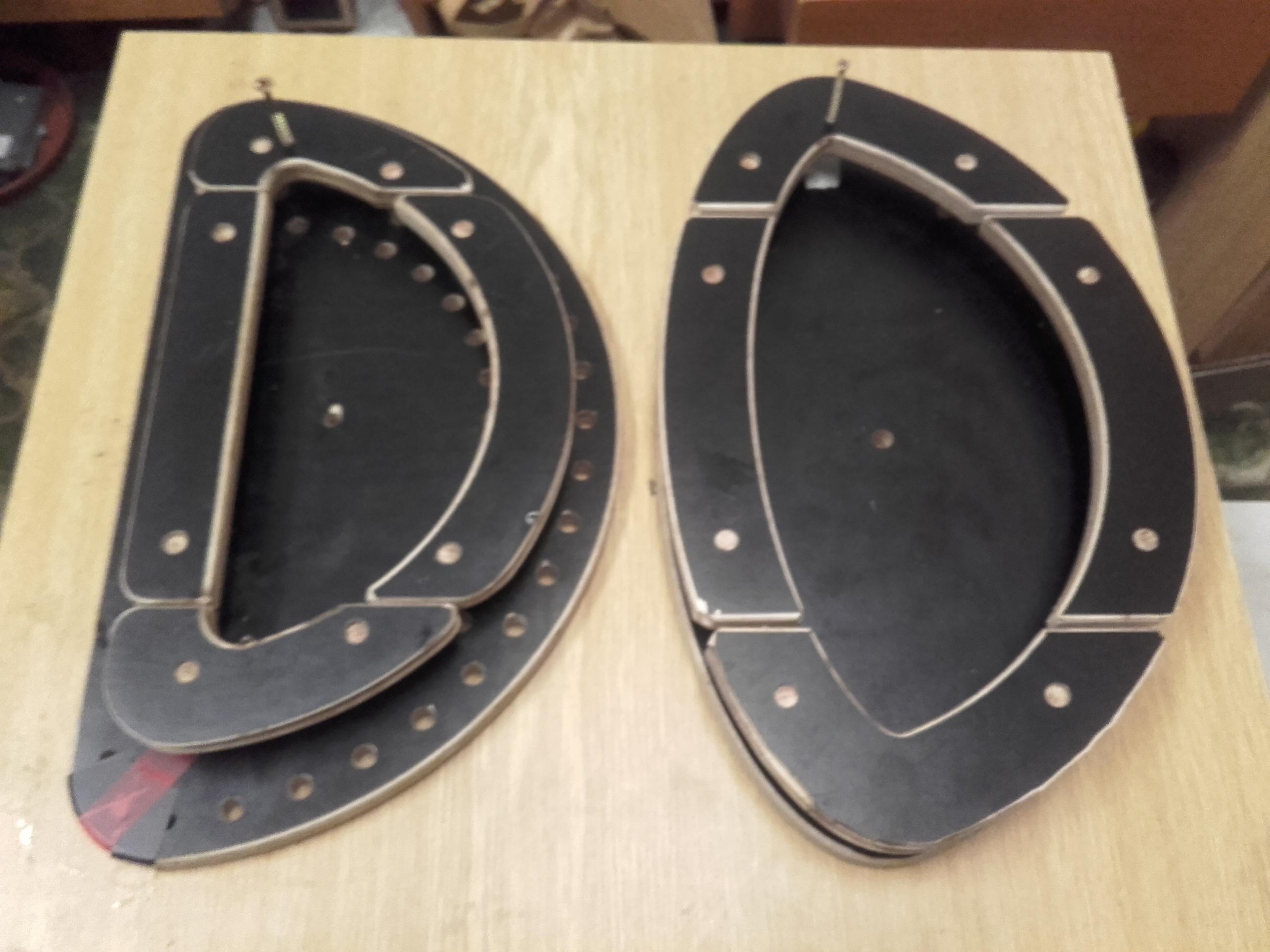

                            Yep! Still making them. It gets easier as I have made so many now. Probably 5 or 600. Anyone know where I can get forms made on a CNC mill? All mine are painstakingly made with a jigsaw. The wooden forms don't last forever, plus they shrink a little over time.
