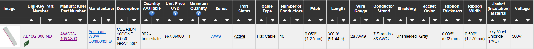

    Wondering if anyone has tried flat ribbon cable for winding spiral coils. Could split out number of conductors depending on peak current wanted. 10 conductors same as awg18. Price/coil wouldn't be to bad. Easy to wind coil. Any thoughts pro or con?

        Been winding my coils with awg28 magnet wire. awg28 solid can look like a target at short sample delays and limits peak current to 1amp maybe a little over. Trying to find wire with small strands that I can parallel enough strands for desired peak current to wind a spiral coil. Removing 4 conductors and winding a spiral(radial?) coil with conductors vertical and connected in parallel should give a coil rated for 4 or 5amps with awg36 strands. Maybe there is a better option to try?
          Is this method worth a try

            My error. I want to increase the current carrying capability. Conductors connected in parallel so probably not a spiral coil maybe radial coil?
