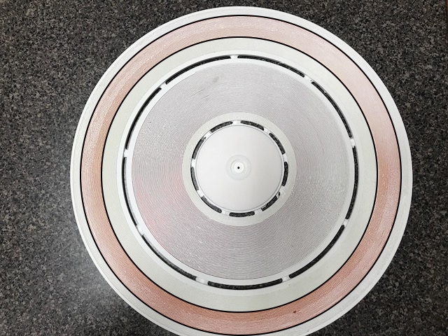

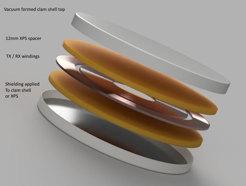

              I have included a photo of my concentric construction for some ideas.

ID:	352423Click image for larger version
