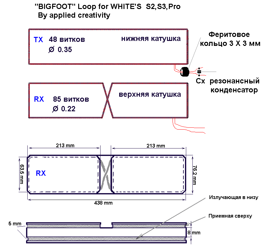

    I want to make a Bigfoot coil, for an excal to start with, later other detectors.
    I’ve been searching and collecting data on them, but let me start out by asking a basic question: what is the best way to optimize the design of the TX coil? Each model detector has its unique frequency and drive characteristics - how do you tweak the coil design to match it best? Something you look at with a scope? Resonance you tweak with added passive components? Sense with a remote sensor of some sort? I have the test equipment to make various measurements, see current waveforms, etc. to compare with a standard coil but I want to know how its done when you are starting from scratch.

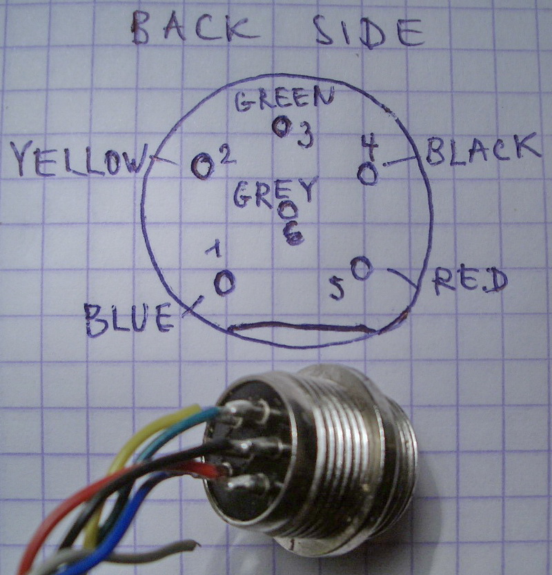

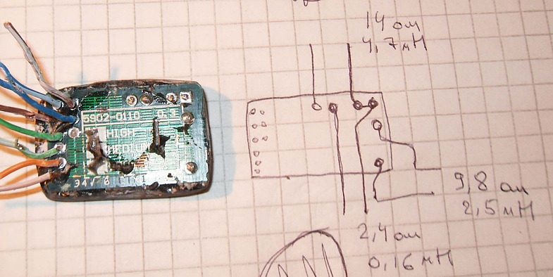

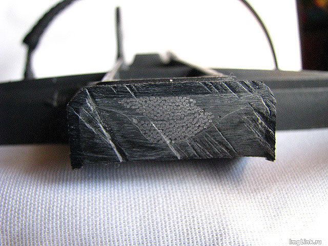

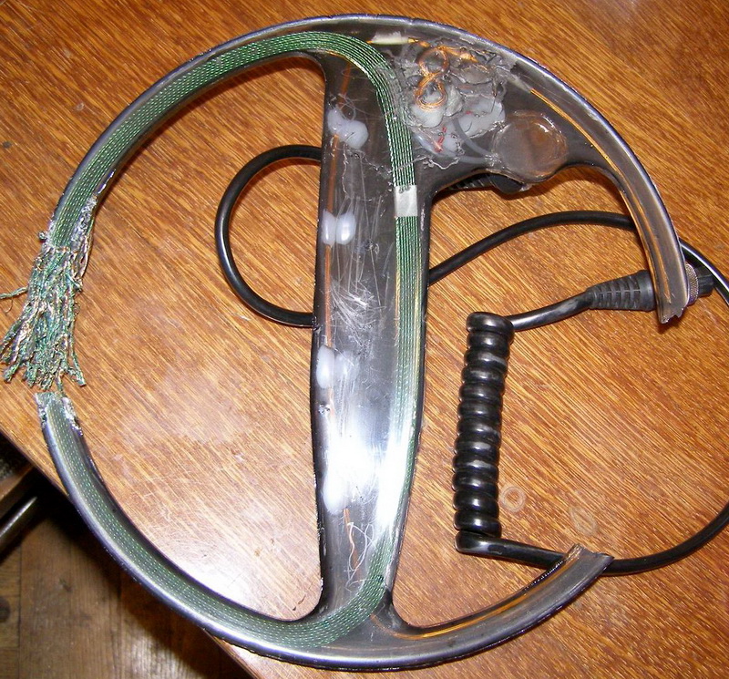

              Two different coils in your photos though, correct? The “slice” photo looks like a cut of the middle as you can see the missing shaft tang in the distance. Making me think I will never be able to salvage a board from an equinox or CTX coil. Even the “autopsy candidate” excal coil I have is epoxy-saturated like yours.
                you need my archive. i see that guy. you can do fantastical things then.
                  epoxy-saturated

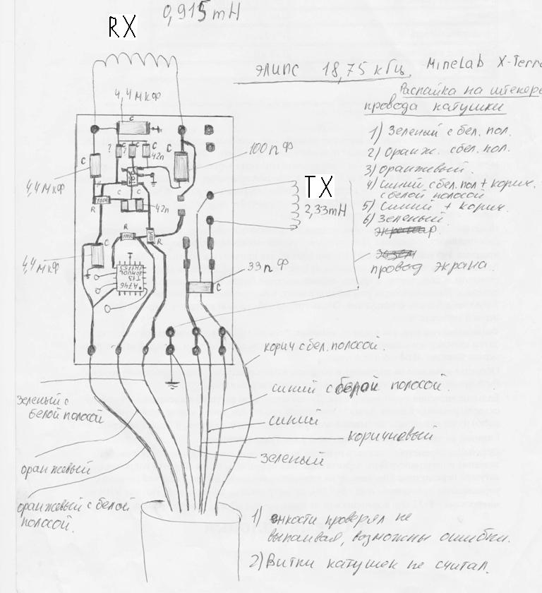

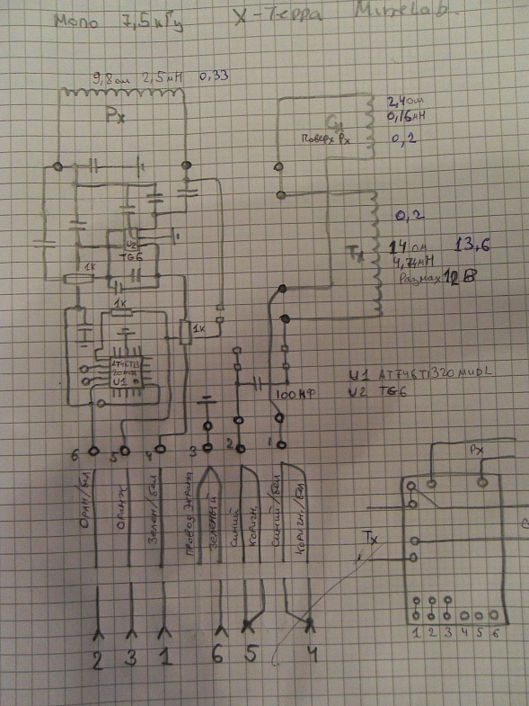

                    Now - I doubt that this is an opamp, divider or some other specialised IC, because then will be too easy to reproduce those super secret coils, where is half of electronics in coil (as greedlab claims) or it is just some simple & cheap but not readable PIC/Atmega?

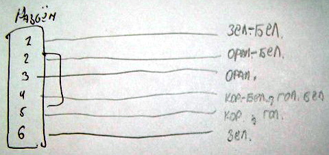

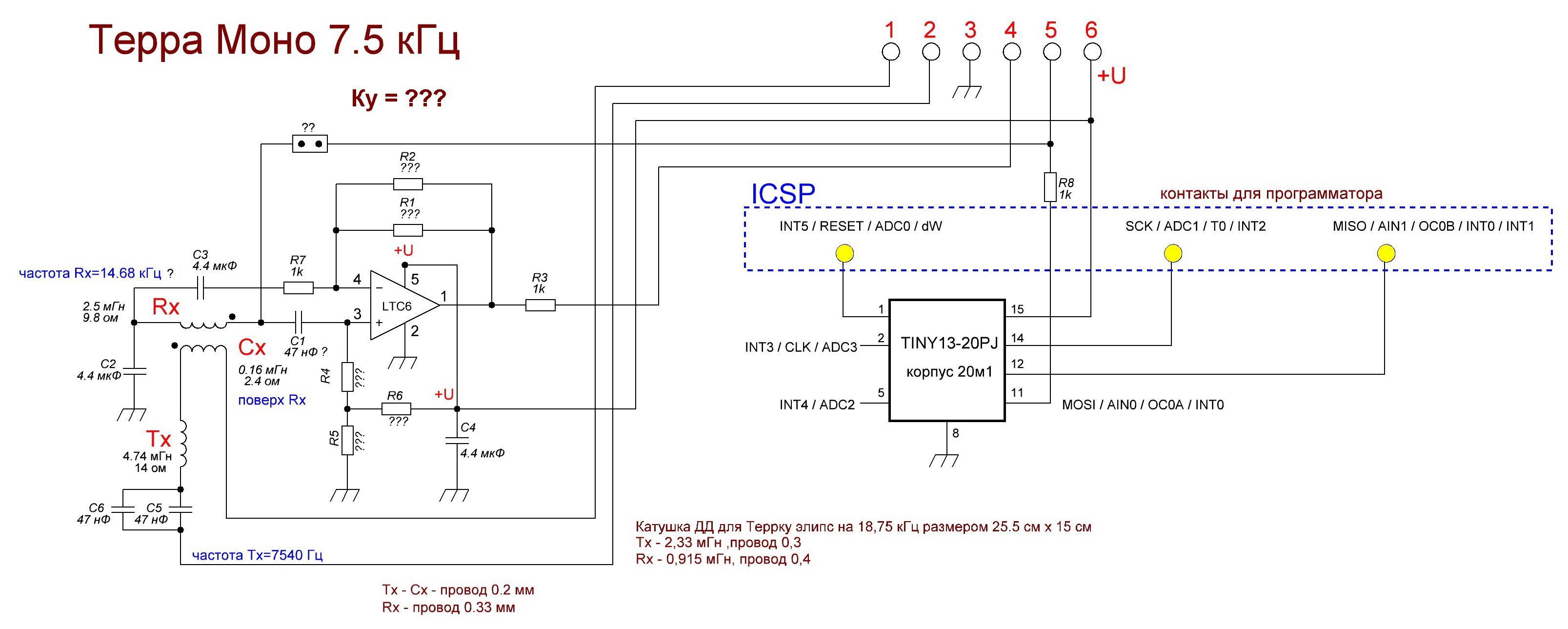

                      russkie rebiatushki did draw a schematic of this secret board. opamp in 5 pin case. chipo at left is a micro. set this board in terra box, do a coil
                      with only preamp and you do not need ML coil never.
                        Do you have a link please? Its hard to beleive that chip is there only to fool people like me

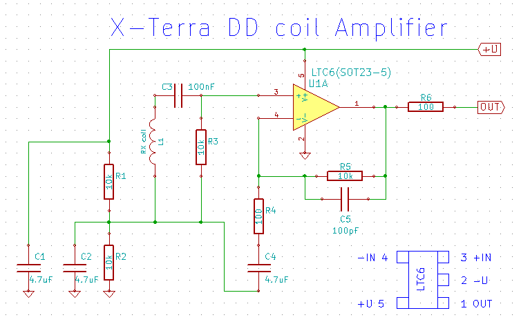

                          That looks like an XTerra board, they have a micro embedded. Sov/Excal do not.
                          Excal is a simple square-wave drive but with a fundamental of 3kHz, so I would expect the critical thing is to keep the TX coil resistance low. There is no resonance cap for TX, and surely not for RX either. Somewhere there is a schematic for the coil PCB.
                            I was thinking of the Sov/Excal coil PCB, there is a schematic floating around.
                            In the Xterra schematic "LTC6" is a top mark and probably is "LTG6", which is an LT6202 and a very appropriate choice for a preamp.
