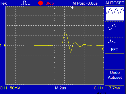

    If the pulse is sent to the transmitter coil, will the shape of the received signal change in a DD coil? According to the test, the spike signal is transmitted through the transmitter coil but the received signal becomes damping I think. Why will it happen?

    If the pulse is sent to the damped transmitter coil, or,,, what you meant?
    the received signal becomes damping I think on damped receive coil, or,,, what you meant?
        [ATTACH]44683[/ATTACH]
        Without knowing what your transmit signal looks like it's difficult to answer. But generally in a PI-IB system the RX signal is a minimal transient and has a tendency to ring unless the RX coil is damped.
