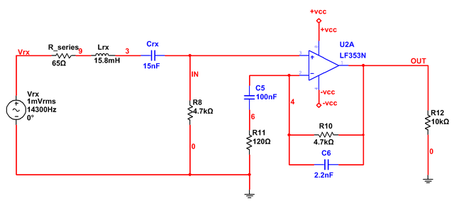

                            For this research, the TESORO Cibola metal detector receiver has been used, which is a series resonant.
                            The simulated circuit as well as an ideal series resonant circuit are shown below.

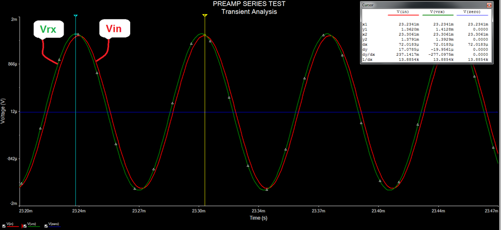

                            Initially, I have shown the Vin signal at the input preamp relative to the Vrx caused by the Rx coil.
                            As you can see, the Vin range is slightly less than Vrx, and the phase is lowered to Vrx.
                            Also, the Vout signal is displayed at the output of the preamp as well as the Vin, and there is a delay between these two signals at 5 °, which is due to the preamp behavior.

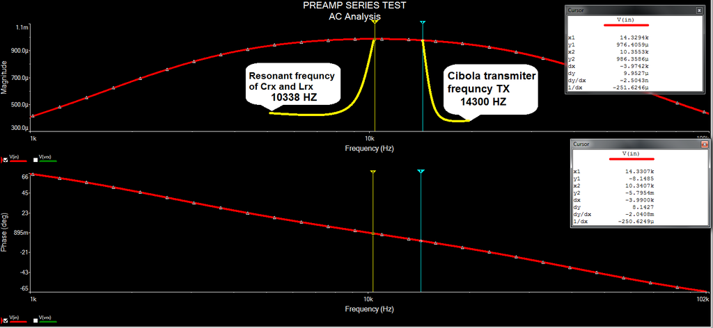

                              Now let's answer the frequency and phase response of the Cibola circuit with the assumption that the transmitter frequency is 14300 HZ and the resonance frequency in the receiver is set to 10338 HZ.
                              Here, the frequency response and phase of the Vin signal are displayed in relation to Vrx and do not respond to the opamp behavior.
                              As you can see, the transmitter frequency is 14300 in Cibola, and in this case the Vin signal is 7 degrees behind the Vrx.
                              But if the sender frequency was 10330 Hz, which is the same frequency of the resonant circuit of the receiver, then the Vin signal to Vrx would not have any phase differences and would cause the maximum possible range to be transmitted to Vin
