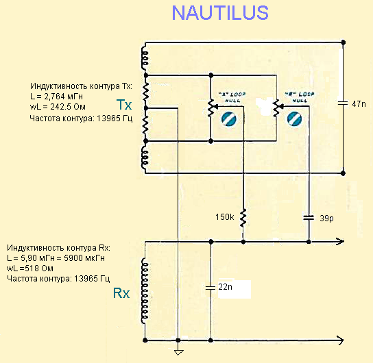

      I too couldn't find accurate technical information on Nautilus coil Rx resonant frequency, until I read the Nautilus patent author Jerry Tyndall.
      You see therein contain details/data on coil, enough to ascertain what Jerry was up to. Then I realized that the Nautilus DMC 2b coil was most likely bifilar design with tx an Rx freq, closer together(somewhere around 14khz). The circuit architecture was very much the standard for motion VLF, so why was the DMC2b winning competition events, and got tremendous success and reputation for deepseeker?
      Four elements, firstly, transistor preamp in coil housing.
      Secondly, balanced coils in full resonance.(bifilar centre tap TX design with dual buck coils)
      Thirdly, a third all metal channel running side by side with motion discrimination, with it own separate audio.
      Fourthly, adjustable tx power.
      The only differences I could find from say the tgs circuit( besides unique side by side all metal channel) were in the phase shifting, and the coupling to the switches(gates)4066.( Normally with series resistor and cap to ground, in the DMC2B it was capacitor in series and resistor to ground)yet another clue for stability.
      Everything else was like silver sabre plus, which ain't a deepseeker by any means!!
      Of course the final big difference was the coils being in closer phase, requiring R and C balance pots to fine tune the null before hunting. This I believe is what closer resonance spread does, it requires very fine balancing to achieve stability.

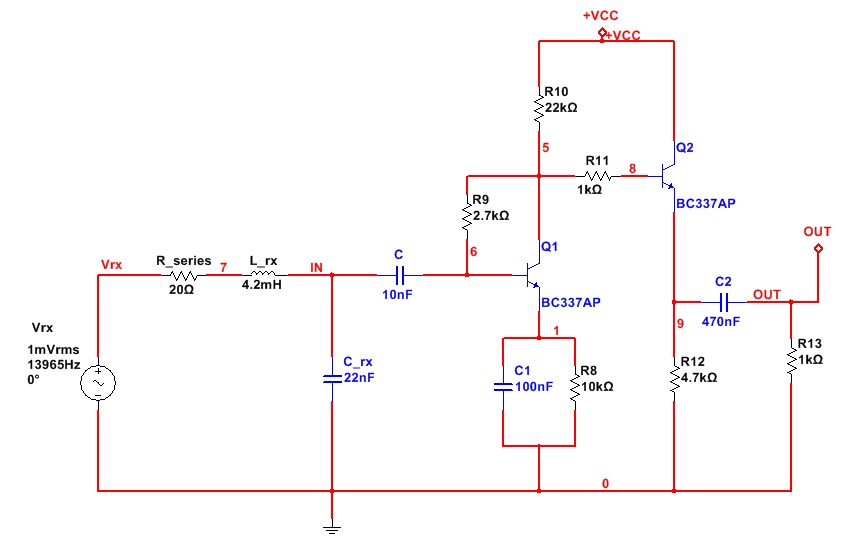

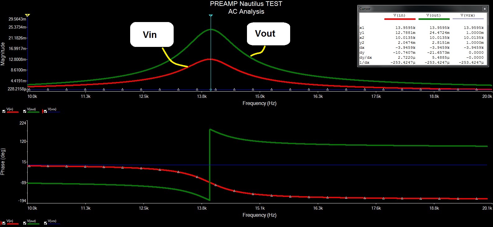

          I was curious to check the frequency response of the Nautilus circuit
          But since the coil inductance is unknown, but the transmitter's only frequency is specific, and it was also said that the receiver's resonant frequency is the same as the transmitter, so I first calculated the amount of INDUCTANCE coil RX and then simulated it.
          Of course I did not know the type of transistor.
ID:	353474Click image for larger version

              • #67
                [ATTACH]45567[/ATTACH][ATTACH]45568[/ATTACH]
                Your tests confirm my logical observations, though I never pursued it. It is precisely what I would have expected.

                    • #70
                      NAUTILUS ТХ и CХ имеют по 4.2 Ом, толщина провода 0.45мм - одна пара хвостов соеденена вместе и кинута на землю, вторая пара на платку в параллель им пленочный кандер неизвестного номинала. РХ имеет сопротивление 26 Ом толщина 0.3 мм, в параллель РХ стоит кандер 22Н. Корпус катушки изнутри промазан графитом и обе половинки корпуса. TX= 4.2 R WIRE 0.45mm CX=4.2 R WIRE 0.45mm RX = 26 R WIRE 0.3mm C_RX=22n Transistori 2N5088 GRAFIT SHILD CASTOTA NAUTILUS F 13965 Hz FAZA TX/RX = 0 GR.
