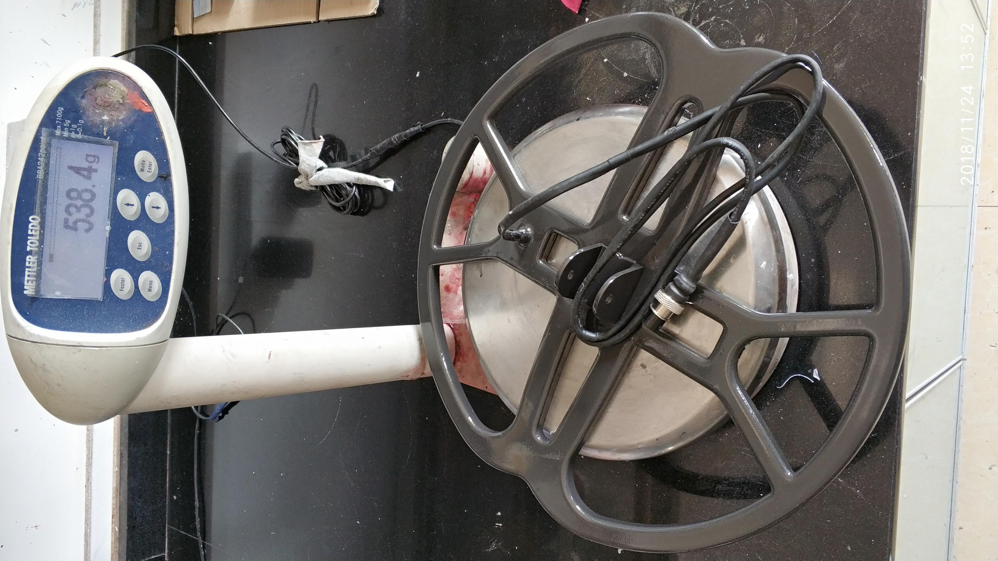

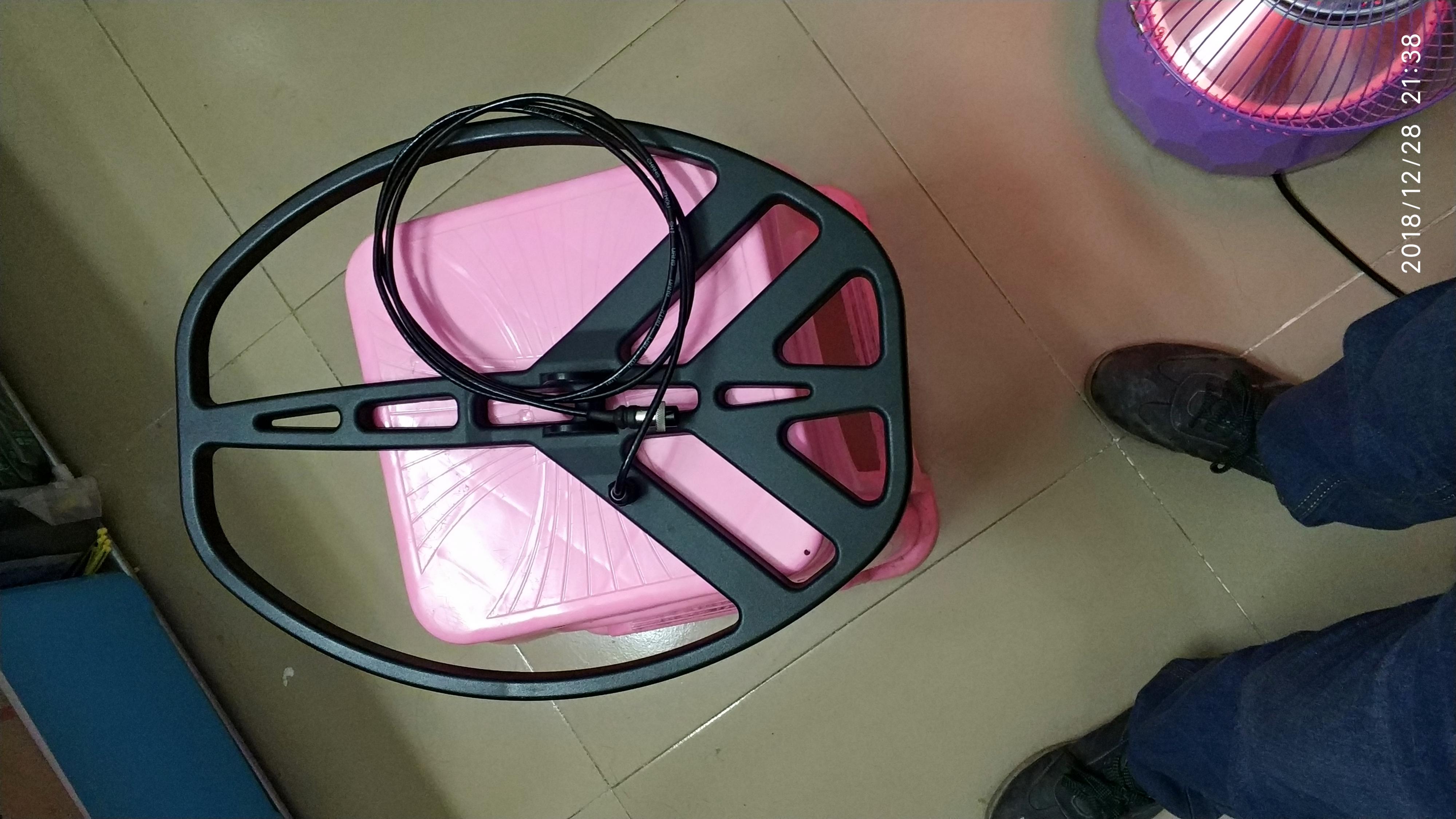

                I made 13-inch and 18-inch DD probes for gpx4500, which works well.

                        Tx=300uh, 0.4-1Ω
                        Rx=450uh, 3-10Ω, parallel 1k resistor
                        The 11-inch single coil is more sensitive than the 13-inch DD coil. It is recommended to use a single coil.
