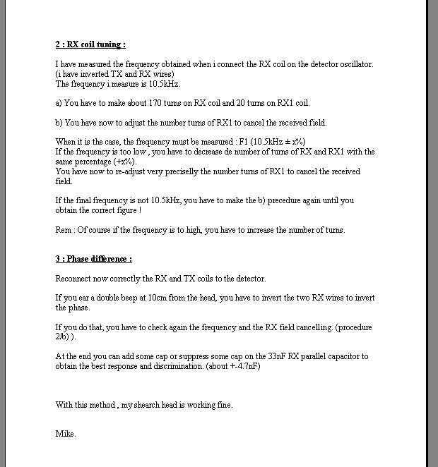

    Hi all,,,Even though I have collected a ton of information from the Forum over the 2+years I've been a member I'm still at a loss with the correct method of wiring and shielding the coils of the IDX, the TGSL and the IGSL DIY Detectors. I really would be grateful and appreciative if any members would have any wiring diagrams of these three detectors that they could possibly post. I've spent all winter trying to learn how to use the DSO 5102P Oscope and how to tune VLF 'DD' Coils and Concentrics but I still don't think I've wired them correctly. I really would appreciate any help with this. Thanks in advance. Regards,,,Marty

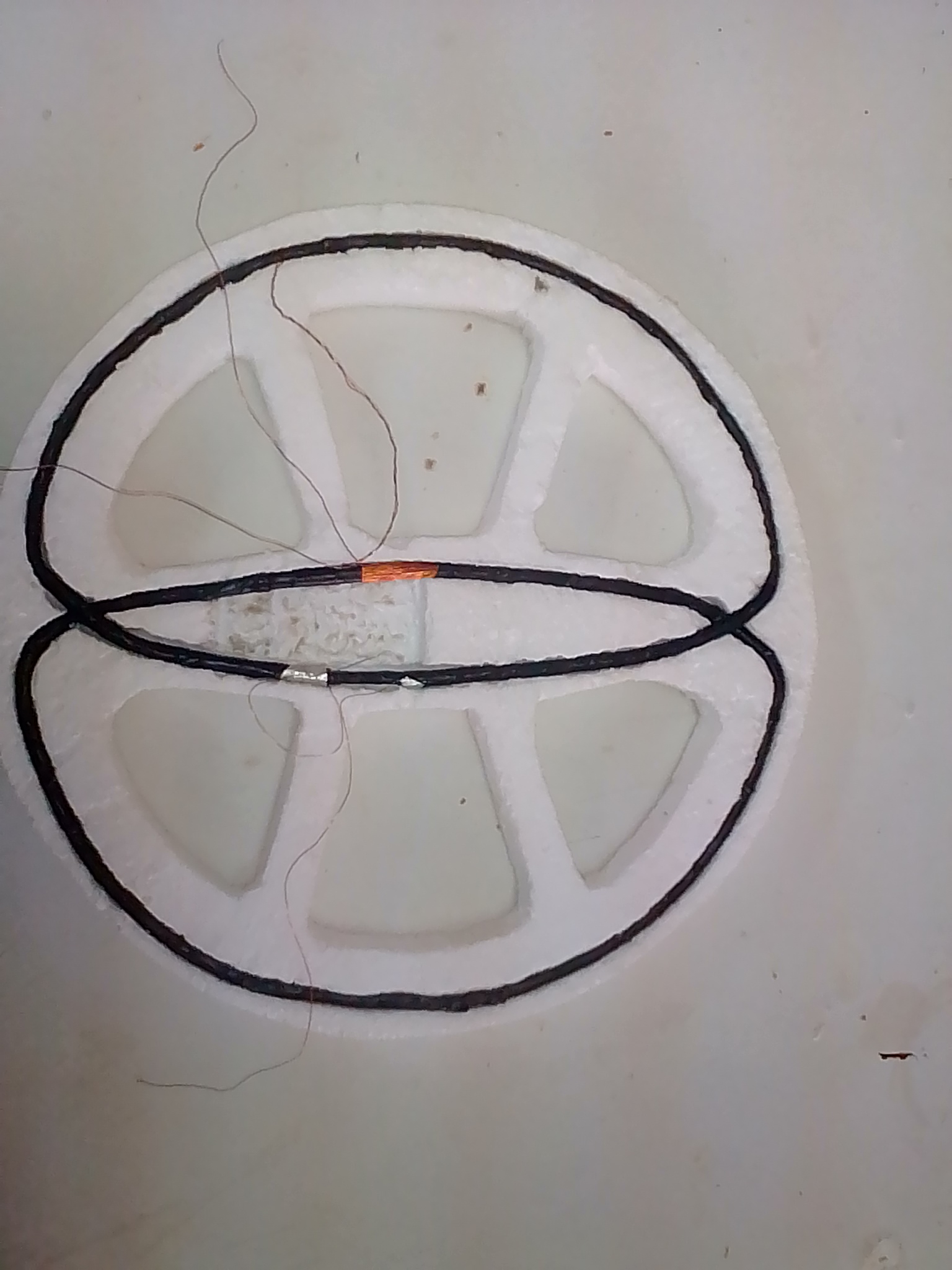

          With DD coils, the trick is to first get the TX coil oscillating at correct frequency(according to which project you are building)
          Then null the RX coil directly(without any capacitor attached), by looking for minimum output amplitude on scope. This is the balanced state between TX and RX. Finally, tune the RX coil according to recommended RX resonant freq. by adding capacitor/ and smaller picofarads capacitor for fine tuning. Thats all. For final precise tuning, gently move RX while observing scope. Remember the TX goes on the right side and is fixed into place, followed by the RX coil on the left side which overlaps on top of the TX coil. If your getting double beeps, just change around wires of RX. End .
          With concentric coils, its a little bit more difficult because of the bucking coil, which is used to cancel out the TX coil and null the RX. So the process can be a little convoluted.
          One thing Iv'e noticed is that once the RX coil is tuned to correct resonant frequency, and the TX coil is at correct oscillating freq., when both are balanced, the correct phase lead/lag falls into place nicely with just very tiny movement/shifting of the RX coil. also with DD, secure the entire TX coil in place(hot glue), but with RX, only secure the circular side, leaving a part of it for manipulation for final tuning(nulling)
          Always use the shape below for DD, it is easier to balance and is much better overall.

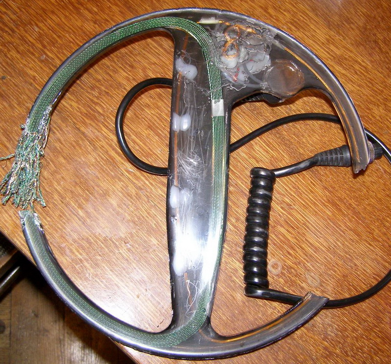

                I have a question for all the coil makers. I am making a Concentric coil for a Minelab P.I. GPX detector.
                My dilemma is, when winding the Bucking Coil, do I join it up to the TX coil, as in some diagrams I have seen on the forum? Or can it be left as unconnected winding's around the RX coil?
                Does the field from the TX coil, create an inductive reverse field in an unconnected bucking coil winding?

                  bucking coil doing around RX coil and connected IN-SERIALLY ANTI-PHASELY to TX coil
