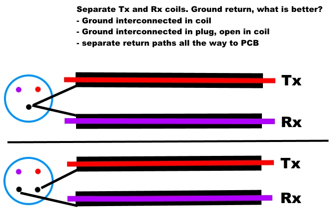

    I am not even sure if I am asking the right question, but here it is anyway:
    Setup is separate Tx & Rx coils in a PI - MPP Rev E in this case.
    Does it matter how the return paths are interconnected or not?
    For me that would make at least the difference of having to get either 3 or 4 pronged plugs/sockets.
    What are your experiences with this?
    Nearly forgot, what is more prone to ground loops?
    Hope the drawing conveys what I mean:

    I'll take a stab at this.
    It is important to provide separate paths to and from the two coils.
    Best if all the way back to the PCB.
    Connecting together at the connector, which is close to the PCB is probably fine.
    Do not run three wires to the coils (in coil housing). This would put TX current on the RX path.
    I'm guessing the coil is connected of the right and circuit enclosure is on the left.
    I do use 4 pin connector and run twisted pair wires on both TX & RX from coil to PCB. This has been working fine. The cable from the enclosure connector to the coils is CAT-5 so no shield, just twisted pairs. Inside the enclosure I run two pairs fo twisted wire (stripped out of CAT-5) from the connector to the PCB.
    A 4 pin connector would make it a little easier to solder damping resistors to the coil cable connector. One resistor for the TX and one for the RX.
    These are in parallel to a larger value damping resistor on the PCB. This way each coil built can be damped as needed and then allows simple coil swapping.
    Do you have 3-pin connector and need to buy 4-pin or do you need to buy either connector?
    If the later then buy 4-pin since this allows options.

          Thank You waltr and green!
          I have yet to order plugs & sockets and will go for the 5 prong ones.
          That will leave all options open without having to order other ones again sometime.

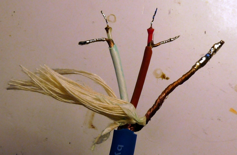

          This is the type of cable I would use for a separate Rx Tx configuration.
          Wondering how waterproof it really is. The filling is cotton. Comments?

          I could use two twisted pairs as you say, but there is a lot of humidity & salty water around.
          At the moment I would not know how to get a good seal on those twisted pairs running to the coil.

            I as said, I use CAT-5 cable which has 4 twisted pairs.
            The outer 'plastic' jacket is water proof so would be like the cable you have is this regard.
            You just need to water proof the jacket to the coil shell.

                The blue S-Video cable I had used worked for a while. Saltwater has seeped into it.
                I have now tested many s-video cables which do NOT contain foil or any semi-conductive layers.
                Apart from being skimpy on the overall conductor thickness, the capacitance was very surprising to me.
                I measured the resonant frequency via the "parallel tuned circuit" oscillator & oscilloscope.
                Pinpointer coil measured for itself and then with connected s-video cable.
                Capacitor values used for testing in the tuned circuit: 0, 75pF, 150pF & 1000pF.
                The values were horrible (PP and measuring wire capacity is already deducted):
                The best one had 105pF/m
                Most had the range 125-145pF/m
                The worst one was a special studio cable with a whopping 185pF/m
                So no more s-video cables for me any more.
                I am looking into Mogami cables for outside use at the moment, they have clear technical data sheets IMO, Not just some Audiophile MumboJumbo.
                I will be grabbing some samples when travelling in a few weeks.
                Just read in one of these threads about PUR cables for seawater use. I will also be looking into that.

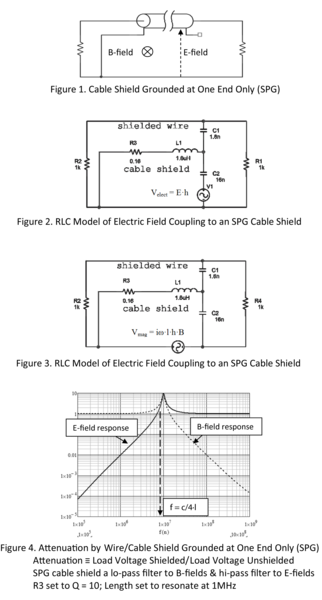

                        So, I've continued going down the rabbit hole of grounding/shielding.
                        Found the following, am not sure it's fully applicable to our faraday-ish application of shielding of coil / pcb-housing
                        Comments, Insights ?
                        https://www.emcstandards.co.uk/cable...t-one-end-only
                        Here the copied Text, so it sticks here in the forum:
                        Cable Shield Grounded At One End Only
                        Author: Larry West
                        Low Frequency RLC Model
                        Contributed by Larry West: ([email protected])
                        The myths that (1) a cable shield grounded at one end only (single point gnd, SPG) is really a shield and (2) that a shield grounded at both ends creates an unwanted ground loop have been asinine EE folklore for decades. Both are dead wrong. An SPG cable shield is a hi-pass filter to magnetic fields and a lo-pass filter to electric fields with amplification at the break frequency. Alleged ground loops exist before shields are considered. A properly grounded shield simply does its job -
                        attenuate. Cable shielding and ground loops must be disassociated. People with no knowledge are fictionalizing a problem they don?t understand. Ground potential differences must be attacked with proper isolation techniques not wrongheaded shielding. ?Grounding? a cable shield is a misnomer; cable shields should be ?bonded? to the enclosures their cables arefastened to.
                        A cable shield grounded at one end only (single point ground, SPG) is depicted in Figure 1. Alsoshown isan electric field perpendicular to the cable and a magnetic field perpendicular to the plane of thecable and its image in a ground plane (both for maximum coupling). The figure shows a coaxialcable however it is intended to represent any cable with any number of shielded conductors.
                        Figure 2 is a simple RLC circuit model of the SPG shield coupled to an electric field, E. There are four parameters associated with this coupling model, the shield to groundplane capacitance, C2, the shield to shielded wire capacitance, C1, the shield inductance, L1, and the shield resistance, R3. For the purposes of this exercise, the parameters have been chosen to be representative of a 15m long cable that has a quarter wave resonance at 1MHz. Both loads are 1kΩ. The electric field couples to the line through the line to ground capacitance as a Thevenin equivalent source, VOC = E?h, where h is the height of the line above the groundplane. Other parameters like wire resistance have been suppressed because they are not part of the shield RLC model and less than the loads. The shield resistance, R3, has been increased so that the resonant Q-factor is Q ≈ 10, the most usually seen. It is difficult to model actual losses analytically therefore the Q-factor has been used to arrive at a shield resistance.
                        Figure 3 is the same RLC model of an SPG shield coupled to a magnetic field, B, with the voltage, V OC = iω?l?h?B, where l is the length of the shield.
                        Figure 4 is the combined results of the two coupling models. The effect of the SPG shield is exactly what the RLC model suggests; that is, the SPG shield is a low pass filter for magnetic fields and a high pass filter to electric fields. The filters? break points are both at the frequency corresponding to the shield length being one quarter wavelength. The SPG shield is therefore not a shield at all. Shielding effects are orders of magnitude below these curves. The last point is that the
                        SPG resonates so that the induced signal is amplified, not attenuated, at the shield?s resonant frequency. This model is a low frequency model however all of the relevant parameters are included.
                        The multitude of app notes and articles on this subject that recommend grounding the shield at one end only misrepresent the physics of shielding and falsely ascribe a ground loop to the shield where the circuit itself was part of the original ground loop. Cable shielding and ground loops must be disassociated. Grounding the shield at both ends attenuates the coupling to the shielded wires by approximately the ratio of load current to shield current, SA ≈ Iload/Ishield ≈ ZT?l/2?Zload,
                        where ZT is the shield transfer impedance, l is the length, and Zload is the load resistance of both loads. As an example, a cable shield with a DC resistance (and low frequency transfer impedance, ZT?l = Rdc) of 1Ω and load resistances of 1kΩ will have a low frequency shield attenuation of approximately 5?10-4 or 66dB.
                        The shields should be ?bonded? to the boxes at the ends of their respective cables, not earth ground, building ground, or anything else. Military standards like Mil-Std-188-124B and the FAA get it right. It?s time for everyone else to also.
