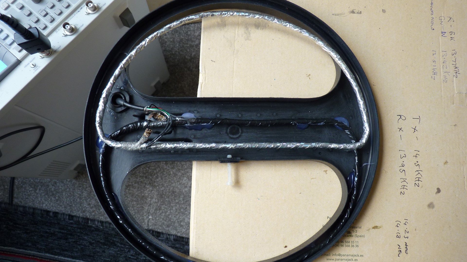

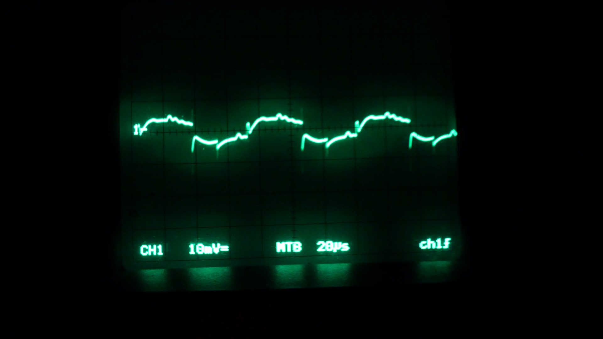

ID:	353771 Finally finished the TGSL coils (for the second time!) they are now 'spot on' frequency (14.5KHz TX & 13.95KHz Rx) when nulling, the coils are in the position shown in the photo, i.e. the RX coil wont fit the shell! I may be able to bend the coil to fit (as I use epoxy, not superglue for the windings) but that will alter the inductance and frequency!.....Help please
            The waveform is from pin 5 U103, balance pot at centre, it moves the zero from top to bottom of display (O.K?)

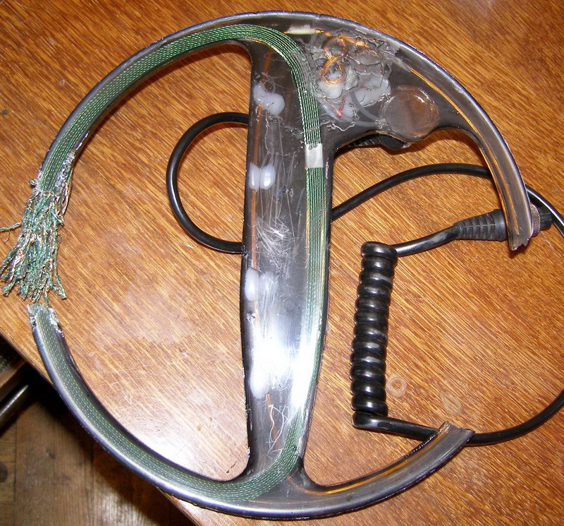

              you do not want to understand that we are not recommended to use the foil.
              with right shielding you can do a splitted out small winding and BY IT to do balance.
              look pic

              your problem people you do not want to read the forum. you just do what you want to do. in result you get the garbage.
                I've been reading this forum for weeks with posts going back YEARS. Using Mylar as recommended here. It's actually working quite well before potting!
                  Very good progress. Solution for your problem is easy.
                  Just bend and shape the Rx coil to fit in the coil shell, nevermind the inductance changing. You can do rough balance by connecting multimeter or scope directly to Rx coil. Do this to make sure you have enough room to shift the coil side to side, for when you are doing final balance.
                  Once you have done this, just measure the new inductance and use resonance calculator to figure out what value capacitance to use for 16.1khz resonant frequency of Rx. Now you can put new value capacitance in parallel with Rx. Remember there is 15nF cap already on PCB, you will need to add or subtract from its value in order to get the value of what you calculated.
                  Once that is done, you can go ahead and balance the coils.

                    Focus on balancing the coil and learning how to accomplish this black art. This is learning process of most difficult part of building a metal detector. Your knowledge and skills will improve. Soon you will be making search coils with eyes closed.

                      There's better D shape coil( in my opinion) more widely used with commercial coils. That one is much better shape and lends itself more readily for fitting the coil shell and for balancing. Performance is the same. Notice in the pic above how the coil shape is much gentler with softer curves. This is best shape to follow. But keep your sharp d shape. Next coil you make you can try softer shape.
                      With your Rx coil, you have to shorten the corners so the D becomes deeper in order to have enough overlap of tx to get it to null point. Nevermind the small change in the inductance. Just get it to fit and to be able to null.Follow above.
                        Factory made coils are wound on machines under tight qc, the inductance is bang on every time, they fit in coil housing perfectly every time. Shield done on coil shell perfect every time.
                        They balance perfect every time. Making coil on jig at home is completely different ball game.
                        There is going to be a lot of tweaking until you get the hang of it.

                            BTW.... I am reading coil frequencies at CLK pin 1 U100.....is that correct, It's higher if I read across the coil?
                              Read it from wherever you like, from coil, or from connector, or from oscillator, so long as it says 14.5khz or thereabouts. I f you read 14.6 then set Rx resonant frequency to 16.2, get it? You should maintain the "off resonance" spread between tx and Rx.
                              It is easier to lock down the tx frequency(fix firmly in coil shell), and then play with the Rx resonance and nulling. You will see what I mean.
