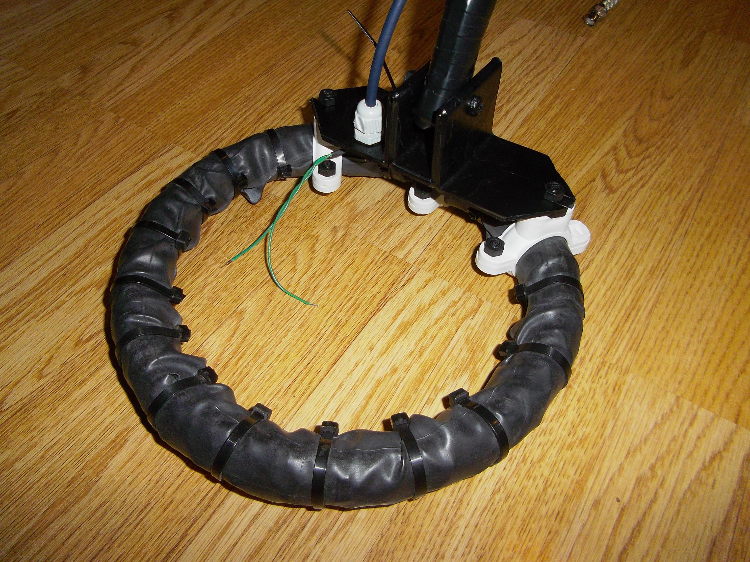

      Won't the Aluminium tape that you taped the pipe ends with act as a target? Regards, Marty
      The aluminium tape was only there to keep the sand in the pipe during bending to prevent pipe collapse. I removed the tape and poured out the sand afterwards (well, most of it, I can still hear some grains in there if I shake the coil violently ). I didn't mention this step to keep the text shorter. Afterwards the pipe ends were connected with a small section of 14 mm round wooden stick press fit inside the pipe and further secured with toothpicks through the holes.

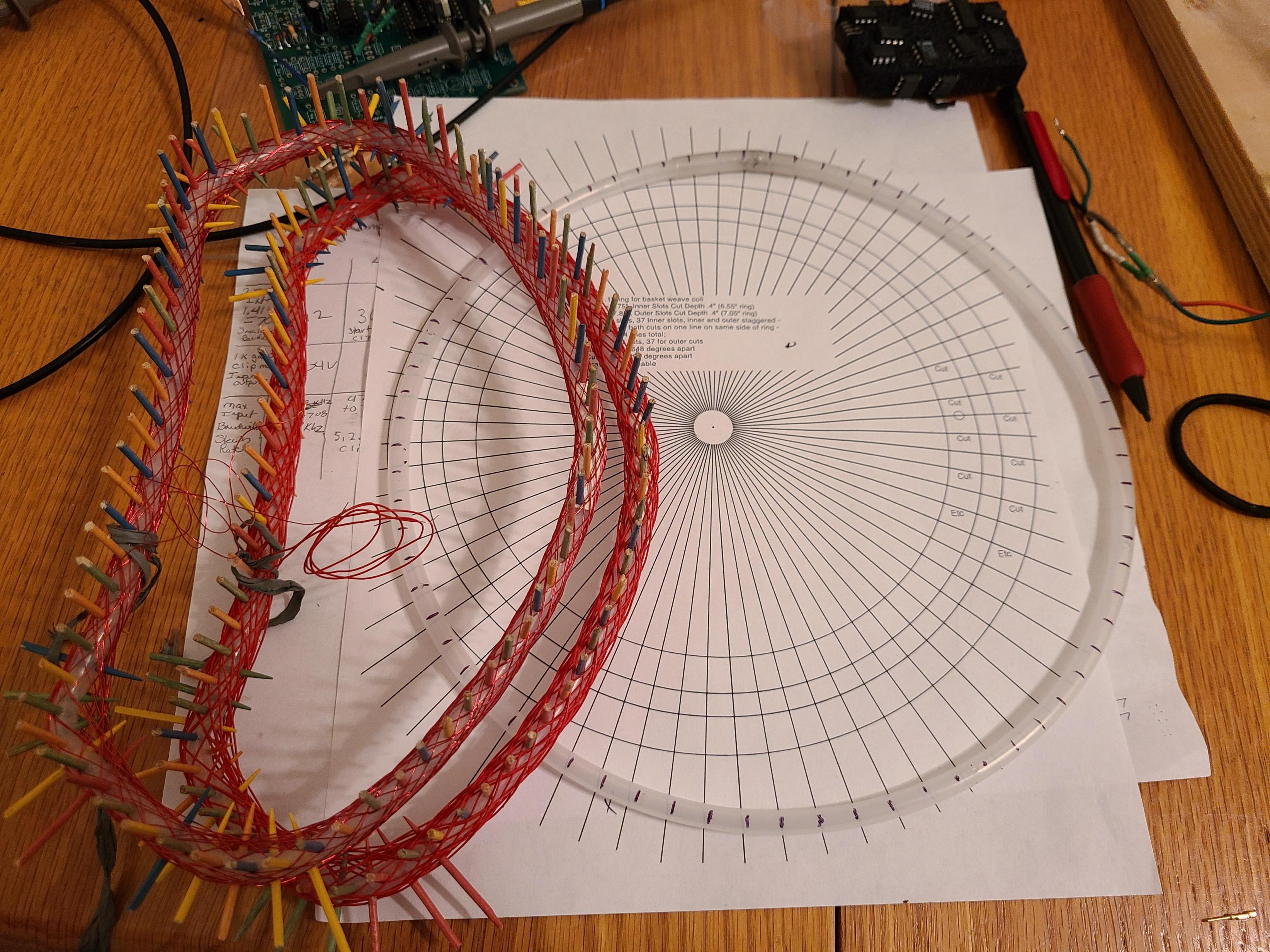

                      Hi Cazavor,
                      The form I,m using is a poly tubing the type you would get for a refrigerator water line.
                      It actually mics out to 6.5 MM.
                      Its semi transparent so you can just lay your form over the template and mark the drill holes.
                      I join the tubing by melting and sticking together then shave off the high spots and shrink wrap the joint.
                      This material can be shaped however you want after you mark the form.
                      Here is a pic of the form without holes and of some DD coils as a example.
                      As for capacitance I was hoping this from would reduce it a little over the standard 3dss coils.
                      Thinking that the two forms even though the wire slots are closer there is less wire crossover.
                      On the standard form all the wires stack tightly into slots on top of each other.
                      On the round form the wires curve gracefully around and no what ill call pinch points .
                      Thinking all in all this form is reducing required wire to get the inductance we want causing the extra benefits of less resistance and capacitance. I hope, I could be wrong .

                        godigit1 thanks for the info, you are a true 3dss fan, even making DD coils from it! I too like how the round forms avoids pinch points.
                        surfdetector, I'll be using pipe clamps together with a U shaped form I bent from ABS sheet with heat gun. Everything secured by nylon bolts. Doesn't look that good but hopefully will get the job done for now:
                          [ATTACH]50826[/ATTACH]
                          I like the idea rather ingenious.

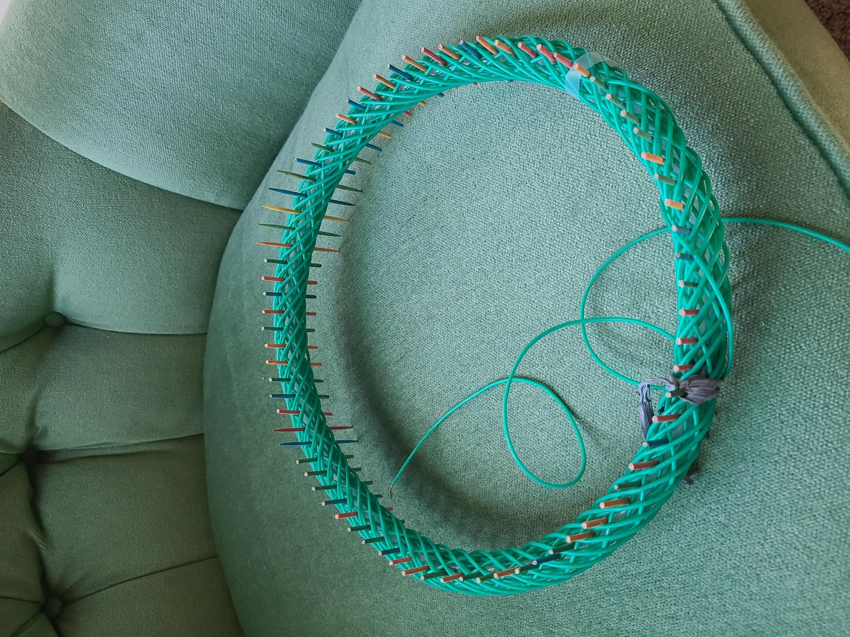

                            Hi Cazavor,
                            I finished winding the coil, I'm not totally sure of the inductance, I'm having a problem with my inductance meter the switch is wearing out but it looks like 270uH.
                            I went 30 wraps, by the calculator I should have had 380uH. I switched the wrap up a little this time. I went 5 switched sides same form 5 then back one slot and kept the same direction for 5 wraps then repeated. you can see there is still plenty wire spacing about 3 to 4 wire widths almost 4mm .
                            Weird about the inductance's we have yours seems closer to calculated.
Name:	3dss round form.jpg
                            Its a 9 inch form 26awg 30 strand silicon insulated wire 600v.
                            finished diameter 3/4 inch about 18mm.
                            270uh?
                            2.3 ohm
                            Srf tested by two methods 1.563Mhz.
                            Q At 14 cycles =70
                            Capacitance=38.4pf
                            I too like the way you did your clevas, I had to blow it up to see you had folded it.
                            How did you get the folds to line up so perfectly?
                            Have you had a chance to fire up your coil?
                            Be Well

                                Well done with the coil. Looks very good and SRF is also way up there. Silicone wire has a lower dielectric constant than PVC, which may be one of the factors. My wrap ended up 25-27 mm outer diameter.
                                If you're using a regular coil calculator then I think it makes sense for 3DSS wrap to have a lower inductance for the same amount of turns, as the wires are spaced further apart and are not completely aligned with each other, cancelling some of the magnetic flux. 270 uH is likely correct, I got a similar value when I measured 30 turns of my coil during winding.
                                For the clevis I clamped the plastic sheet between a piece of wood and a metal bar with two screws and folded it around the edges as necessary. Its not that perfect either, one half is a good few mm higher than the other. It is also easy to overdo it with the heat when working with ABS, I charred one spot slightly. The plastic sheet is cut from a license plate holder.
