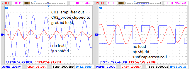

                    Hi Polymer, Wondering if you could do an experiment for me. Connect scope probe to ground lead to make a loop. Set scope amplitude to maybe 5mV/div. Lay scope probe on one of your coils(thin insulation). Position test coil near operating PI coil and read resonant frequency(SRF). Connect a capacitor across coil, something from 10 to 100nf(measure capacitance with a multimeter if you have one before connecting). Position test coil near operating coil and read resonant frequency. Calculate inductance. Repeat test with thick insulation coil.
                      Sooner done than asked
                      Grabbed my MPP E and excited the the blue and yellow coil with it. Thanks for the easy-to-follow description.
                      Amazing ... I get the same results with your method, within reason - with 10nf & 100nF - capacitors too.
                        This confirms the method I used prior. Good to know.
                        Anything within a few percent is great without having to get extra gear.
