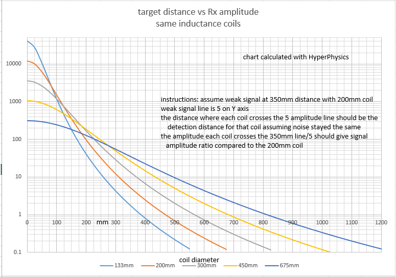

    Could someone care to elaborate for us uneducated fools this statement: "Double the coil size reduces the signal by 1/8", and let`s say it`s for a pulse induction detector and were talking about going from a 20in to 40in coil.

    The quote is wrong.
    Doubling the coil size reduces the sensitivity to one eighth. Also, reducing the target size by a half reduces the sensitivity to one eighth.

          Chart I posted awhile back. Each coil is 1.5 times the next smaller, 1.5 cubed=3.375. Signal strength for the larger coil should be 3.375 times the next smaller. Close at detection distances greater than 2 times the coil diameter. At shorter detection distances less increase and like Koala replied the smaller coil has a higher signal at short detection distances.
