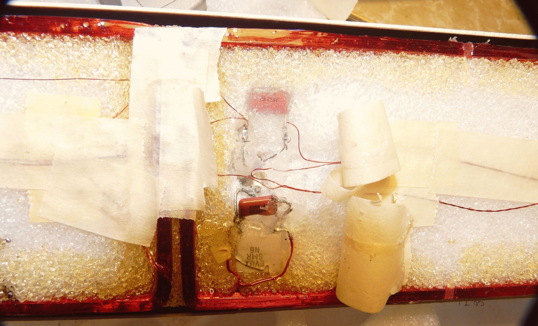

    My bigfoot coil does not work anymore.
    I would like to bounce my ideas of going about a repair here, maybe someone has better ideas.
    Have cut the cable leaving 4 inches for measuring and removed the pigtail. Click image for larger version

    The main defect is that of an open circuit on the TX line, BUT - when carefully moving the TX coax wire I can get the following three states:
    1.) Open circuit
    2.) Short circuit at 0.2 Ohms
    3.) Nominal TX coil resistance of 1.6 Ohms

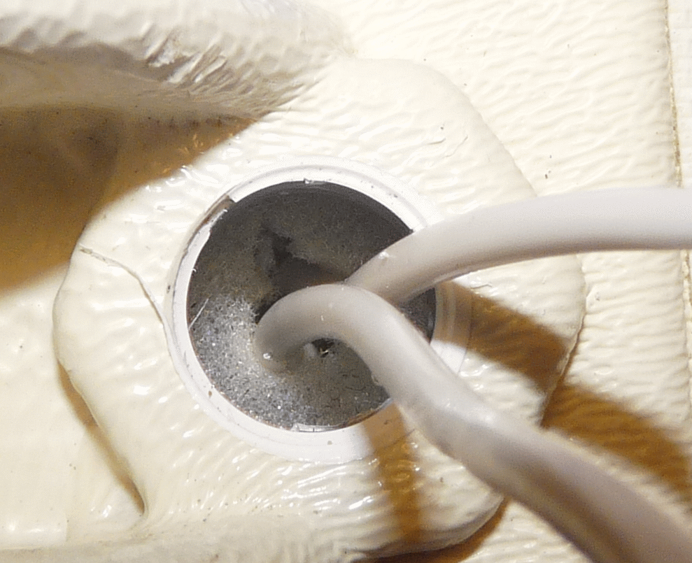

    I have looked at some pictures of the bigfoot inside from the internet and suspect the problem lies within there.
Name:	Bigfoot wire entrance.gif
    There are some bare wires to be seen and they look like they have only been taped down.
    Maybe the tape glue has become old and "unstuck" itself, giving the opportunity for movement causing short circuits and such.
    The open circuit scenario maybe a "gone bad" loose connection solder joint.
    I believe the bigfoot housing is made of ABS. Is this correct?
    Opening the coil shell only seems viable with cutting, since it appears to have been solvent welded around the sides.
    My best idea so far would be to very carefully cut the coil housing at the bottom on three sides with a width of say 4 Inches where
    these bare wires are located. The fourth side I would heat so I could bent it open like a flap.
    Assuming I hit the right spot I could see whats going on and maybe just have to resolder a wire without moving the wires around.
    Maybe only a re-taping is necessary.
    Once I have managed that I could re-heat the flap, close it and re-weld the 3 open seams.
    Any better ideas, hints, tips out there before I begin?

    The Bigfoot is easy to open. The welded seam is an overlap and you can run a utility knife into the seam to split the whole thing apart.
    It could be that something inside has come loose, more likely that the coax has broken and needs resoldering. Since you've cut the cable, you'll have to replace it anyway. The cable is a standard White's cable, 2 internal coax with no overall shield. I don't recall a cable with the extra shield. You might be able to contact White's and get a new cable, or a used one. They throw away a lot of used ones.
      Thank you so much Carl! I am very glad I asked.
      It really was very easy to split the coil housing open.
      My coil ist working again - better than before.
      I have re-used the old cable, it's a tad short, but workable for now.

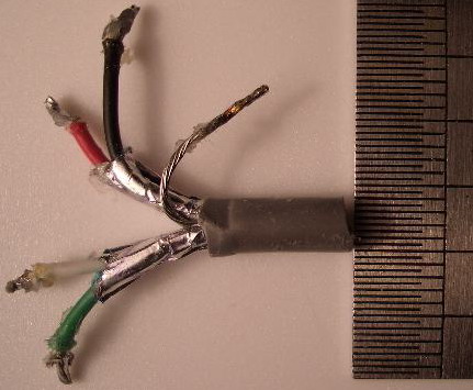

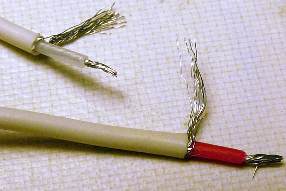

      Ah yes, the extra shielding: I read somewhere that the "outside" cable shielding was causing problems on the bigfoot over time.
      Here is one of the pictures that came with it: Click image for larger version
      Hmmm, I am wondering - truth, partial truth or bollocks ...
        I live in Europe, so I am not sure if I could source a longer one with White's in Scotland as compared to White's USA. Found none on their website.
        It wouldn't be on their web site, you'll need to call and ask for the Service Dept. They should have cables since they make their own coils.
        OK, I remember now. Yes, the foil shield is very poor quality and causes noise as it flexes.
          Foil shielding is ok for cables that don't get moved about much (e.g. inside equipment) but outside in the real world it breaks up and causes intermittent problems. Best avoided.

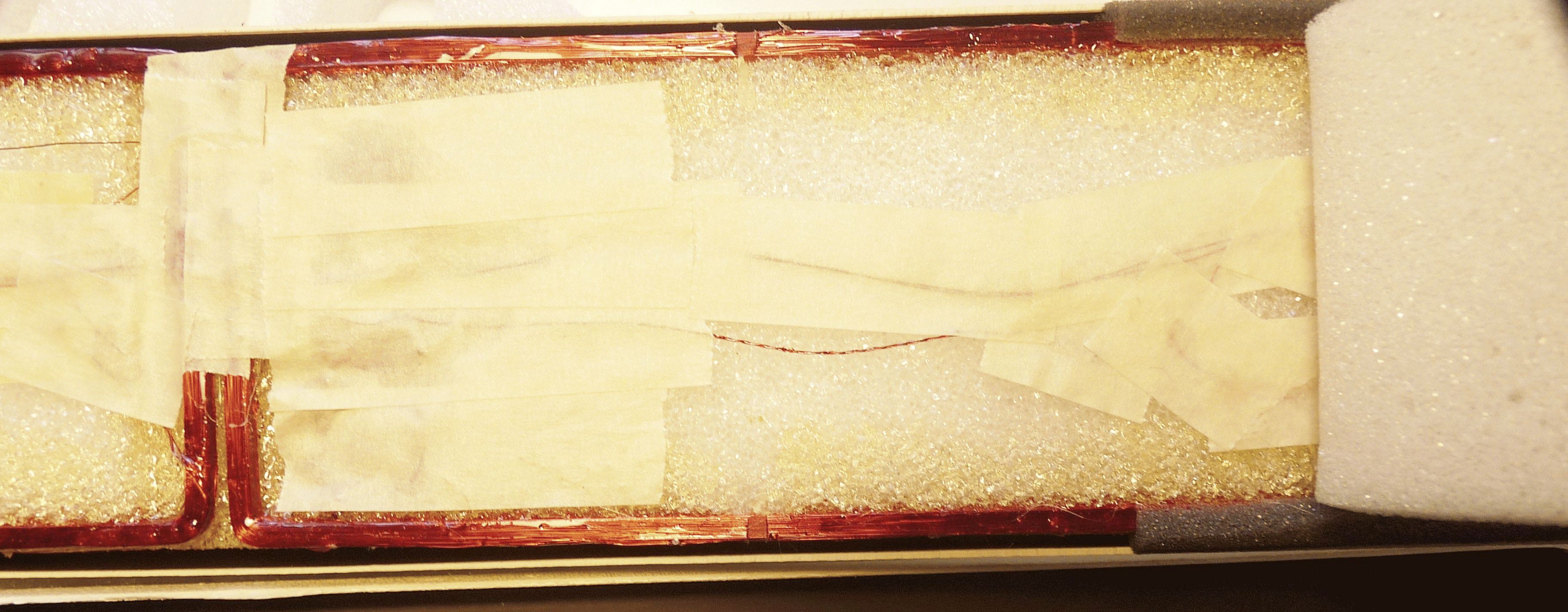

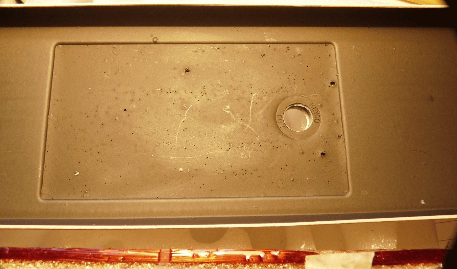

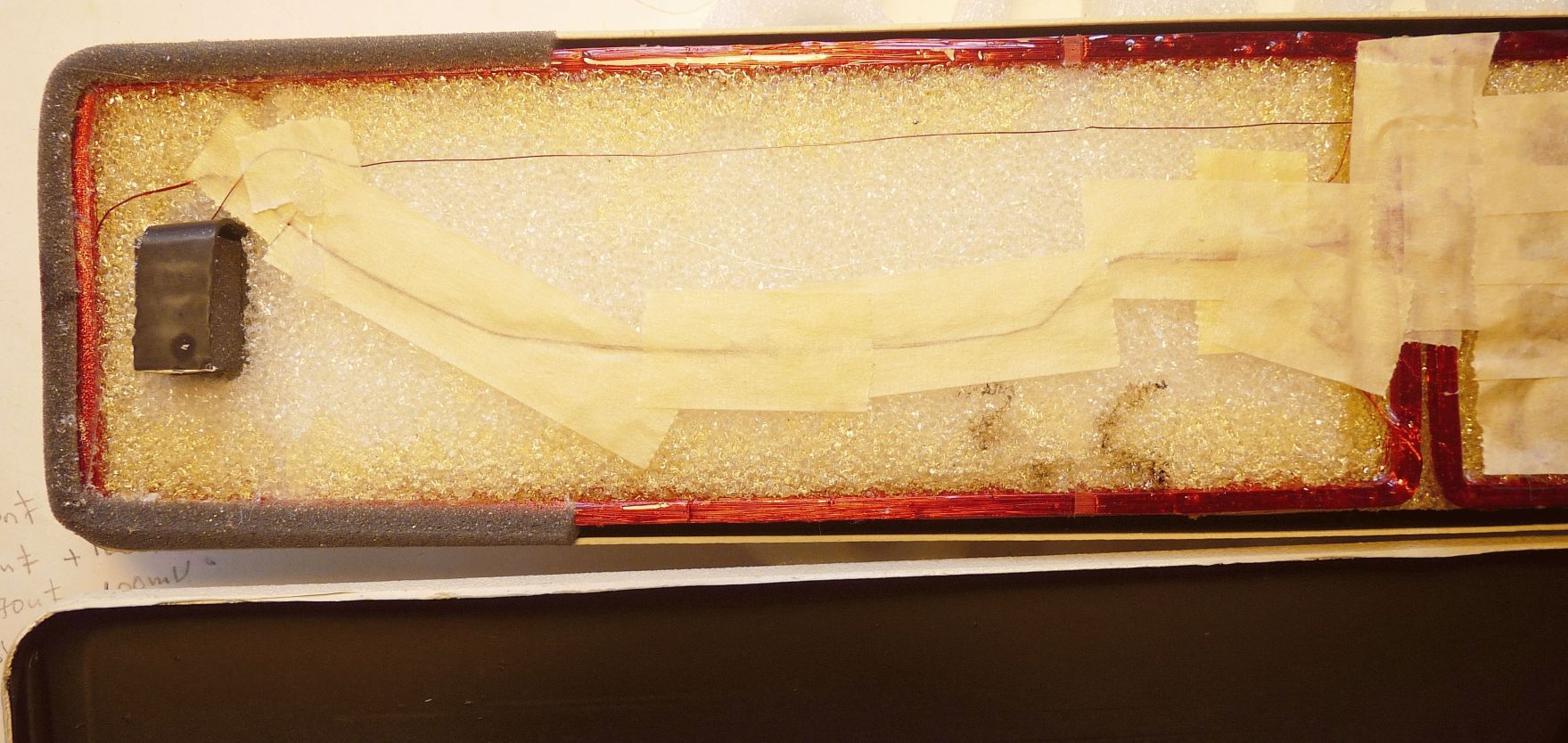

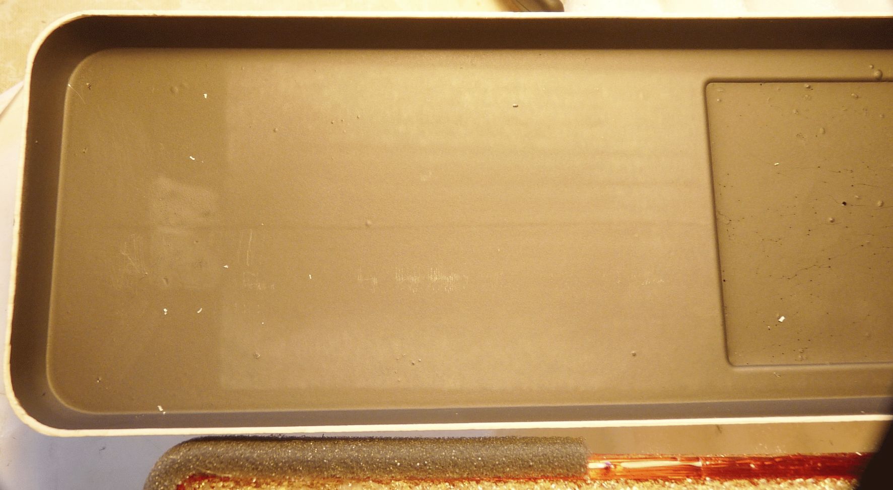

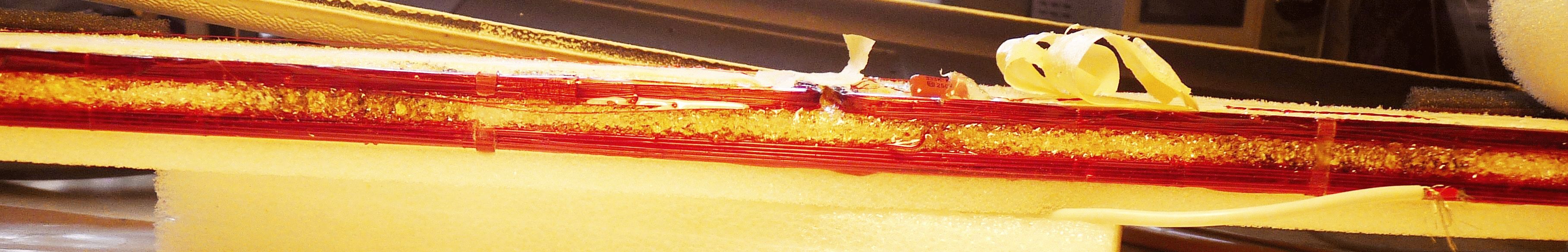

                        The freshly opened bigfoot:
Name:	BF_just opened_01_Lores.jpg
ID:	354405 Click image for larger version
Name:	BF_just opened_02_Lores.jpg
ID:	354406 Click image for larger version
Name:	BF_just opened_03_Lores.jpg

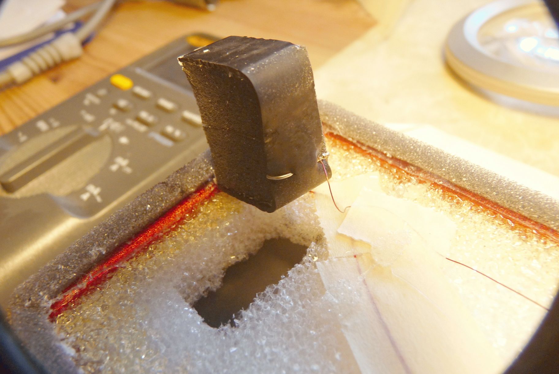

                        Center from the side and 45 degrees - note the singular hanging coil windings on the left side. The are glued/epoxied like the others, they do not flop around.
ID:	354408 Click image for larger version

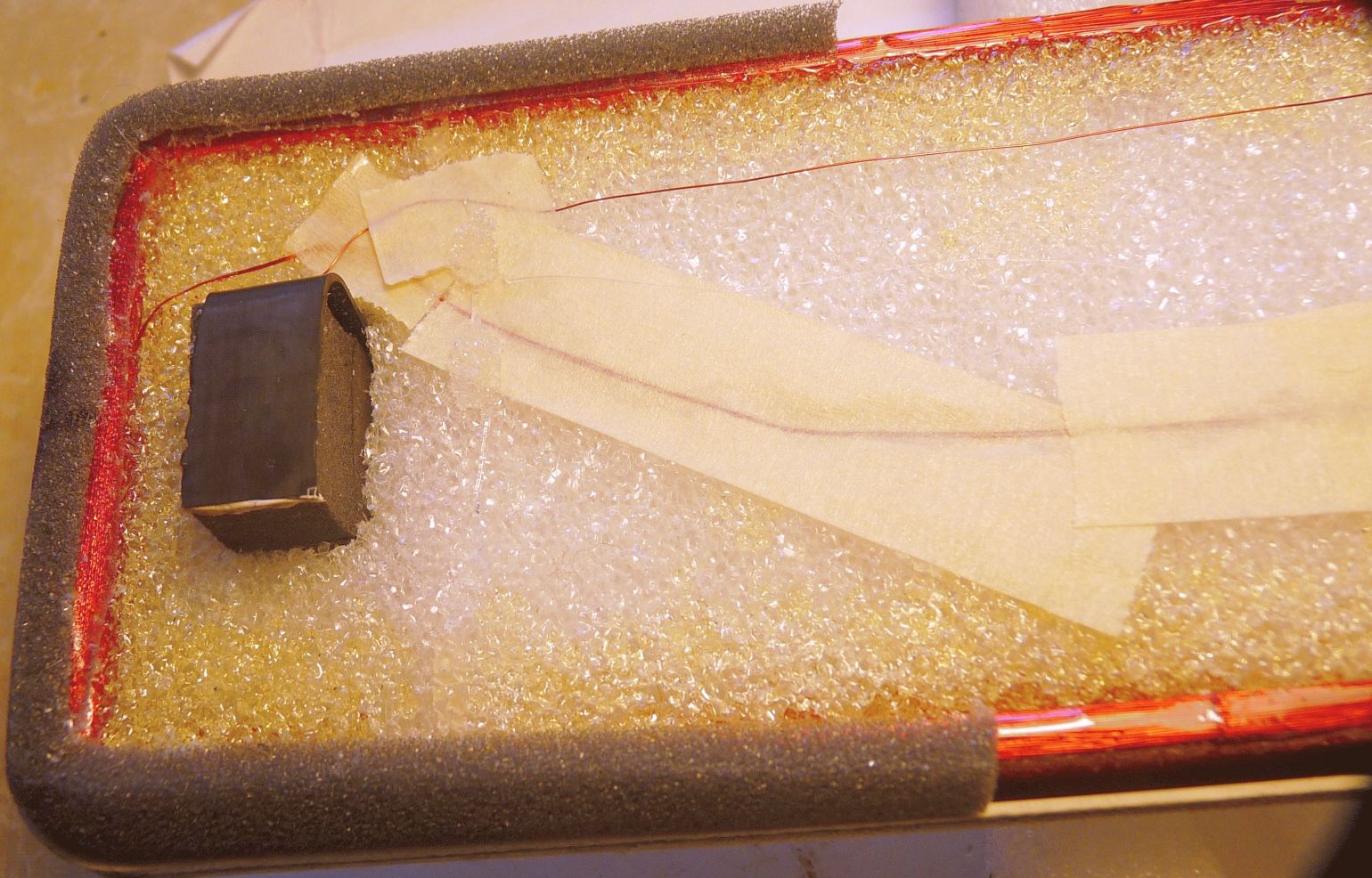

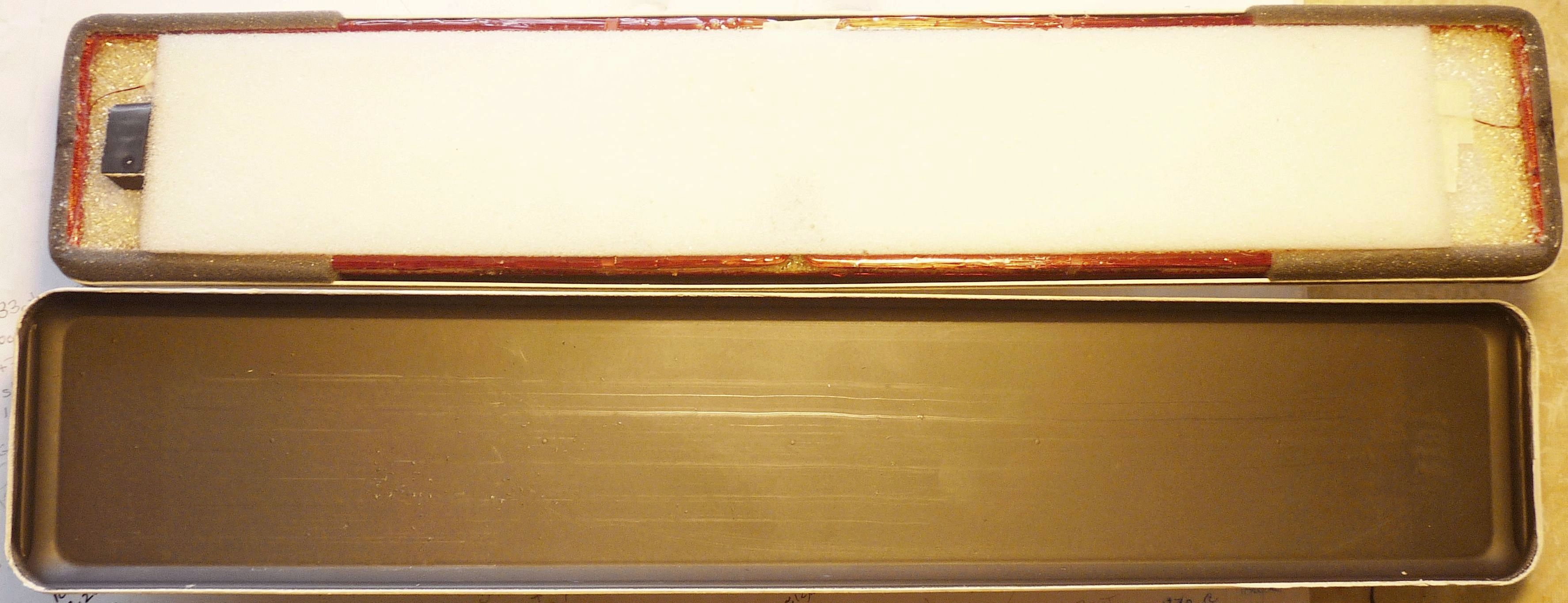

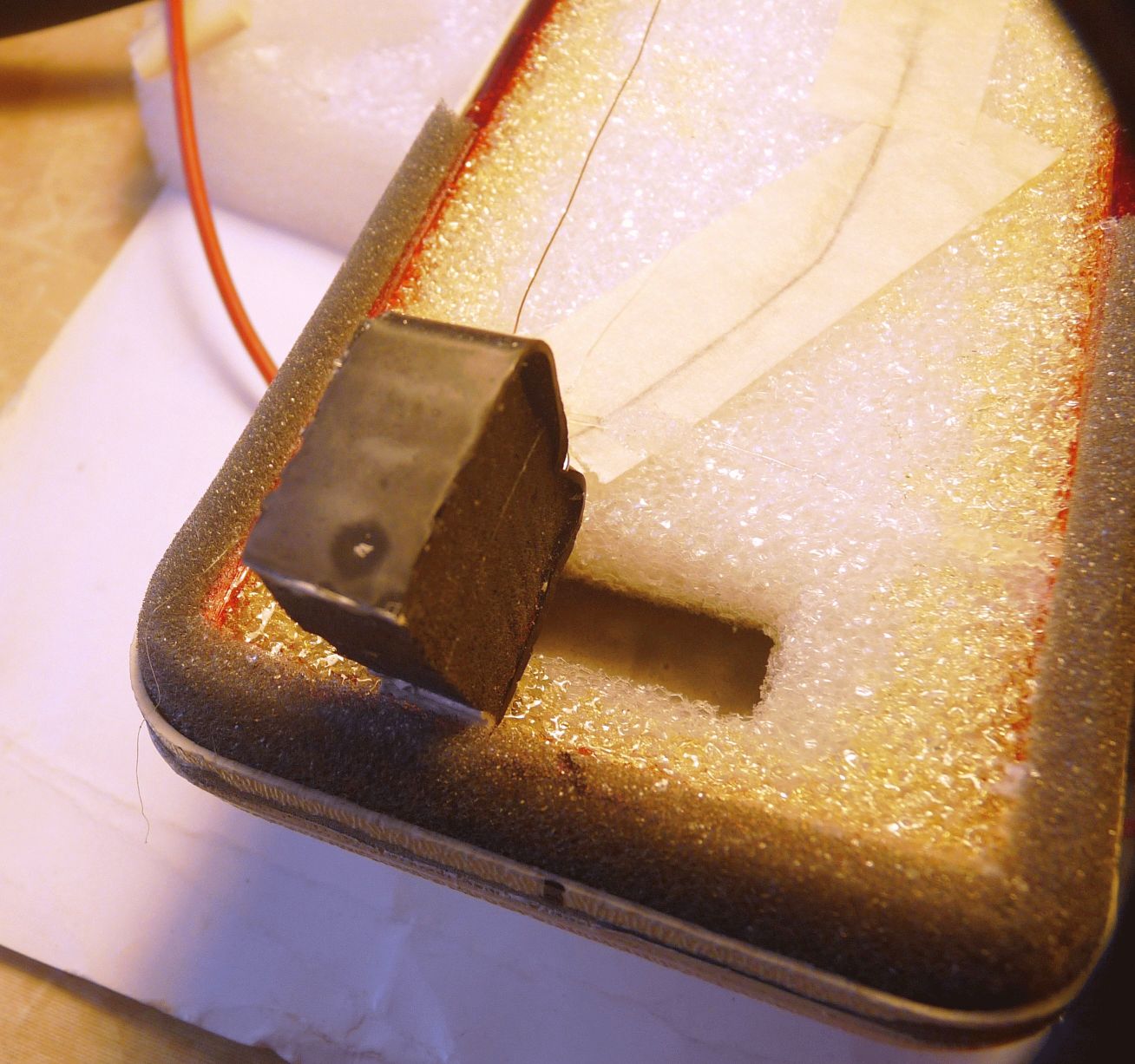

                        Here the carbon shield top side - measured resistance in 4 quarters lengthwise - 2.1k, 3.4k, 4.3k 4.8k Ohms.
Name:	BF_carbon shield_top1_Lores.jpg
ID:	354410 Click image for larger version
Name:	BF_carbon shield_top2_lores.jpg

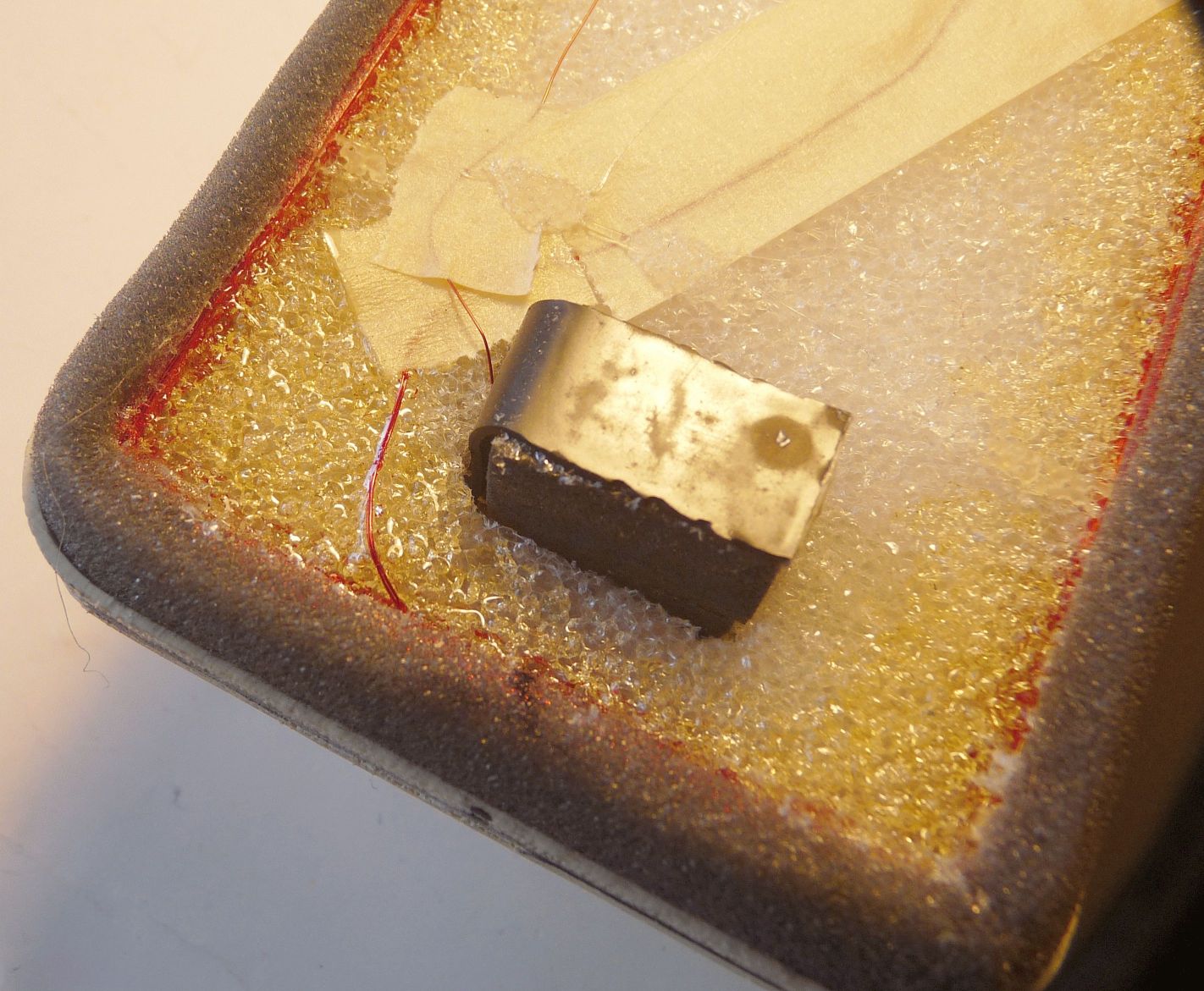

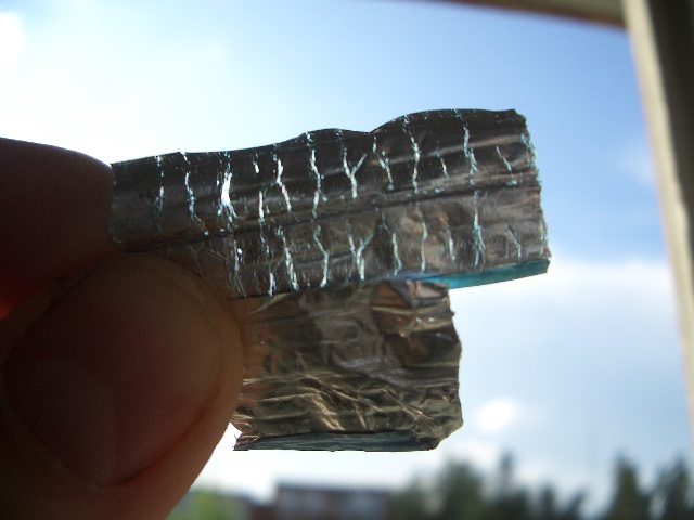

                        Here's the shield contact. The black foam inside is NOT conductive, the outside U-shaped thick tape is. I somehow like the way this has been done. Cleaned it with IPA.
ID:	354412 Click image for larger version
ID:	354413 Click image for larger version
                        Can't post more than 10 pictures in one post - see next post
                          ... continued
                          last picture of shield contact.

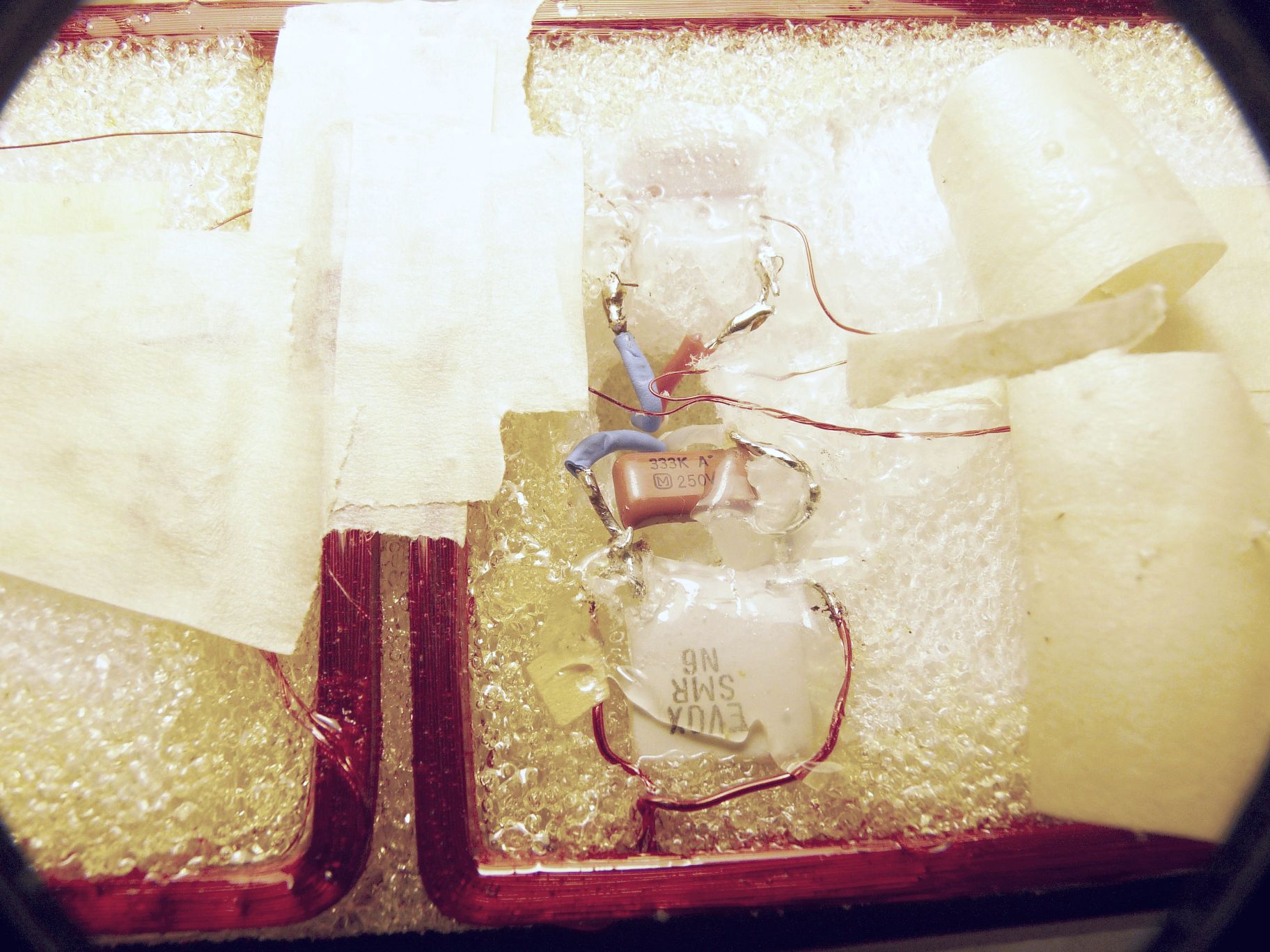

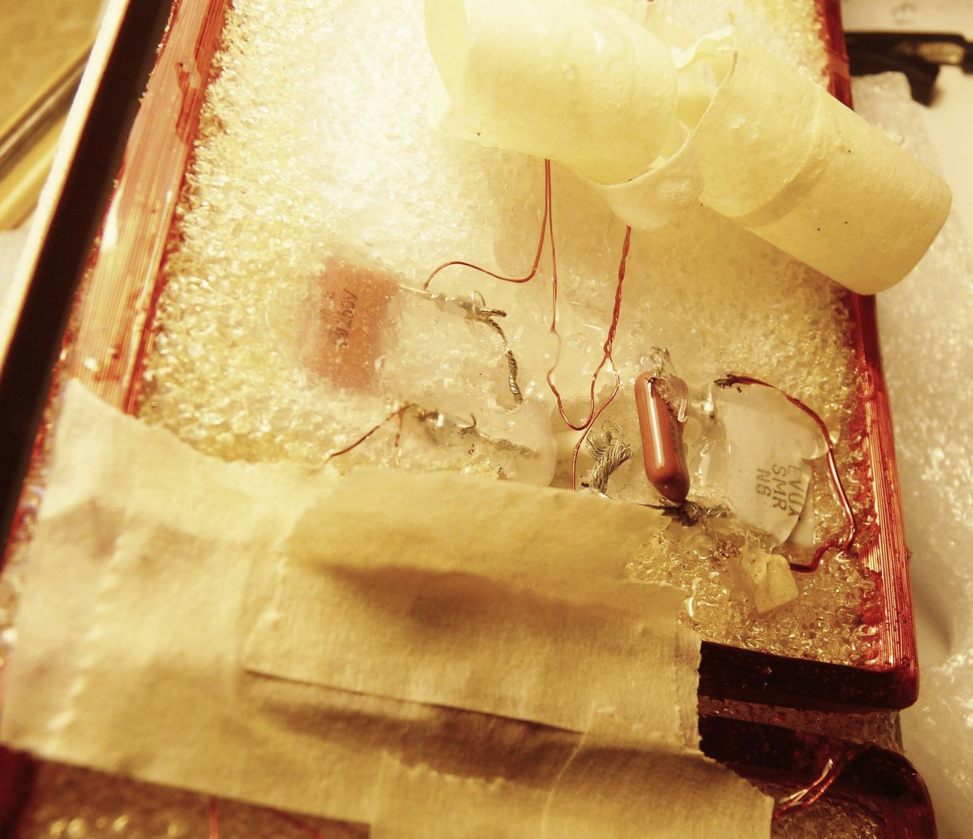

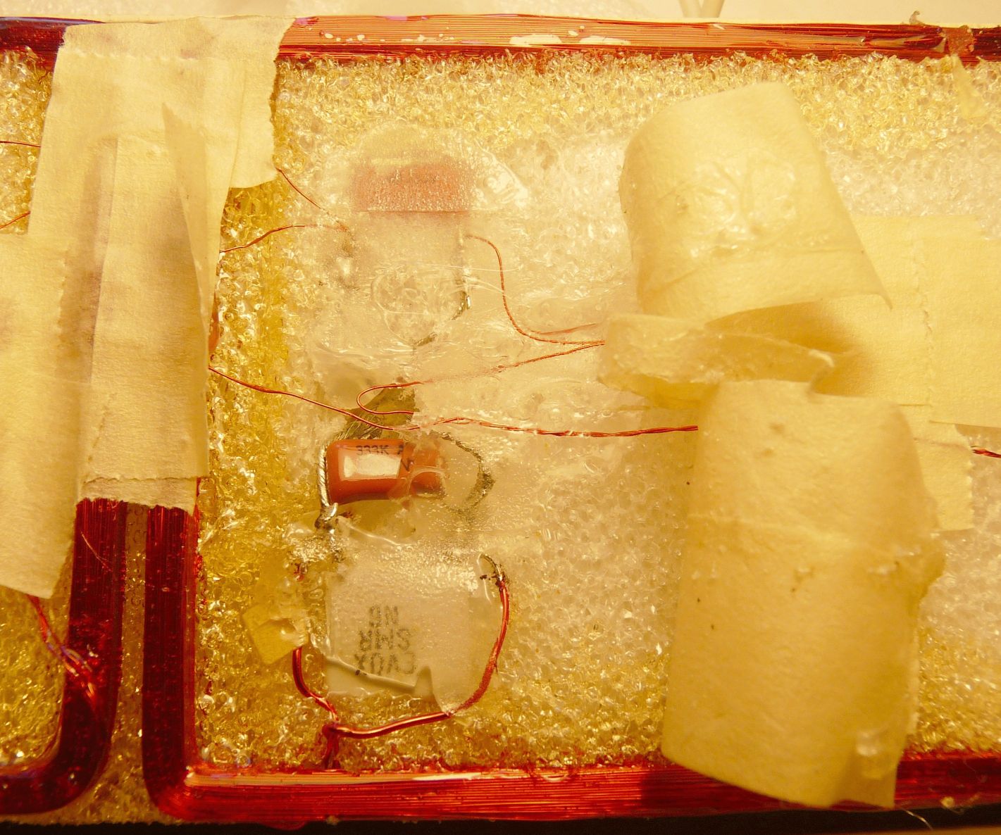

                          Closeups of the problem zone. The Tx capacitor is 33nF and the white box presumably in parallel I couldn't decipher.
                          Didn't want to dig it out to see the other side. The Rx capacitor has 47nF.
Name:	BF_closeup problem zone_1_lores.jpg
ID:	354416 Click image for larger version
Name:	BF_closeup problem zone_2_lores.jpg
ID:	354417 Click image for larger version
Name:	BF_closeup problem zone_3_lores.jpg

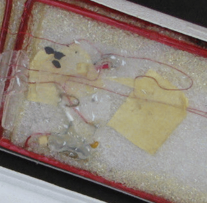

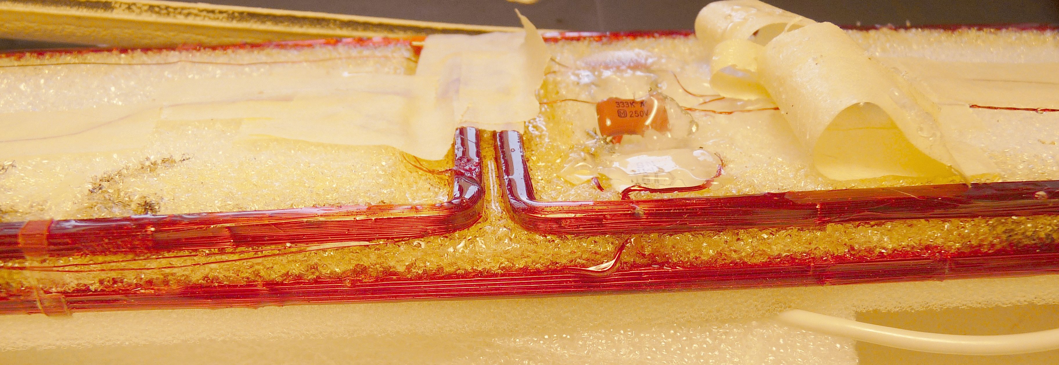

                          Here's everything resoldered:
                          Another note:
                          I unstuck the masking tape with the help of a heat gun - it surprisingly was still sticking extremely well.
                          The foamy translucent stuff around the hot melt stuff does not like that heat at all. The volume of that stuff disappears quickly, so careful with that.

                              I have a second Bigfoot coil -brand new- as a spare. This one has the Belden M 8723 CM cable on it. Yep, it has foil shielding and is thinner than the other cable
                              that I have worked on. This cable I will want to change too. The skinny cable I also don't like because it "curls up" "knots up" too easily ... for lack of better words.
                              I am still on the lookout for good double coax in round cable and have tested a few dozen S-video cables which also coincides with my PI home build adventures.
                              Is there such a thing as a "good" foil shielding for IB detector cables that does not break down over time?
                              I am asking this as it appears that most current production cables of this type all have foils and/or semiconductive layers inside.
                              Older cables usually have braided or spiral shielding.
