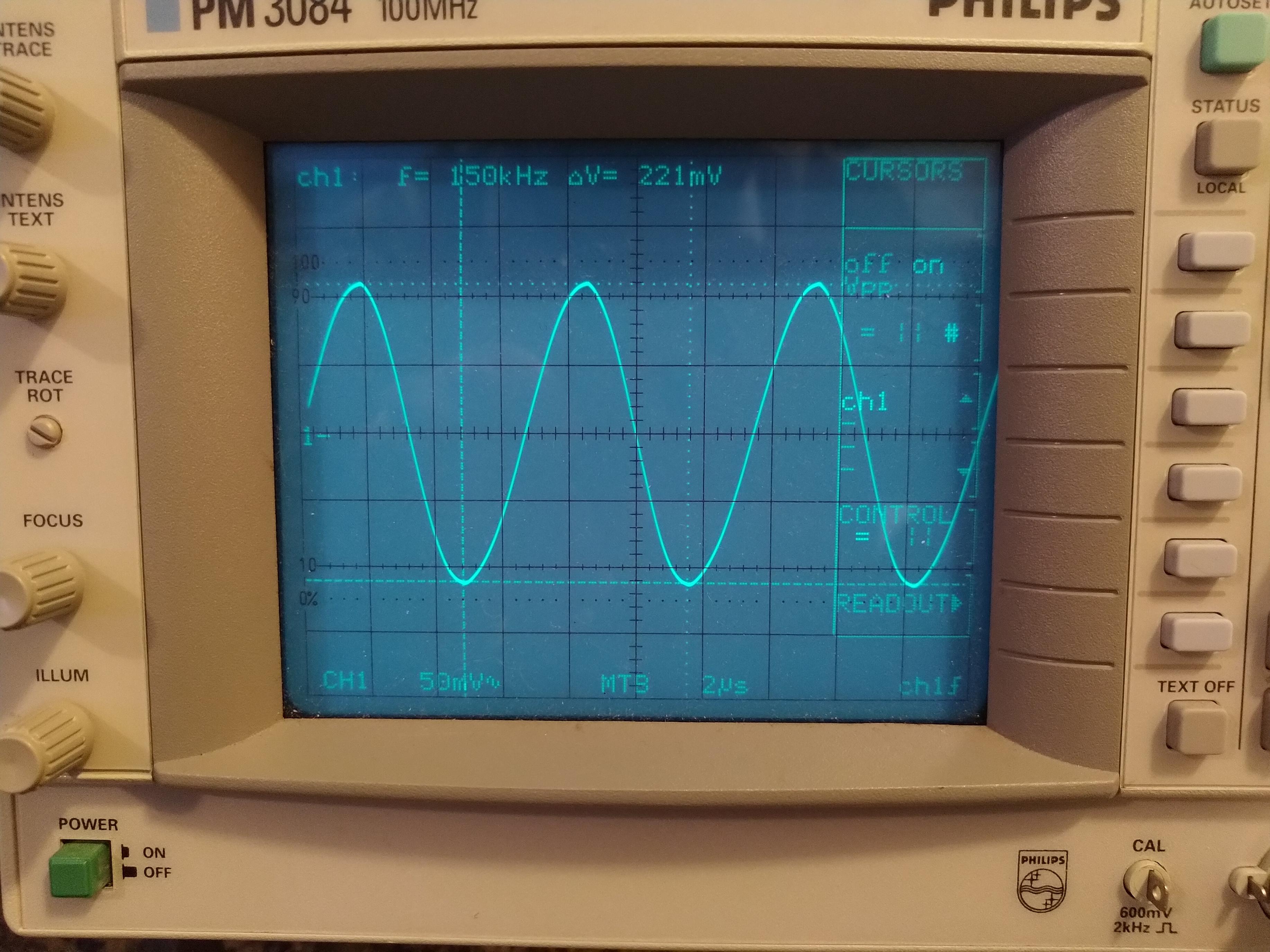

    I recently built a new 3dss coil for my minipulse and I'm unsure if I measured the self resonant frequency correctly.
    Here's info on my coil, 24 awg teflon tin coated stranded wire, 8.5 inch 3dss coil, measures 370 uH.
    Here's exactly what I did to measure the SRF,
    1. I hooked up my coil to a function generator and to the oscilloscope.
    2. I set the oscilloscope probe to 10x
    3. I set the function generator to sine wave and adjusted the frequency until the wave form reached its max peak.
    4. I then measured the frequency using the oscilloscope and I came up with 150 khz.
    Does 150 khz sound correct or did I not measure this correctly?
    Thank you everyone for your help!

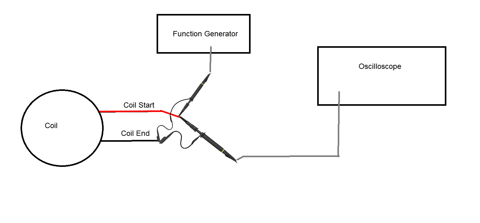

                Show how you hooked it up. Something's wrong, somewhere...
                Hi Carl,
                I'm not near my setup right now but I hope the attached drawing(as crummy as it is) shows how I connected everything.
                Thank you for your help!
                  wrong. you must put 1MOhm resistor in serial to 'hot' wire end to generator. o-scope must be connected directly to coil.

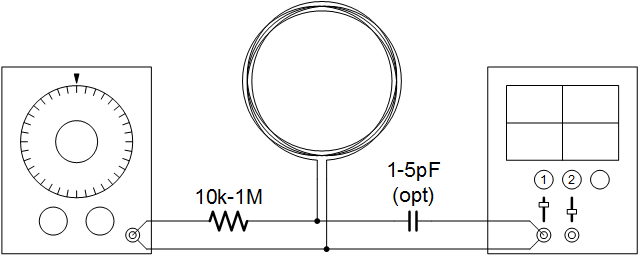

                    KT is right, you need a resistor to the sig gen. Optionally, you can also add a series cap to the oscope, probably won't make a difference unless you are trying to measure an aggressively fast coil.
                    Here is a diagram:

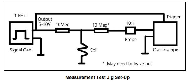

                        I'll share the Mirage process and test set-up I use to measure SRF and CPar here as well, as its topic relevant. How to Construct the Mirage 300uH Mono Coil.pdf
                        Now, onto a related matter. My above-mentioned test coil (with shield, but not potted in the ABS shell) capacitance is 84.7 pF. The Canare coax cable is 15pF per foot (I have 2 metres attached right now for my test bench purposes = 98.4 pF). My total coil (potted) and cable inductance is 304.5uH. The SRF= 555kHz. The total calculated CPar is 270pF from CPar = 1/[(2*pi*SRF)^2 * L)]. Therefore, I can only deduce that the combining of the coil to the coax cable and the potted search head adds (270 - 84.7 - 98.4) = 86.9pF. I think Godigit1 has a good idea when talking about using expanded polystyrene foam and other plastics (Non ABS) for the search head filler/cover.
                          323, i read the connection of o-scope to a coil directly is bad idea and right circuit on this pic
