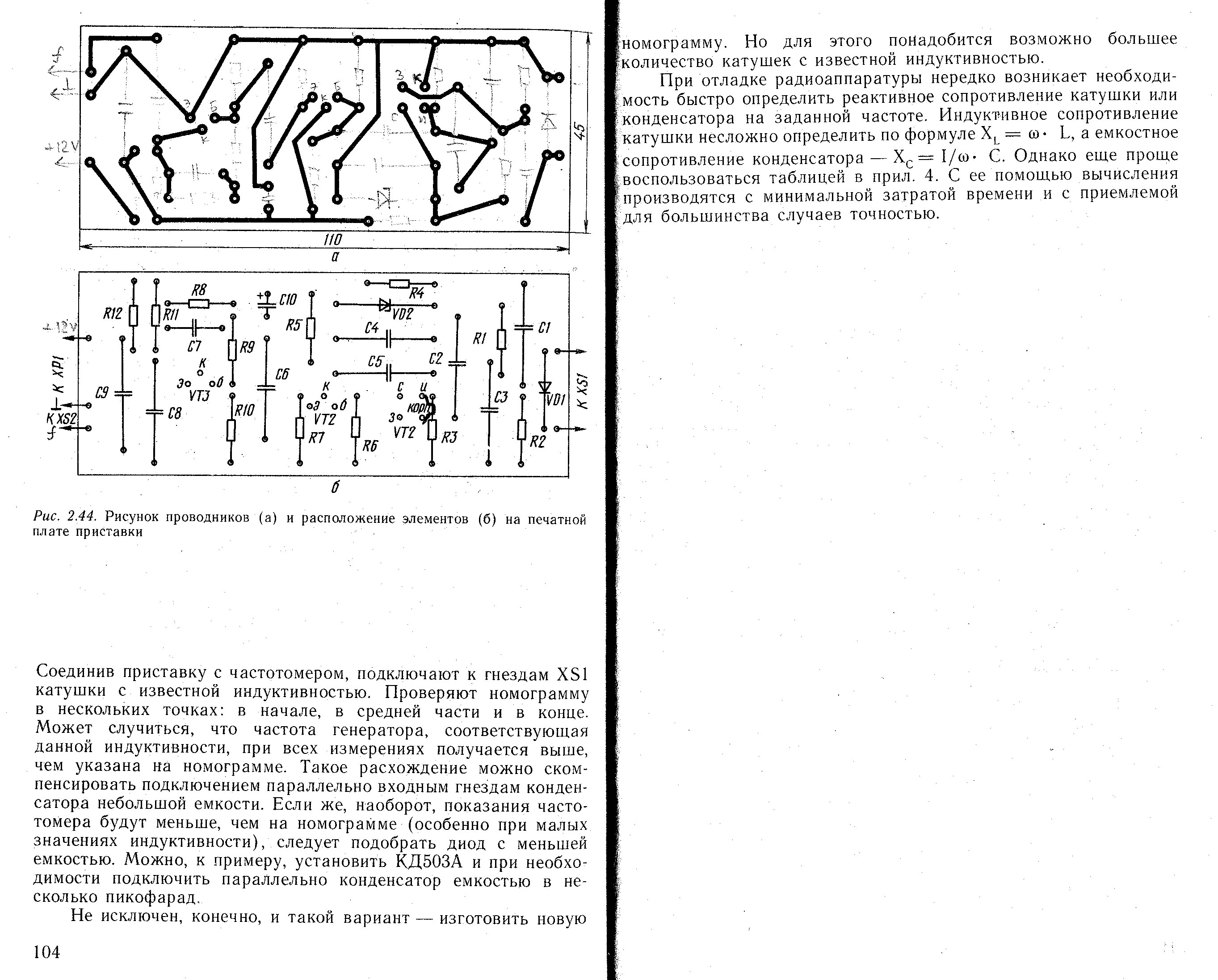

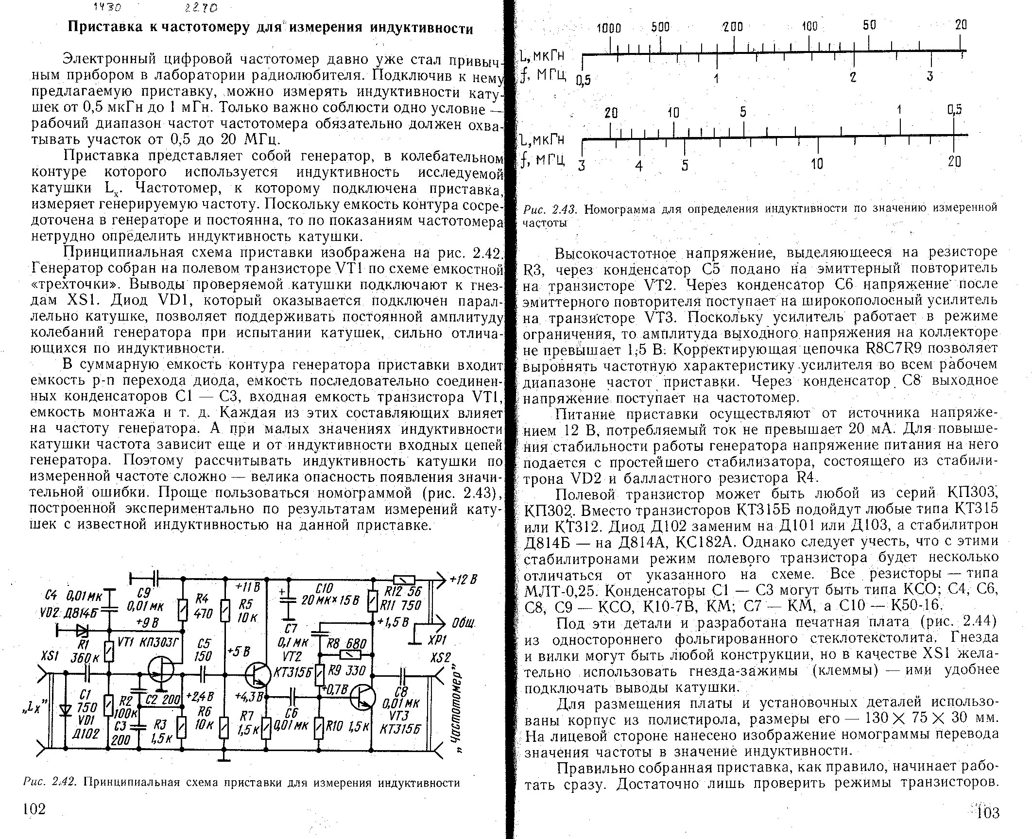

                      This circuit was posted awhile back in the Tools section by Teleno. Thread titled: "Measuring coil inductance and parasitic capacitance." I posted a spreadsheet in there which will make all of the calculations for you.
                      I have built and used this circuit myself and it works great, especially for comparing coils. It provides 3 good bits of coil info: inductance, parasitic capacitance, and SRF from only two frequency measurements (cap in-circuit and out of circuit). What's really unique about it is the fact that it does not require a scope, signal generator, nor anything expensive - only a cheap frequency counter (Ebay, Ali, etc.) and the circuit itself.
                      For a large percent of hobbyists on a budget, this is a great little 3-in-1 tool and highly recommended in my book!

                        Yes, I remember the thread, that's why I was able to recognise what the guy in the video was up to, since I had been familiar with this circuit from before.
                        The spreadsheet you posted was very helpful, as it did make all the calculations.
