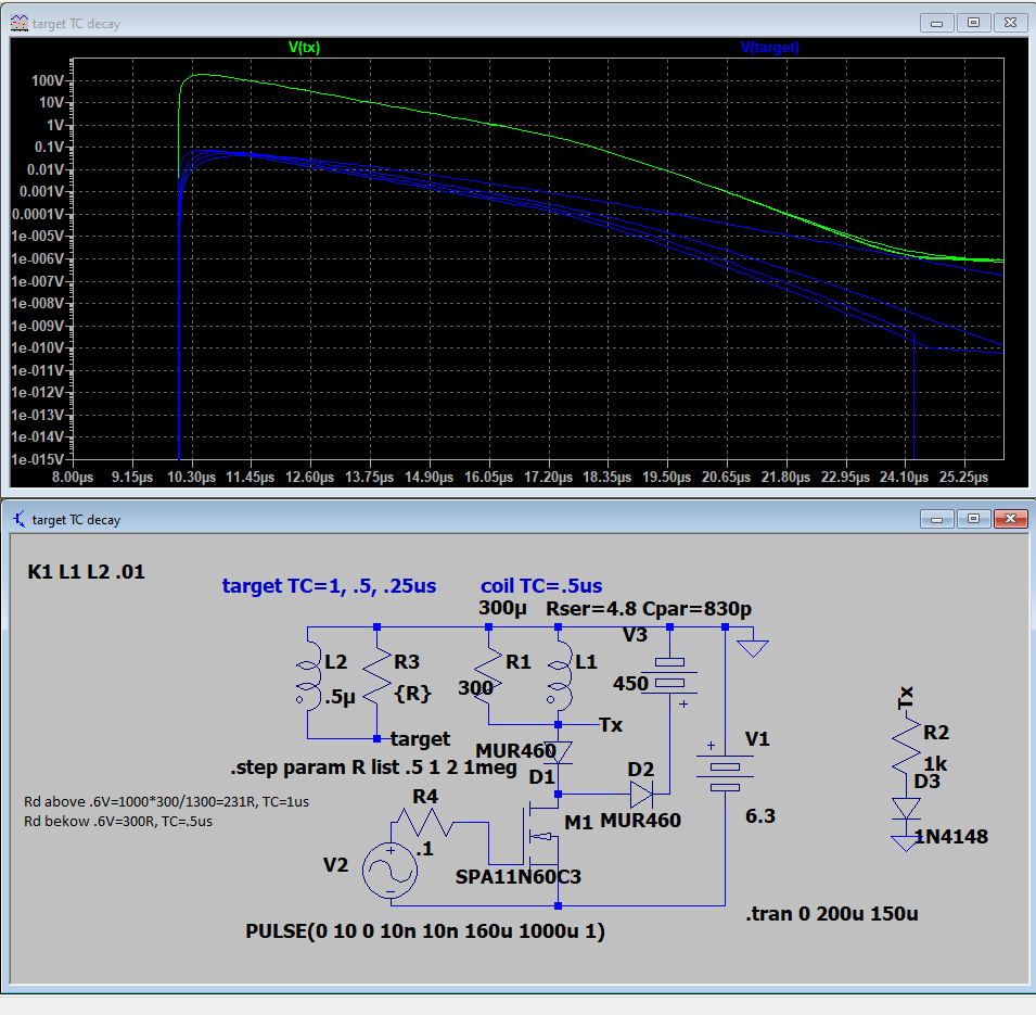

    I've been thinking, can't but wondering if I'm wrong. Tried to make a spice simulation to see if I could. Haven't been successful, any thoughts on how to make or change the simulation so it could detect a target with a TC less than the coil TC?
    green,

        Discharge TC of the coil, time for coil volts to decrease to 37% of start value. TC=time to change 1 decade/2.3. Circuit decay, includes external capacitance. The simulation shows coil decay TC=L/2Rd not L/Rd.
          The math also shows this. It is an RLC circuit, not an RL circuit.

              I'm not quite sure of the question, but for a critically damped RLC circuit (which is the case for a PI) the decay TC is L/2R, where R is the total effective damping resistance. That may include the clamp R. Obviously, the decay can be critically damped while clamping, or while not clamping, but not both, so it's a little erroneous to consider it critically damped all the way. But I usually consider it "close enough."
                There is going to be a transient response and you can bet that spice modelling is going to notice this.

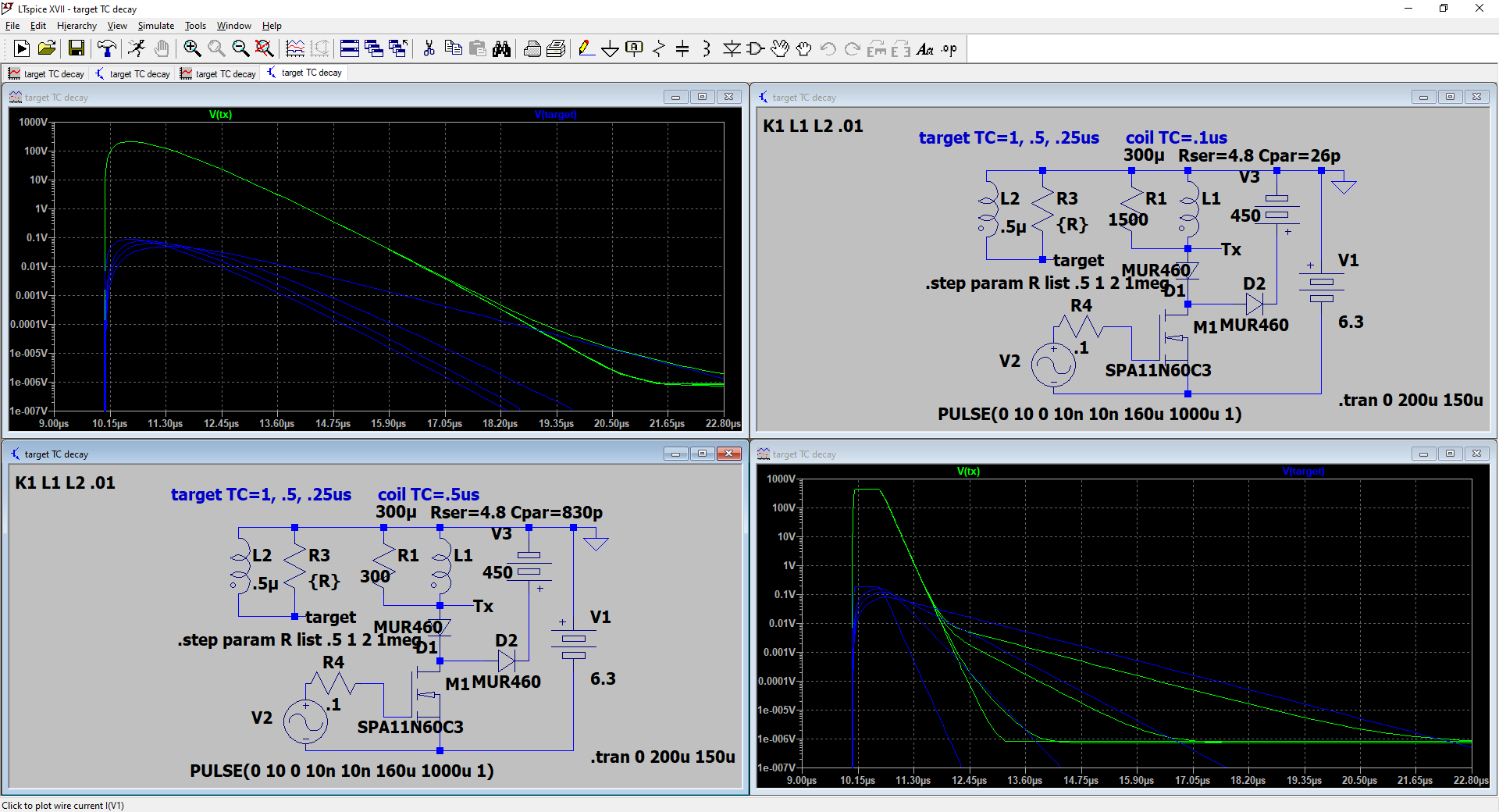

                  SRF for circuit reply #1=318kHz (.5us TC). Not a fast coil. Changed capacitance and Rd for SRF=1.59MHz (.1us TC). Did a simulation for both to see the difference in target stimulation. Been thinking target decay should cross coil decay to detect target but all that is necessary to detect a target is for the coil voltage to change more than the noise. Wondering if JL could detect the .5us target with a circuit SRF of 318kHz with his 20bit A-D. Wasn't thinking about targets with a TC less than the coil decay TC decaying at the coil decay TC. Makes sense because the are coupled?

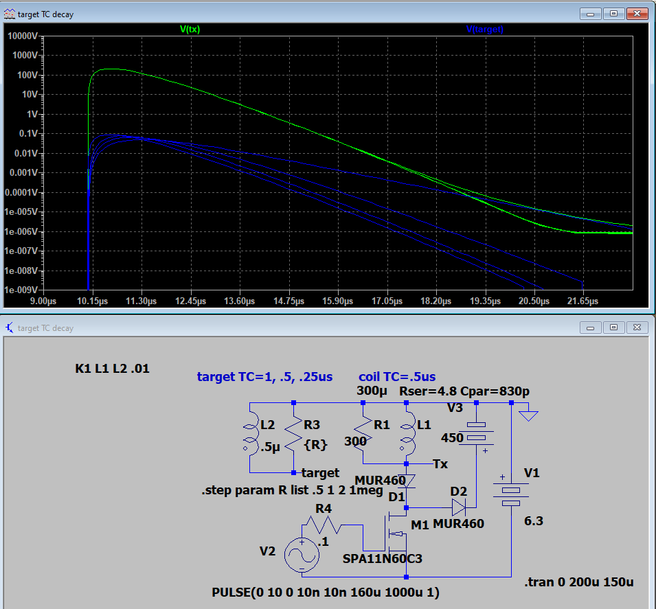

                          Rin going to +input is the only time there are two slopes. Coils with separate Tx and Rx and mono coil with Rin going to -input should have one slope. For Rin going to +input calculate parallel resistors above .6V. Don't know formula to calculate decay TC.
                          Added 1k input resistor and diode to simulation reply #1. Input resistor doubled TC for the simulation.
                          Do you think there's any technical advantage to maintaining a constant damping resistance for the entire decay time ? Yes if looking for short TC targets.
                            [non-PI guy here]... I was thinking along the lines of switching in a damping resistor, once the transient voltage had fallen below the approx 0.6 V where the protection diodes conduct... Apologies if it's a well-used technique....
                            Well used... NO... but you are on the right track. The theoretical optimum would be to switch in the damp at the instant that the coil current reaches zero. You can approach this in practice, but it is not just a matter of switching in the damp... some additional things must happen at the same time... but it is doable.
                              If Mr. Greens latest simulation were changed to Rd = 430 R, and input protection resistor R = 1k0 , then he would have critical damping ( 300 R ) until the protection diode stopped conduction, and a modestly under-damped response thereafter.
