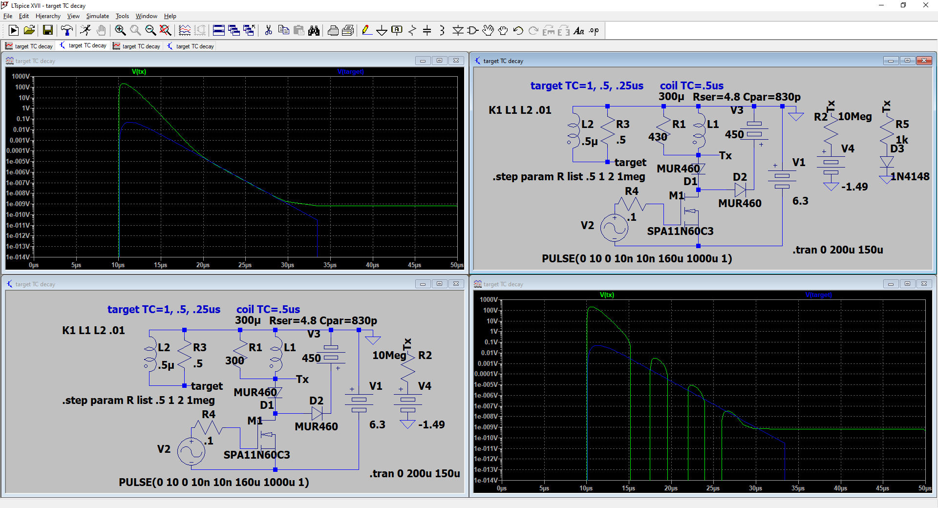

      If Mr. Greens latest simulation were changed to Rd = 430 R, and input protection resistor R = 1k0 , then he would have critical damping ( 300 R ) until the protection diode stopped conduction, and a modestly under-damped response thereafter.
      Tried it with spice. Added R2 and V4 to cancel leakage current thru M1 so coil would decay closer to zero. Oscillates with 430R damping resistor. Probably wouldn't matter using an integrator with a few us average, wondering if there could be a problem taking a sample of amplifier out with an A-D during the oscillation.
        Looks like 'modestly under-damped' is not the way to go ! So presumably you'll have to work with: over-damped until the protection diode stops conducting, then critically damped?
        Re: leakage: I don't know how it works in a Spice model, but in the real world, taking the gate of an enhancement-mode N-FET negative turns it off more. I assume this is easy to model, setting gate voltage source to ( -5 10 -5 etc.. ) would do it ?
          The decay signal looks a lot better critical damped with spice, a little underdamped with a real circuit doesn't seem to matter with what I've tried. Haven't tried sampling with an A-D and was wondering if oscillation could cause a problem.
          Leakage in the simulation is actually thru D2 and V3(added for fet avalanche). Leakage in real circuit would be thru D1 to the voltage stored on the drain after coil decay.

              Getting back to the question of detecting a target TC lower than the coil TC... ain't gonna happen. Consider a 300uH coil that has a high enough SRF to use a 1k damping resistor. The coil tau is therefore 150ns. You might think that the natural coil response will decay in 5*tau but that's not nearly enough.
              First, it is not a simple RL decay but rather a critically damped RLC decay, which has the form t*e^(-t/tau). Second, it drives a usually high-gain amplifier which must settle far enough to be well within its linear range. It would not be unusual that the coil voltage must settle from several hundred volts to a few mV. This will require more like 10-15 taus to settle, on the order of 2us for the example.
              So a coil tau of 150ns isn't usable until 2us. And this doesn't include the opamp recovery delay. A 150ns target is long gone.
