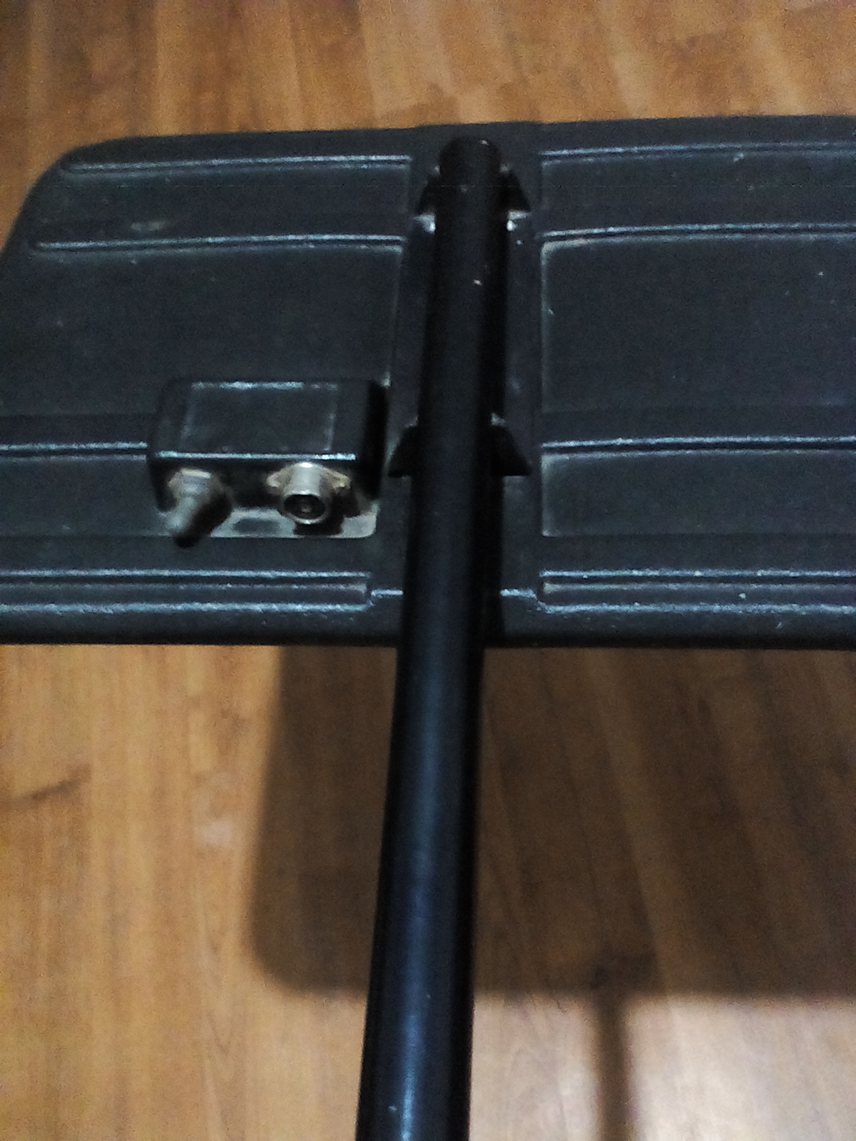

    Шта је склопка на Гарет завојници са две кутије? [АТТАЦХ] 49566 [/ АТТАЦХ]
    BABOJHNUN ABE KYTNJE ?

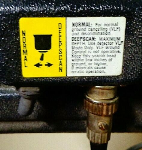

    Maybe it's the VHF / UHF TV band switch?
        [ATTACH]49574[/ATTACH]
        Thanks Karl !There are no stickers remove ,I measured inductance the switch changes the inductance and resistance,thus changing both the frequency and power of the transmitter !
