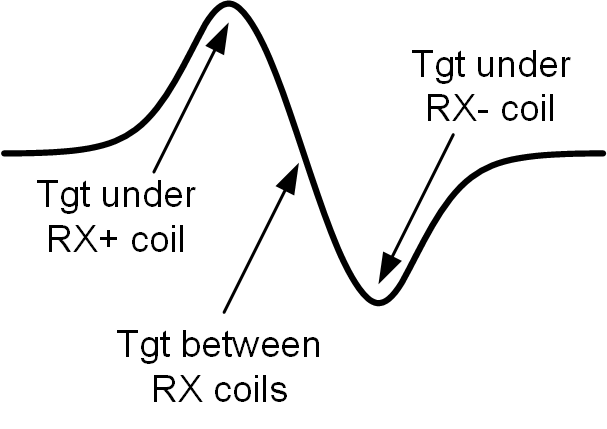

                I wonder how the Zed gets depth if Rx is wired inverting. I got a large signal loss at distance. What am I missing?
                  Don't know how he Zed does it but I think I could do both. Rx inverted for closer targets, better signal to noise. Rx adding for distant targets.
                    You want to look at the overall temporal response of the DOD coil. That is, what is happening as the coil is swept over a target:

                    You get a null at dead center but not for each RX coil. You could, for example, rectify this response and filter it for perhaps an enhanced response. No idea if this is what ML did or not, I have not played with the Zed enough to figure out what is going on. But this is exactly the same method I use in designing a security walk-thru detector.
