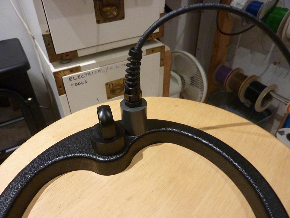

      The detectors that the divers have are Aquapulse AQ1B's which I am very familiar with. The orange cable is RG58 coax but with a polyurethane outer jacket rather than pvc. For use in seawater, the minimum delay is 30uS. I would guess they are divers working the Spanish wrecks off Florida and also they are using 8in search coils, which are the popular size when looking for gold and silver coins. A ferrite cored probe is available, but I haven't seen them used much.

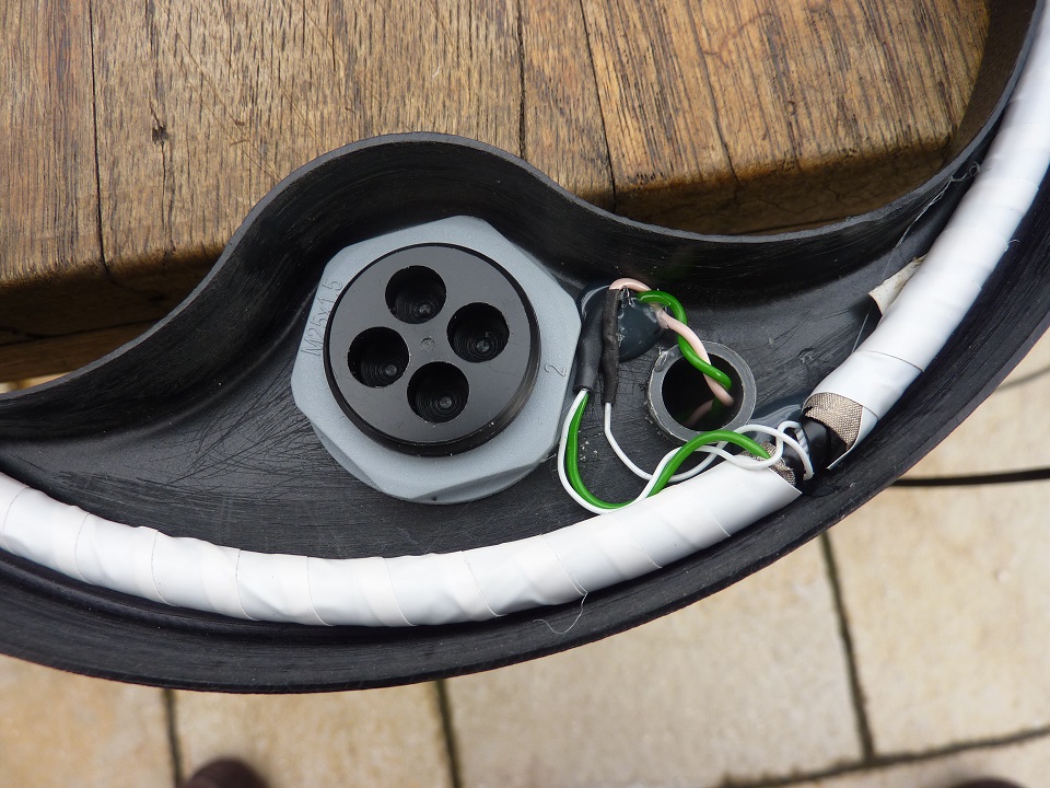

      What can happen with coax, is that where the braid end is twisted together and soldered to the coil wire, it becomes a substantial conductor, and if close to the coil winding gives a detectable signal, particularly at shorter sample delays than 30uS. The problem arises where the cable flexes just up from the entry point in the coil shell. This flexing results in the braid conductors tightening and loosening, thereby varying the conductivity of the braid in that location. For the 8in coil, I put in a spacer that lifts the coax joint away from the coil winding by about 1". For a 10" coil with spokes and a centre swivel, the coax entry is near the centre and well away from the coil winding.
      The problem is worse for a ferrite cored probe as the coax and joints to the coil wires are right on the axis of the core. In making such a probe, I always have the outer tube long enough so that the coil wires to the coax joint are several inches away from the back face of the core. Always put a drain wire to the core as they are slightly conductive. One thing I have noticed with some cores is that waving in the earth's field generates a signal almost as though it were trying to act as a fluxgate element.
      Eric.
        Hi Eric, interesting post, when you added the 1" spacer was there a really noticeable difference in just such a short distance ?
          Yes, it does make a big difference. As you can seen in the picture, if the coax were brought into the shell without a spacer, the braid and soldered joint to the coil wire would be right up against the coil. It's like a small nugget would respond; you can detect it on the coil edge, but nowhere else. The coil wires go down the short tube of the spacer and join the coax just by the bottom of the strain relief.
            [ATTACH]49668[/ATTACH] [ATTACH]49669[/ATTACH]
            Eric.
