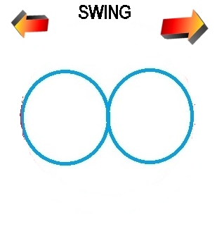

    Yes, a Figure-8 coil should do a pretty good job of canceling salt. Also Earth field, and far-field EMI. I would turn the 8 sideways so as you sweep the coil both lobes sweep over the target. Think of the DOD coil on the Minelab GPZ... that's exactly what it is. The raw output form the demod then looks like a first derivative signal, and the output from the SAT circuit looks like a 2nd derivative signal. The glitch is this: when you sweep in one direction over the target, the SAT out is positive, and in the other direction it is negative. You can fix this with an absolute-value circuit.
          Like this ?, does a folded FIG 8 need damping on both sides or only if you use two separate coils, my guess is if you use two coils for the fig 8
          also if useing a fig 8 where is the correct feed point for the feed line, my guess at the cross over.
            also if useing a fig 8 where is the correct feed point for the feed line, my guess at the crossover.
            Yes, that's what I meant. I've never made a Figure-8 by folding a coil, always use 2 separate coils. But on a PI I suspect the coils need individual damping so the folded coil won't work. You can place the feed point(s) anywhere.

                  A Figure-8 mono coil (both TX & RX) won't cancel ground or salt because, for targets, it ends up with additive polarities for both lobes. It only subtracts for non-energized signals, like EFE and EMI.
