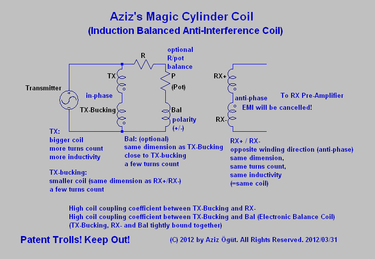

                  Was Aziz's "top hat" coil like that ?

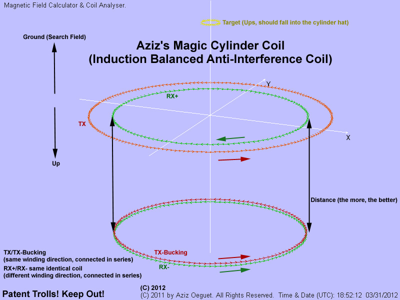

                      Yes, same principle as the top hat. I think the top hat had a large TX coil, small RX coil coplanar with the TX, then a reverse-RX coil elevated above.

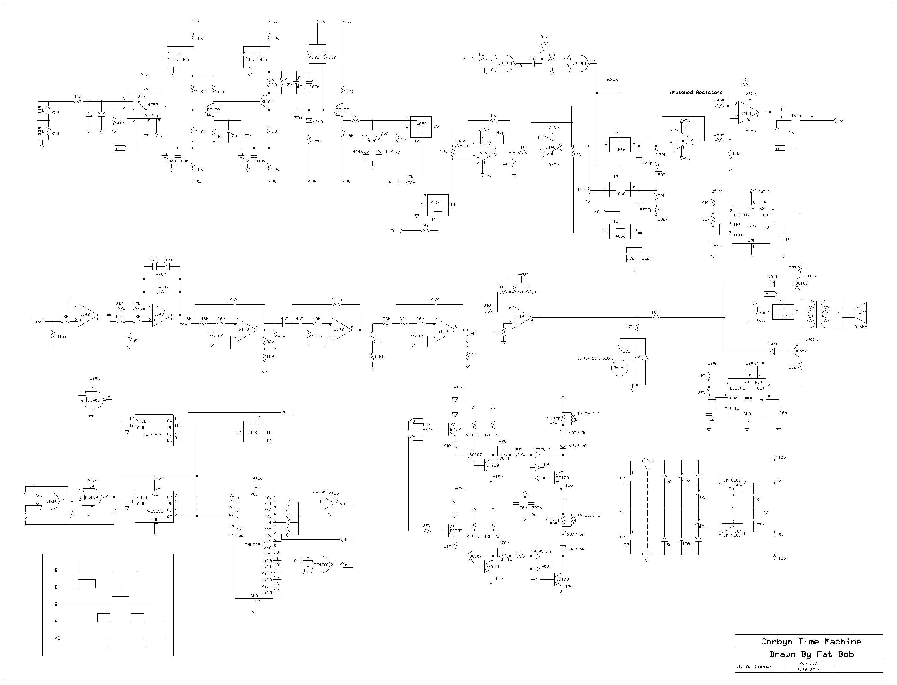

                        How about this:
                        https://www.geotech1.com/cgi-bin/pag...rbyn/index.dat
                          From Fat Bob.
                            I think this was Aziz's top hat coil, or some variation of it
                            shows how to connect it. search "top hat" in forum.
