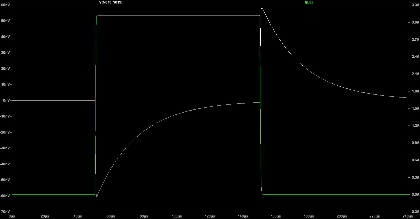

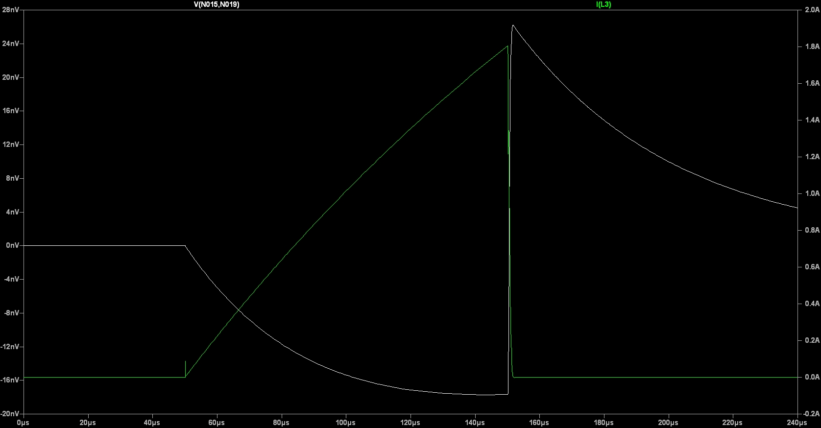

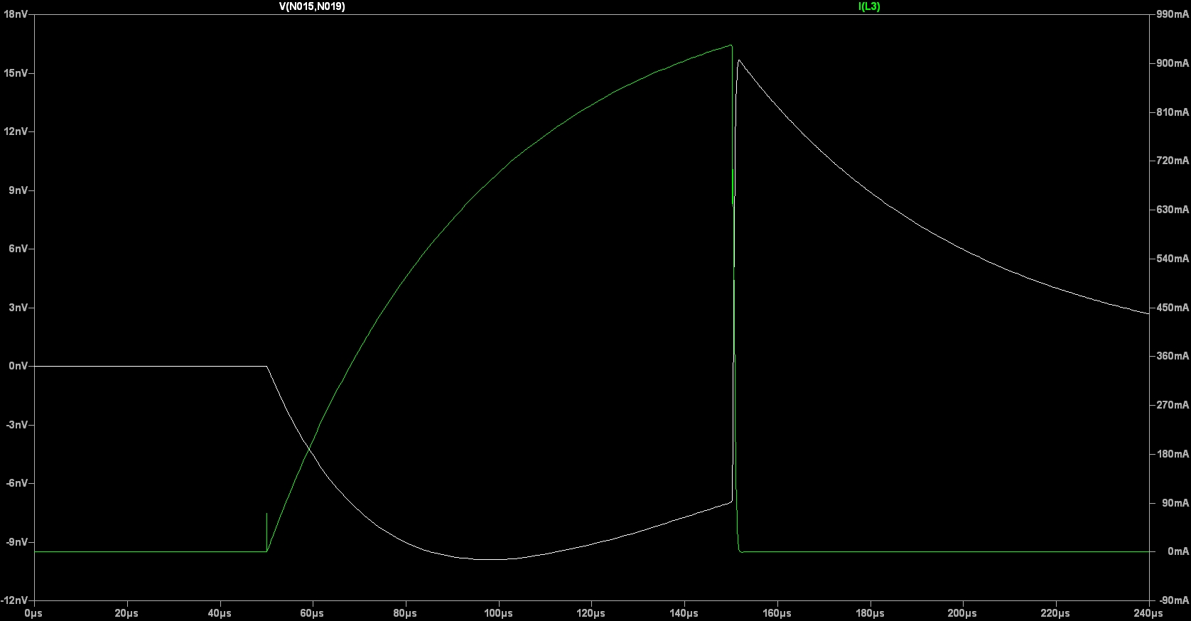

        Searchy my explanation was a bit esoteric, perhaps the attached images will explain it better.
        100uH coil in both scenarios, but one is the traditional PI and the other is CC or Constant Current, similar to that used on the Minelab GPZ, although they use bi-polar pulsing. It will detect a nickel at 2 feet in an air test not even maxed out, this is one reason why.
        The Green Trace is the current and the white trace is a simulated signal as seen by a target with a 25uS time constant.
        Firstly look at the traditional PI with 100uH coil, you will notice that the coil current is still rising when the pulse ends, also notice that the target signal is negative at this time, this negative value will subtract from the positive value when you go to sample. Any changing magnetic field will cause eddys in your target, positive or negative.
        Looking at the CC PI you can see that the response in the target has almost returned to 0V when the pulse ends, now look at the value of the positive response, in effect you get nearly twice the signal for a similar amount of current. Plus look at the response just after turn-on, you can also sample the turn-on decay as well and cut you pulse rate in half and still receive almost twice the bang for buck.
        For clarity there's the 300uH traditional PI also to compare, ideally you would design it to have steady state current, where it flattens out before terminating the pulse.
        Cheers
        Kev.

          Why is the target decay slope for the CC different than the standard decay? After Tx off.
            How do you mean different Green?
            It begins from a higher amplitude, the corollary of the on-time decay.

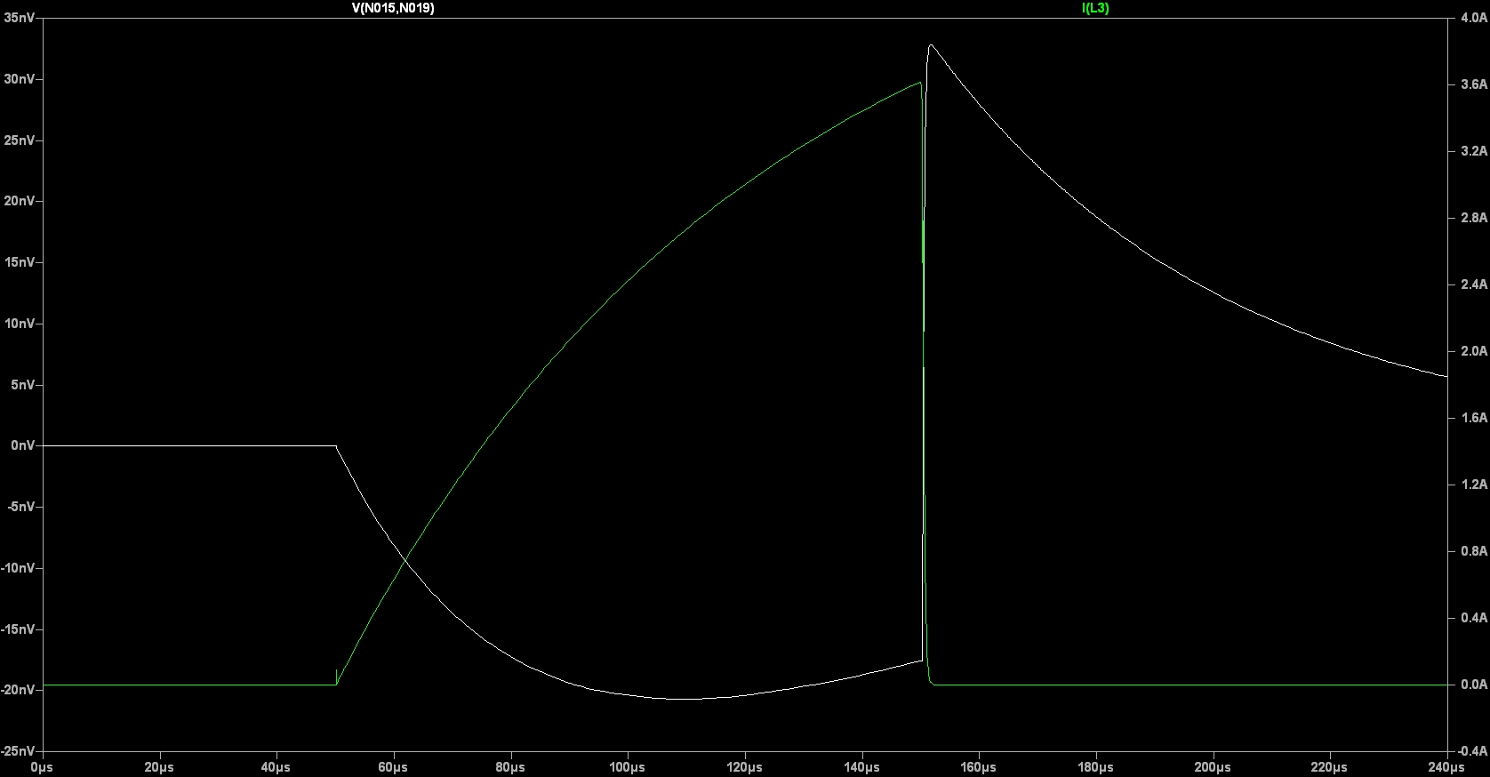

            I need to add another caveat, the coils I am simulating are Minelab coils, they have a resistance less than 1 Ohm.
            Here is the same setup with a coil of 6 Ohms.....more sensible current...but a 1 Amp CC device would kick its' butt.

                I'm thinking the decay after Tx off should be target decay, 25us TC. The one with CC appears to be different. It would be easier to see decay slope if Y axis was log.

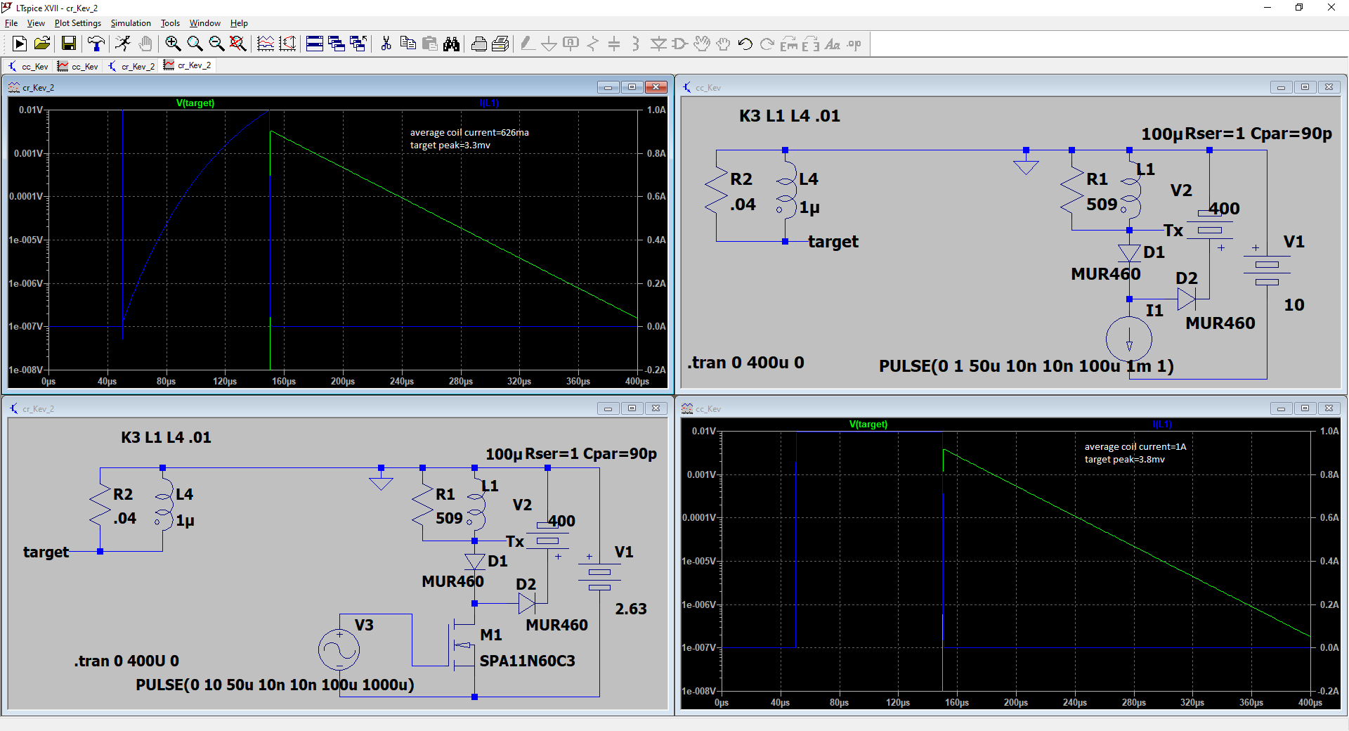

                          My attempt. Target TC=25us, peak coil current=1A, Tx on time=100us. Coil TC same as Tx on time. Don't know if IDEAL. Don't know a good way to make a CC driver so went the easy way and used a current source(problem is I can't find one in the catalog)maybe someone could suggest a circuit. Target signal is 15% higher and average coil current is 60% higher with CC. Target decay after Tx off same for both methods. Replace the MOSFET with a current source for CC sim.
                            Yes you are right Green, I get the same results, I must have a bug in my sim somewhere, even so the sims do not always transfer to reality, the reality is not as bad as described, and likely I have exaggerated something somewhere.
                            Cheers
                            Kev.
                              I've found the problem I think. When I uncouple the HV driver from my sim circuit I get 42% less max signal strength. So in your CC example the response would be 6.56mV rather than 3.8mV if the pulse had a HV leading edge.
                              My first attempt at CC I simulated an H-Bridge CC circuit, it worked really well virtually, but when I built it, it failed to work, I didn't use a HV pulse former to blast through all the parasitic C and reluctance etc.
                              The off-time is a corollary of the on-time within several TCs of the coil at least, it appears that what happens to the target at current-on affects what happens at current-off.
                              I hope I've got this right otherwise my whole circuit is mush.
