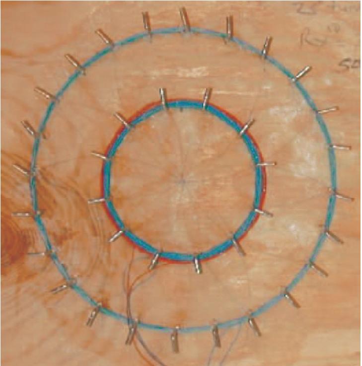

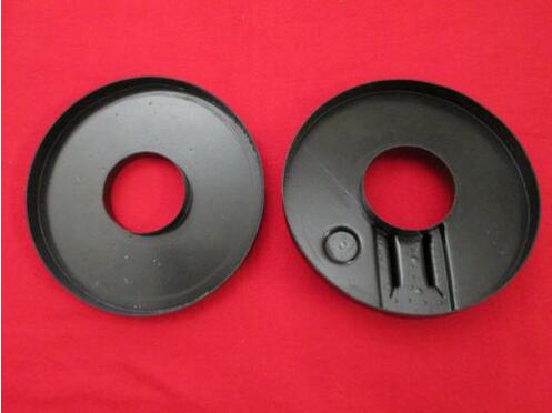

    This is my first build and here is what i bought, wondering which configuration would be best for a start,it is going on a surf PI but i have a mini-pulse coming from andy, the surf is prebuilt and tested,
    I have a 7 inch shell , so how about a concentric, or about a co-planer. I was thinking bbsailer fast coil, single wire around outside edge, or the co-planer with an out side coil and inner coil, or a basket weave, 1 of those 3 because of the coil shell i have, i also realize that a 7 inch coil is kind a small for beach use, doesn't cover very much ground, i may make me a vacuum table to make my own shells for future use since i can get material for free and im a carpenter from amongst other things i do

    If this is the very first coil and detector you build then make a simple MONO coil.
    The co-planar (concentric) is an IB (Induction Balanced) coil that is a bit tricky to correctly Null. Save making one for after you have the Mono coil working. An IB coil also requires the PI detector to have the option of a TX coil and RX coil connections. Don't remember if the Surf PI has this option.
    7 inch coil is fine to get started with. Sounds like you have the skills and tools to build a vacuum table and coil shell forms.
