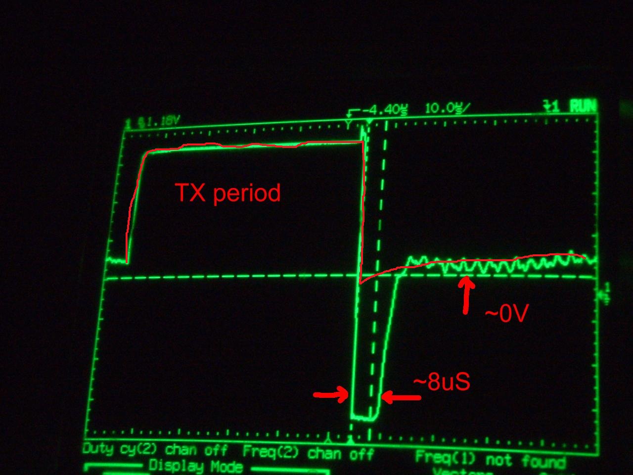

    I need help with my self-made 1 layer pcb surfmaster. The waveform according to my cheap oscilloscope (Which i can't screenshot it here) . it would look like the pink line on the attached image no matter what dump resistor is it. (Thank for Tepco's waveform images). And one more thing no sound at all.

            OK Sir, I removed Dump resistor and here is the waveform (RED LINE)
            And the same waveform after removing the coil but pure square wave for TX Period and no small notch for RX Period like the red line.
                    [ATTACH]53250[/ATTACH]

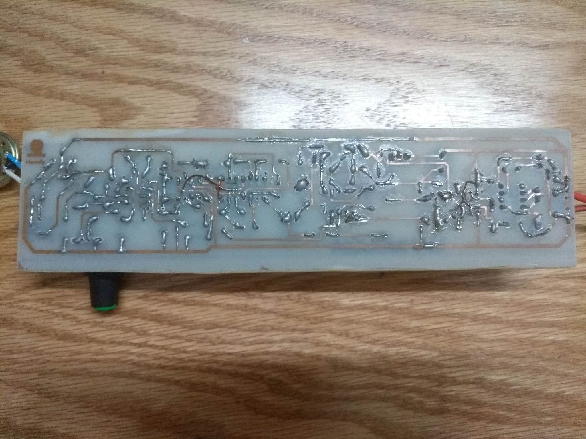

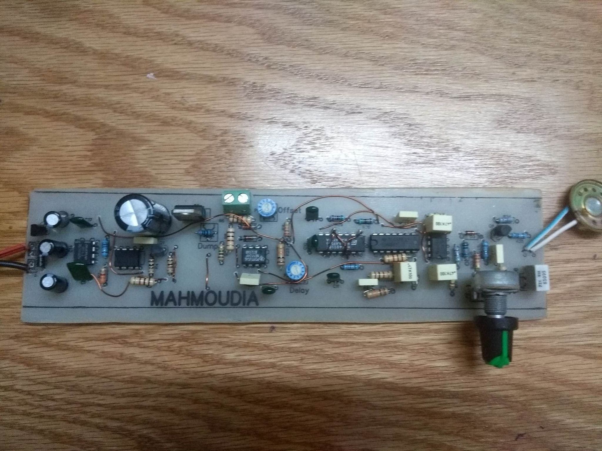

                    Can you show some pictures of the pcb ?

                      It looks to me like your coil is not actually getting connected to the circuit. Maybe you have a break in the cable wiring.
                          Ok sir here is the images
                            It isn't broken because when i test it with continuity mode using the multi-meter it beeps
                              check diodes on op amp input. i see one is shorted.
                              None is shorted.
                              And when i hold the coil with my hand. The op amp pin 6 goes from 0v (Calibrated with offset pot) to 0.58v. no respond from the coil but that. and still no sound even with that!!!.
