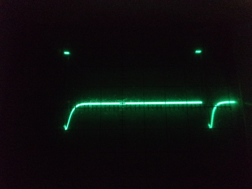

            This is what my surf preamp looks like when both coil and correct damping resistor are both connected. (I am useing what is labelled LF357, dont know if its real)

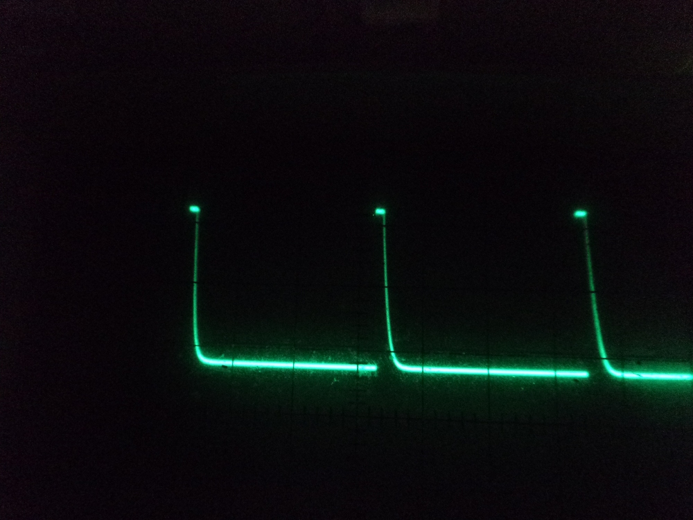

            Then if I remove just the damping resistor you get crazy oscillations.

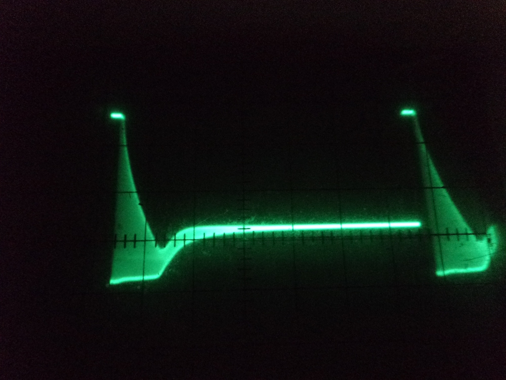

            Then if I remove the coil and just have damping resistor

              Are my attachments visible ? some times the forum does silly things with attachments ?
                I can see your attachments just fine. Always good to see the examples of what things should look like as opposed to simply a written explanation, it adds another dimension.
                  Thanks sometimes the attachments do strange things

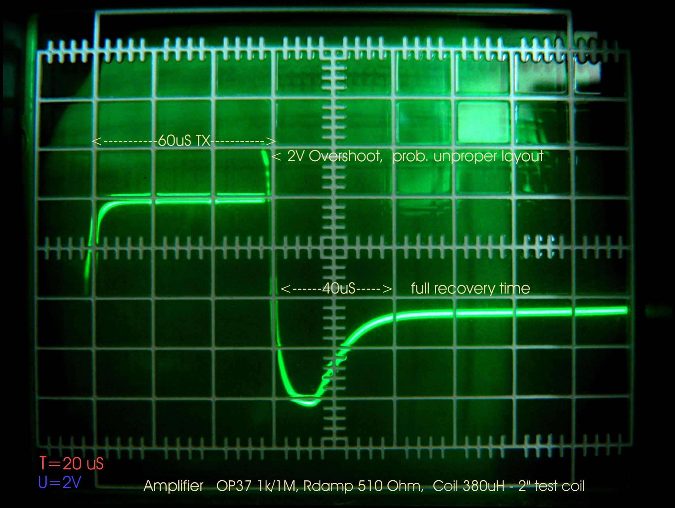

                    Probably LF357 are relabeled TL071, to long recovery time.
                    Here is mine, with OP37
Name:	DSCN6642_surf amplifier output.jpg

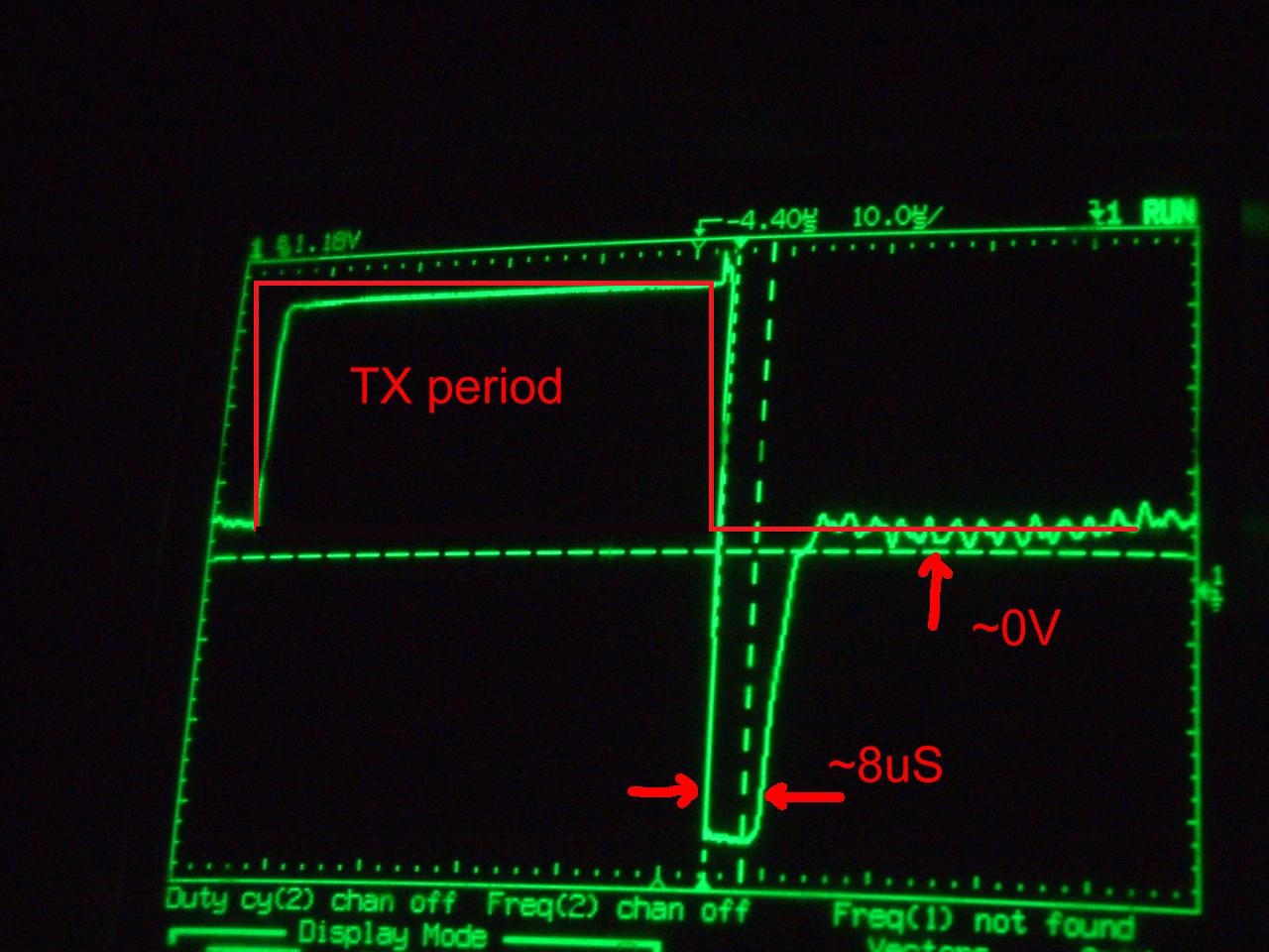

                      Sorry what do you mean by "my surf preamp"...?!! Which pin do u track?
                        pin 6, preamp out, where are you taking your wave forms ? and dont forget you should be useing a Pfet so negative battery is ground
                          I am using TIP32C and negative supply is my ground. But the signal i showed at the start isn't the pin 6 of the NE5534 . It is the Collector side of the Power Transistor
                            OK Sir, Here is the pin 6 trace for my preamp when coil and dump resistor is connected...and sorry for the first image (Consider me a dump resistor)
                              to my cheap oscilloscope
