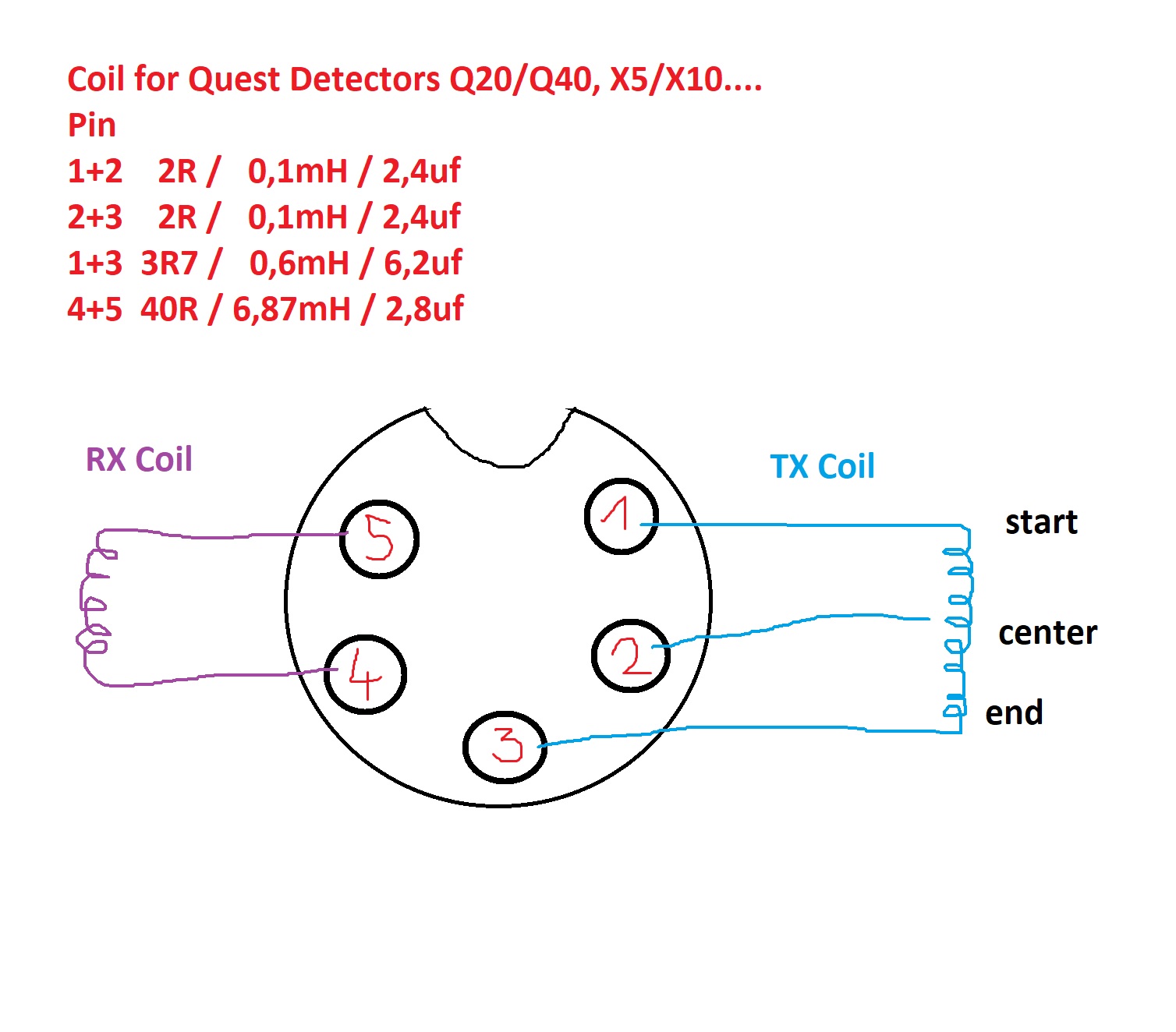

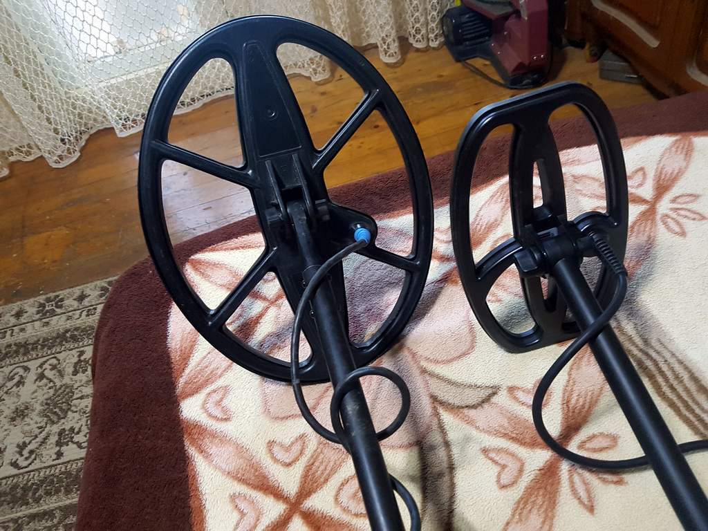

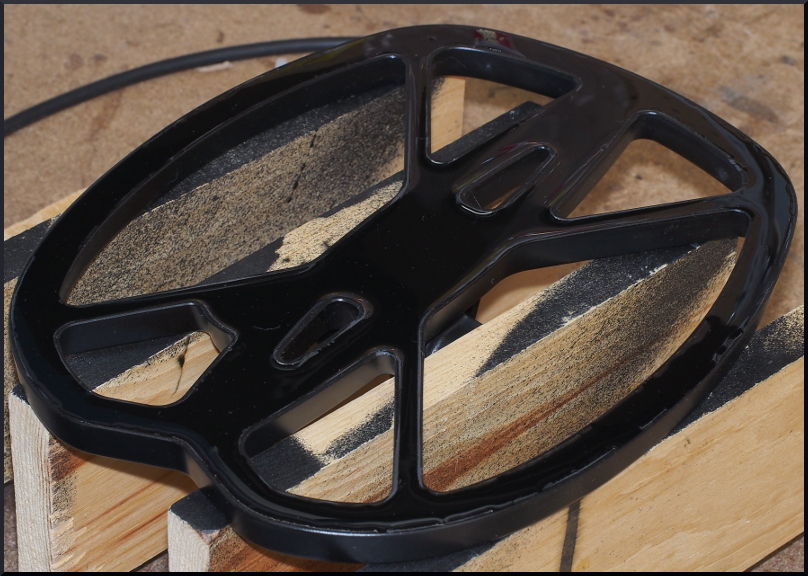

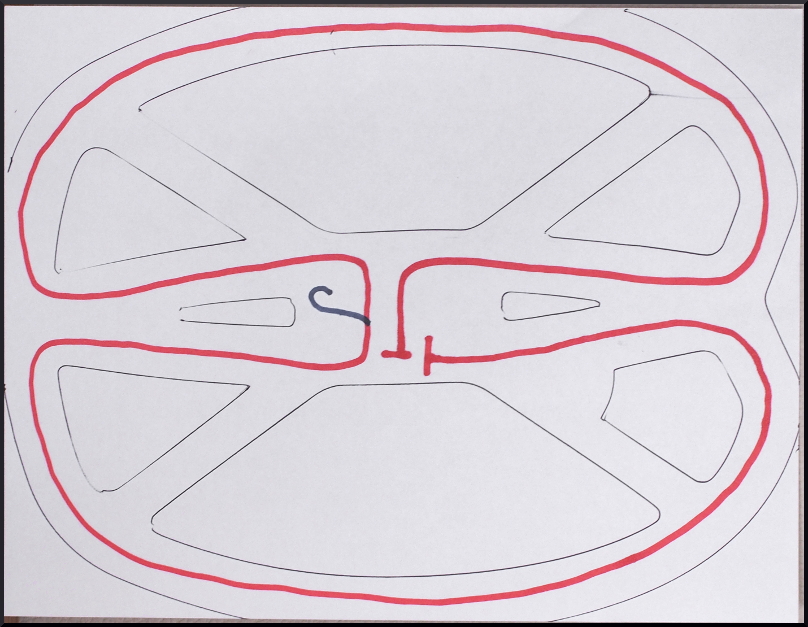

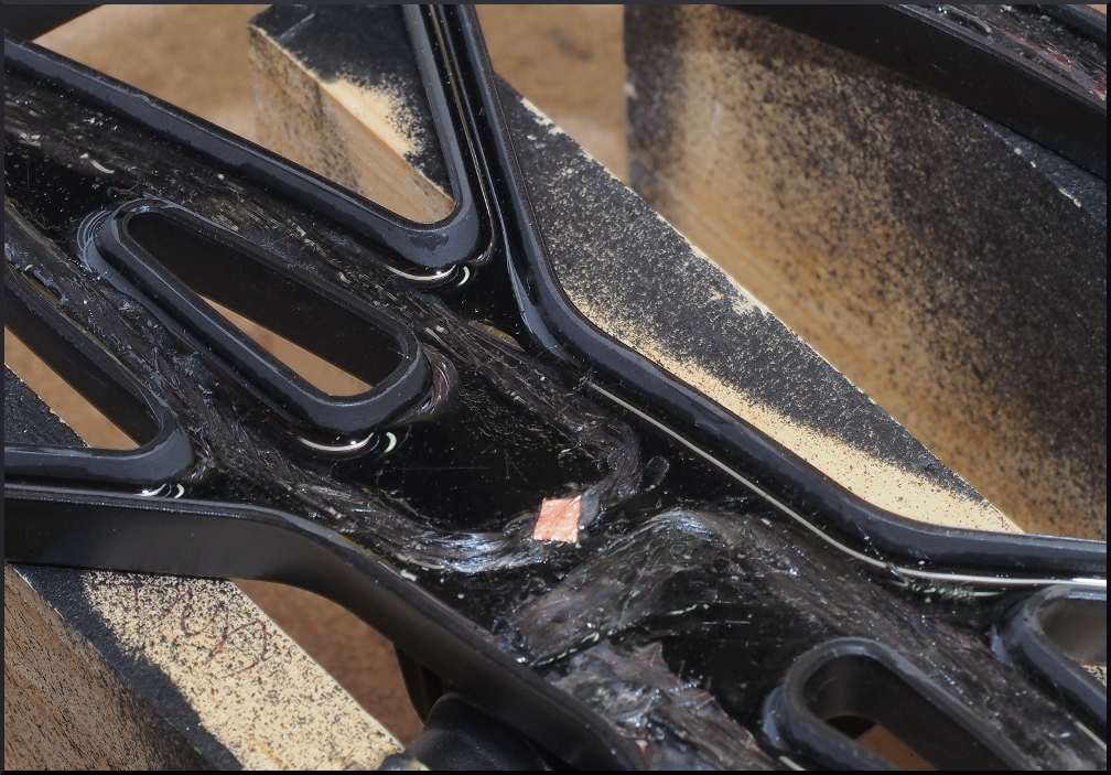

Here ist what i measure for my small elliptical DD coil from my Quest Q20 detector.
Next weeks i will try to build a 35cm round DD coil. The commercial offers for replacement coils for Quest Series is not less.
Most of the third party manufactures have build some models for the Quest detectors, so i should not be a witchcraft.
But i think i can need some info and tips from you all.
For me its not so clear at moment where to shield the coil
