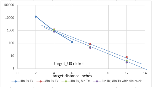

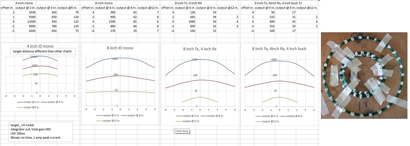

            Charted a test I did awhile back. Mono and concentric with a PI. Been thinking Rx diameter controlled slope. Looks closer to Tx(mono)slope. Not what I was expecting.
            Added chart I posted awhile back.
