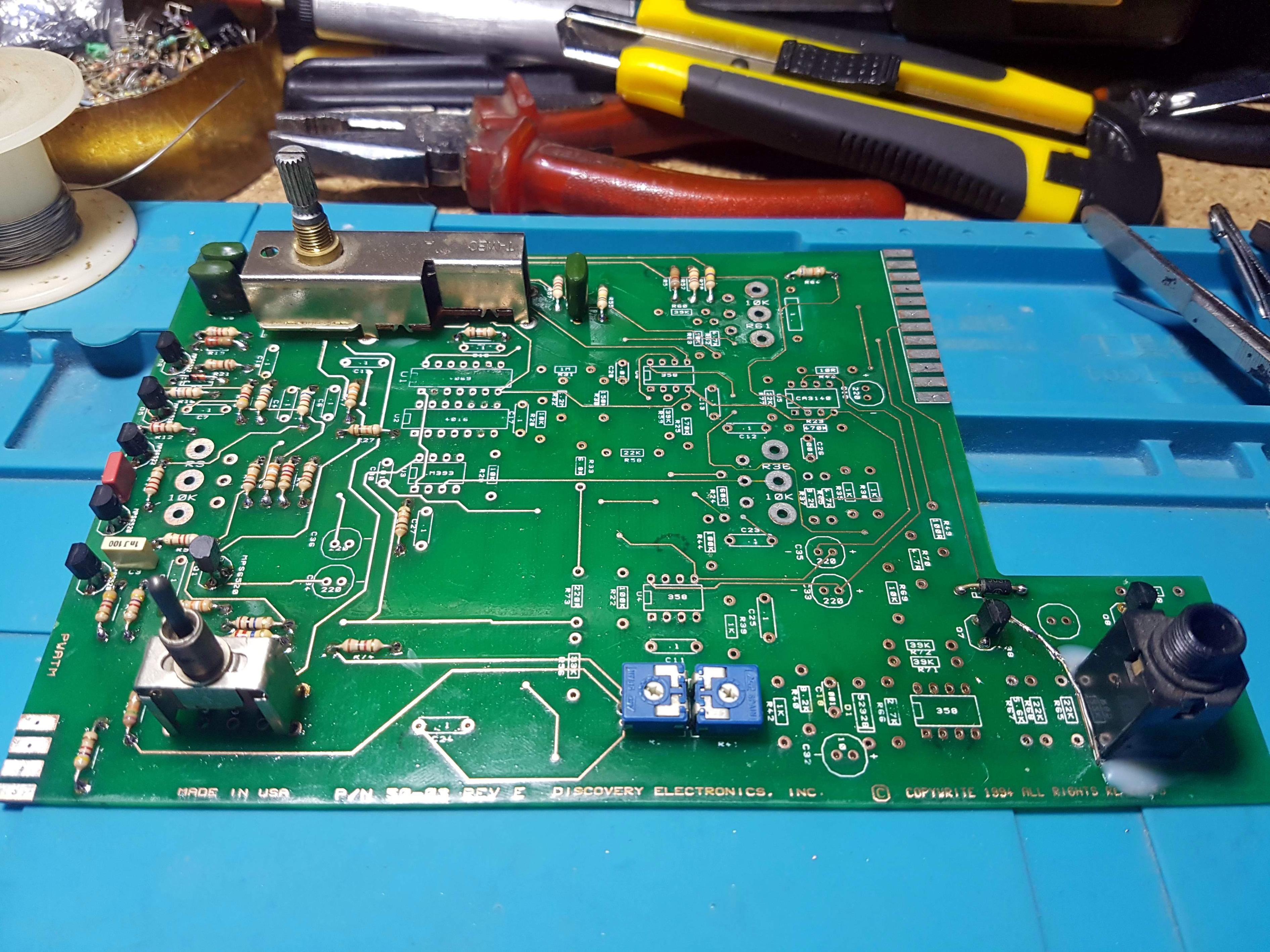

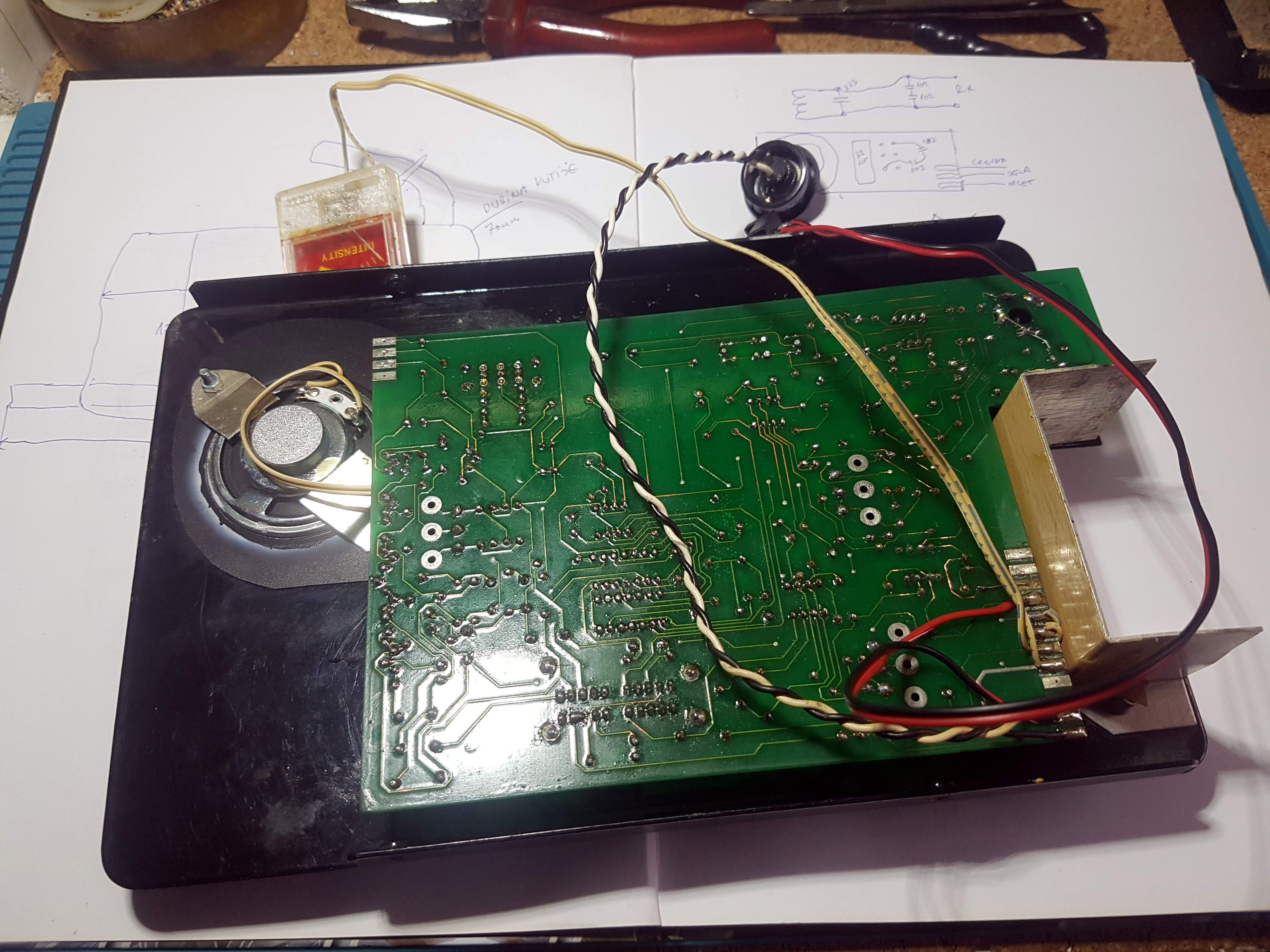

    I have TF900 on the bench for a couple of days.
    It came ruined totally.
    I removed all the components from the pcb.
    Washed pcb in nitro resin and cold water.
    Coated it with rosin diluted in nitro resin.
    Now is shiny and as brand new.
    Scanned both sides.
    Returned back all the good components and replaced bad ones with new ones.
    Without two separate small pcb's TX and RX, switched it On.
    It works, battery meter works nice, loud sound also.
    In other mods all the potentiometers works alright.
    Everything is just fine.
    I gave it a new life.
    But!

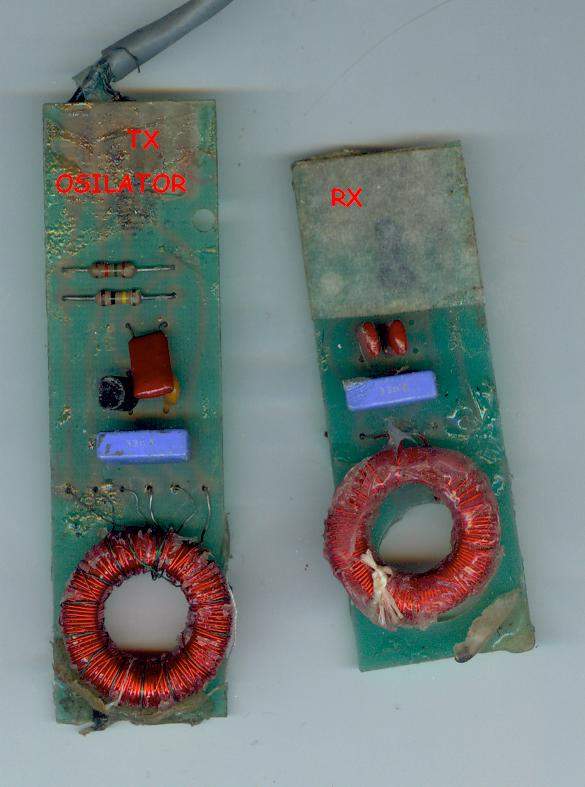

    It came to me only with RX small pcb, TX one was missing and there is no chance to obtain it.
    There are dozen topics in Geotech, dating from the past, that skimly deals with those models.
    There are few schematics also.
    There are numerous pictures and photos of all 3 pcbs.
    Morphology of those two RX and TX pcbs is known.
    Only thing is missing is TX coil specs, according to photos it appears that it conists of least 2 and possible 3 coils wounded on ferrite ring core.
    And that's my problem now.
    I need only that info to complete the detector.

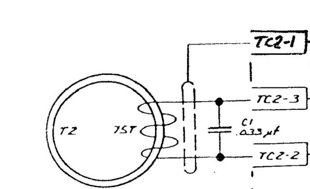

        Not the easiest job to reverse-engineer, but....
        The toroid is powdered iron, not ferrite, probably some high-mu blend like 'number 26' . It will almost certainly be the same toroid as the RX board coil, so you can use that to help find its specification. Measure the inner/outer diameters and thickness as best you can. The colour-code of the toroid is probably little use, unless you know the manufacturer, which you don't ( it will be a US brand, no doubt ). Count the number of turns on the main TX winding, it will be the same as on the RX. Measure the RX inductance. I estimate 16 millihenry. You can now try and work out the spec of the toroid.
        It looks like a single parallel tuning cap mainly across the L , seems to read 33nF. Freq = 6.95 kHz, so L = 16 mH
        This Amidon datasheet has the L calculation formula, and details about the size / iron-blend etc.
        http://www.amidoncorp.com/product_im...-Flyer-v19.pdf
        It looks like the tuning cap is across the main TX ( thicker wire ) and a few turns of the thinner wire ... this may be a way of fine-tuning the L, to get the freq correct.
        I guess the TO92 transistor is bipolar, with middle leg = base, the pcb pads look like they match a TO18.
        I trust this will help you.

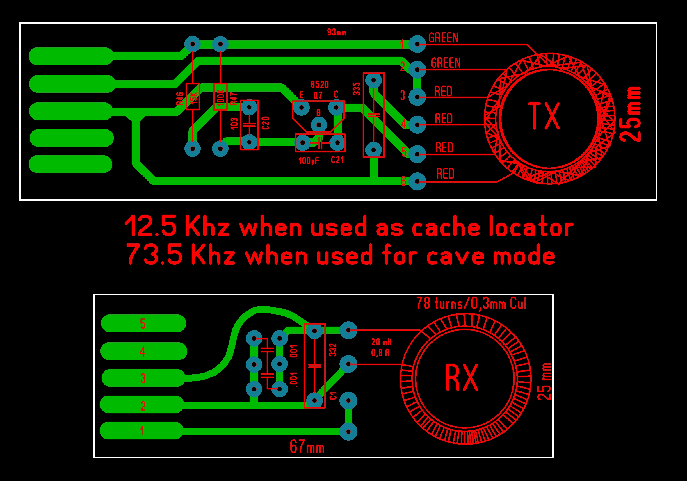

          As you can see; everything is already known except the coil setup at TX board.
            The RX coil specs are written by somebody else from before.
            Not matching exactly with what I measured now at RX.
            Now i am measuring 0.7 ohms / 13mH.

              Yes the toroids are probably the same on both pcbs.
              I have only RX board and toroid on it with bulky wires wounded on it. I measured approx. 25.5mm diameter of the toroid. So let's say it is 25mm.
              You are close, it is 13mH.
              I was hoping to get two identical ferrite toroids (now i know there is also powered iron type, so am not sure if I can obtain such) and to use them as cores in my maybe next diy of this TF900.

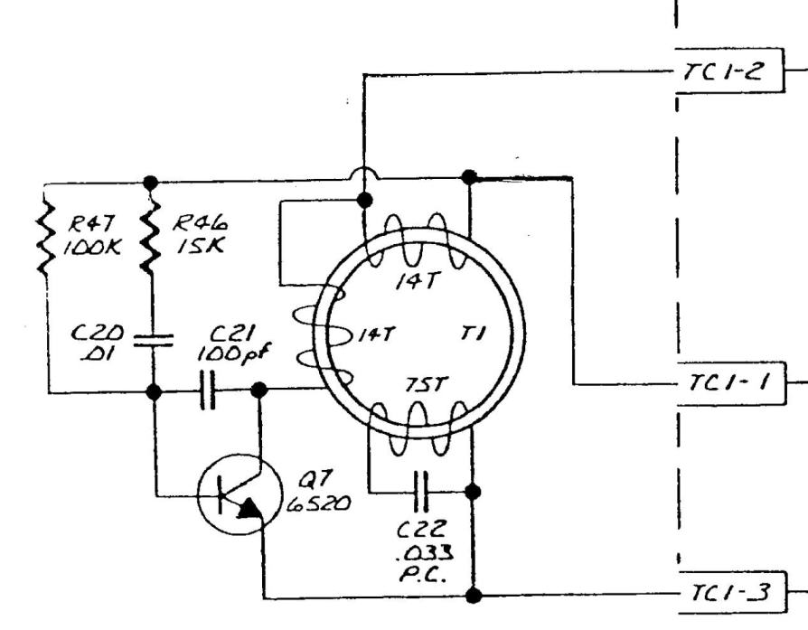

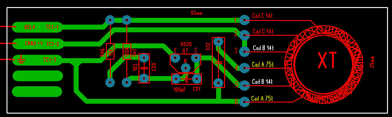

                  So ... RX measures 13 mH, combined with 33nF gives freq tuned to 7.7 kHz. Additional PCB pads allow extra caps to be added to fine-tune the RX tuning lower in freq. How much I don't know ... could be exactly matching the TX, or could be intentionally offset, like in many VLF schemes. You would need 40 nF to get exactly 6.95 kHz tuning, that is 7 nF extra capacitance, seems like it's only meant to be one or two extra nanofarads, to lower freq tuning by 100 or 200 Hz.
                  TX PCB drawing has many errors, including the transformer wire connections. The thick wire will go between pads 3 and 6. The larger of the two thin-wire windings ( 20 turns maybe ? ) will be between pads 1 and 5 - this is the feedback winding ( in the collector circuit ). The small ( few turns ) thin-wire winding I think is in series with the ~80T, so from pad 2 to pad 4.
                  If the transistor is a 2N6520, then it's a pnp device. This tells me the power supply is: +ve to finger 1; 0V to finger 2; output from finger 3. You can test this out by examining the main PCB ? One photo of the TX shows a two-core screened cable, the screen goes to finger2, backing up my idea.
                  It's a simple enough circuit that it can be breadboarded on some scrap PCB / perfboard / veroboard etc
                  I wish I knew a simple way to distinguish powdered iron cores from ferrite ones.
                    I've just tried some maths out, using the Amidon guide. It seems you are needing very high u values to get 13 mH from just 80 Turns, maybe u = 5000 ?
                    This means it must be ferrite, as powdered-iron is limited to u below 500, I think.
                    So for example choosing core size FT-114, with ferrite type of '75' or 'J' will give an AL = 3170 mH/1000 T
                    So Turns = 1000 * sqrt ( 13 / 3170 ) = 64 turns.
                    Not really close to 80T, but in the right sort of zone.
                    So try Type 'F' material : then the FT-114 core has AL = 1902 mH / 1000T
                    Turns = 1000 * sqrt ( 13 / 1902 ) = 83 Turns. This is pretty close, looks promising.
                    Type 43 material is pretty common, but finding the high-mu stuff is hard. Here is a Type 'J', from USA:

                        You really need to define exactly what size the toroid is, then see of there are alternatives. The hole in the middle is the important bit -- too small and the TX loop will not fit, of course.
                        Depends on the exact toroid dimensions... your math is pretty correct!
                        Now... prepare not to explode when I add few sentences more... sit down, calm down, have a cigar, have a drink and listen to this:
                        I AM SO BLIND!!!!
                        Number of turns are already given into schematic that i have!!!
                        Shhhhhheeeeeeeeeeeeeeeeeessshhhhhhh!
                        How could I miss that!?
                          Now I only need to pick the right wire gauge...
                          and find the same toroid...
                            So, pcb is correct.
                            Here is how it goes:
Name:	TX coil solved.jpg

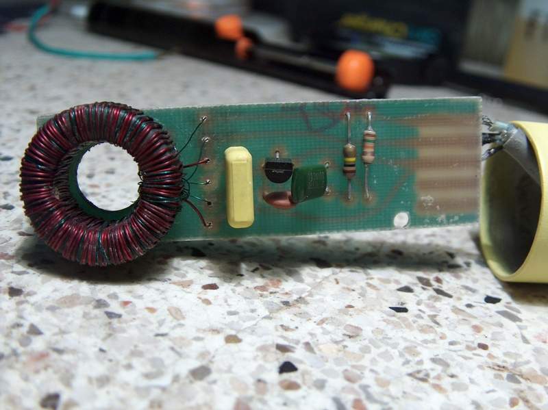

                              No, completely wrong, I think.. Re-read my post.
                              Look at the photos of the TX board - see where the thick wires go. You have the power supply conected directly to a short circuit, ffs. And you have it reversed. It's a PNP bipolar transistor, the emitter goes to the +ve supply, the collector to the -ve supply.
                              Are there any other '6520' transistors on the main board ? That way you can find out if it's pnp or npn. Edit, yes there is, it's an MPS6520, which is npn, that's one problem solved.
                              Got to say, the two photos of the TX board show completely different wiring of the toroid. Confusing.
