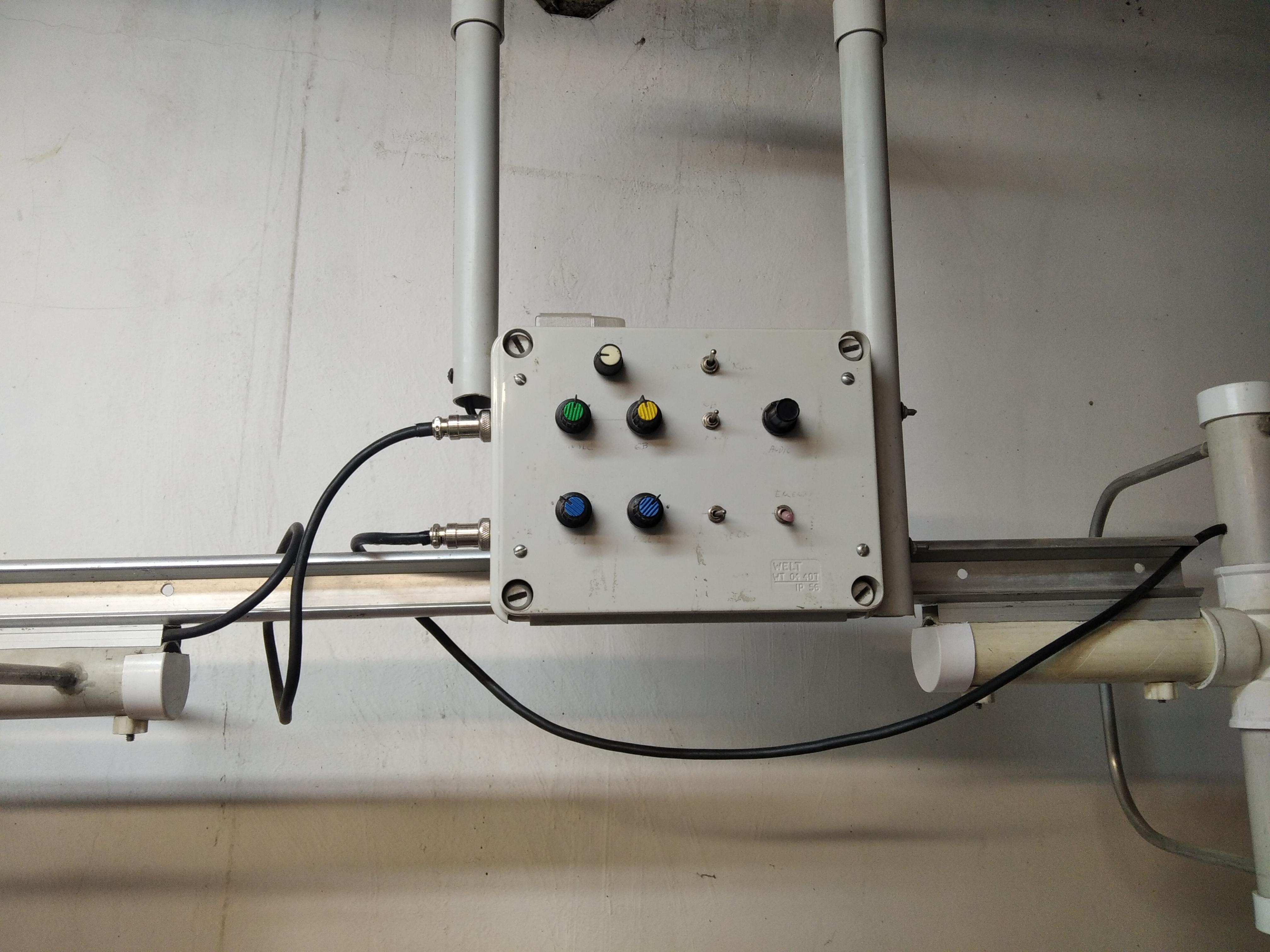

          I built this detector a few years ago with the schematic published in this forum, I used ferrite toroids that I found at hand, even the TX and RX are different. I make the coils as indicated in the diagram, the RX tuning was done by adding capacitors in parallel.
          The final frequency was 12.8 kc and it is necessary that the aluminum antenna is inside the toroid and short-circuited, otherwise the frequency is very different, the size of the antenna also influences the frequency
          The selector key was replaced by separate reversing keys.
          Mechanical rigidity is important and so are the contacts where the aluminum antenna closes.
          Do not delve into the theoretical knowledge of this detector, only some tests were done, but it seems to work well.

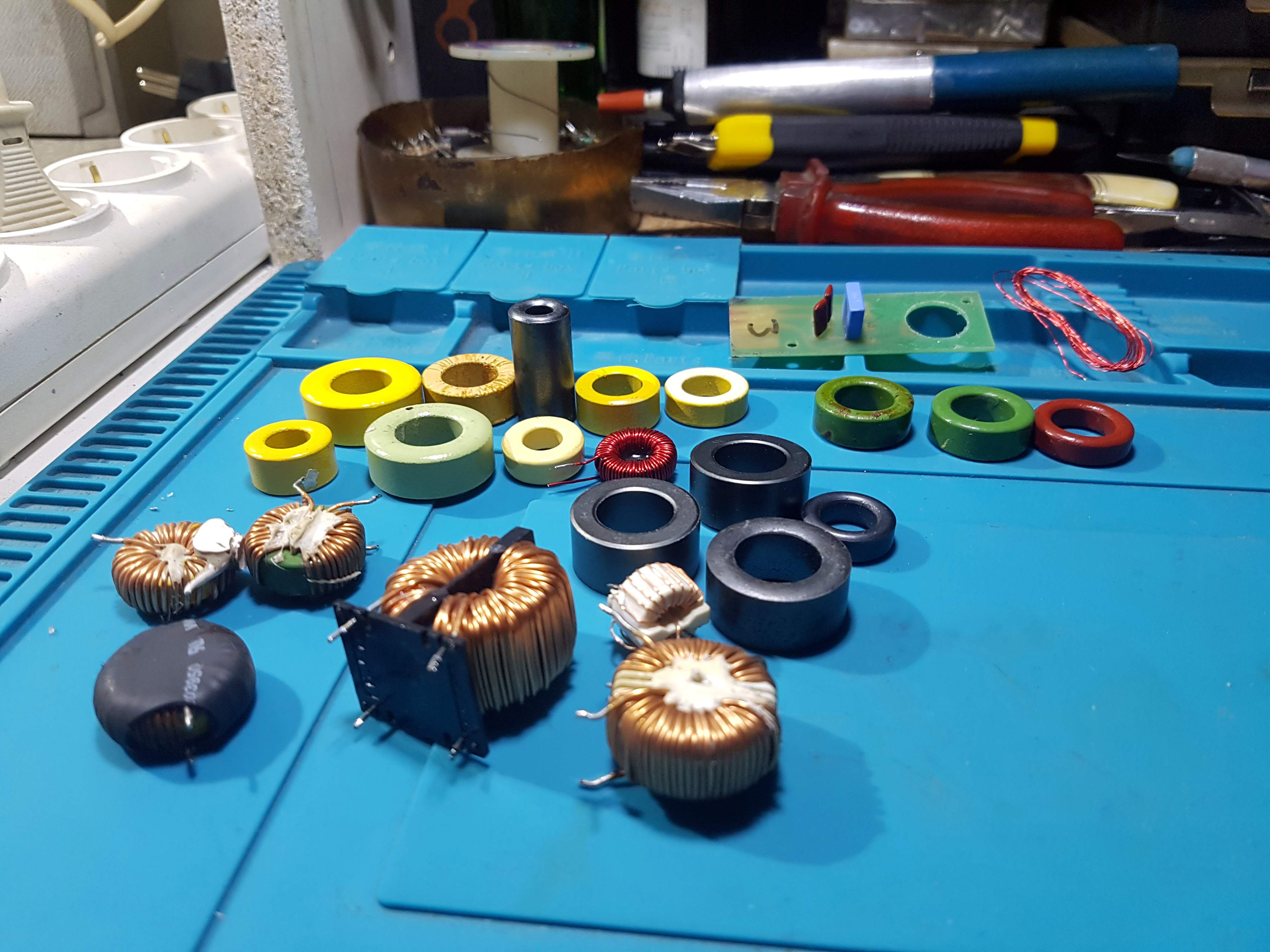

                  You probably won't believe me, but until a few months ago I had a large metal bucket in the attic, full of ferrites,
                  toroids, various chokes ... but most of these torus rings.
                  A lot has been collected in over 30 years of work.
                  I was sorry to throw up.
                  And then all of a sudden, I don't know what the hell was wrong with me; I decided in vain to clean the ceiling and I
                  could hardly take that bucket to the dump because it weighed over 70kg!
                  And now that I remember that ... I would kill myself!
                  Now I start again from the beginning, I collect pieces of electronics from waste, in search of such toroids ...
                    It's a good idea to seperate them by 'category' when salvaging them, or even individually label them, if you can be bothered. That help identify their future re-use. For example one from a known 50 kHz SMPSU circuit will be different to one from a radio-frequency power amplifier ( balun ), and interference-suppression types are different again. Be wary of those used in common-mode interference filters, often green painted. They are weird things, usually very-high u ferrite, that is lossy, even at a few kHz. They give unexpected results when swept over a detector.
                    Apparently one way to distinguish powdered-iron cores is : scrape them hard with a sturdy knife, they will start to scratch up, and small bits can be removed. Whereas ferrite is too rock hard, and you will just get a blunt knife blade.
                    The method I mentioned previously, where any u over 500 means it is ferrite is also true. Most powdered iron / permalloy etc blends have u below 200.
