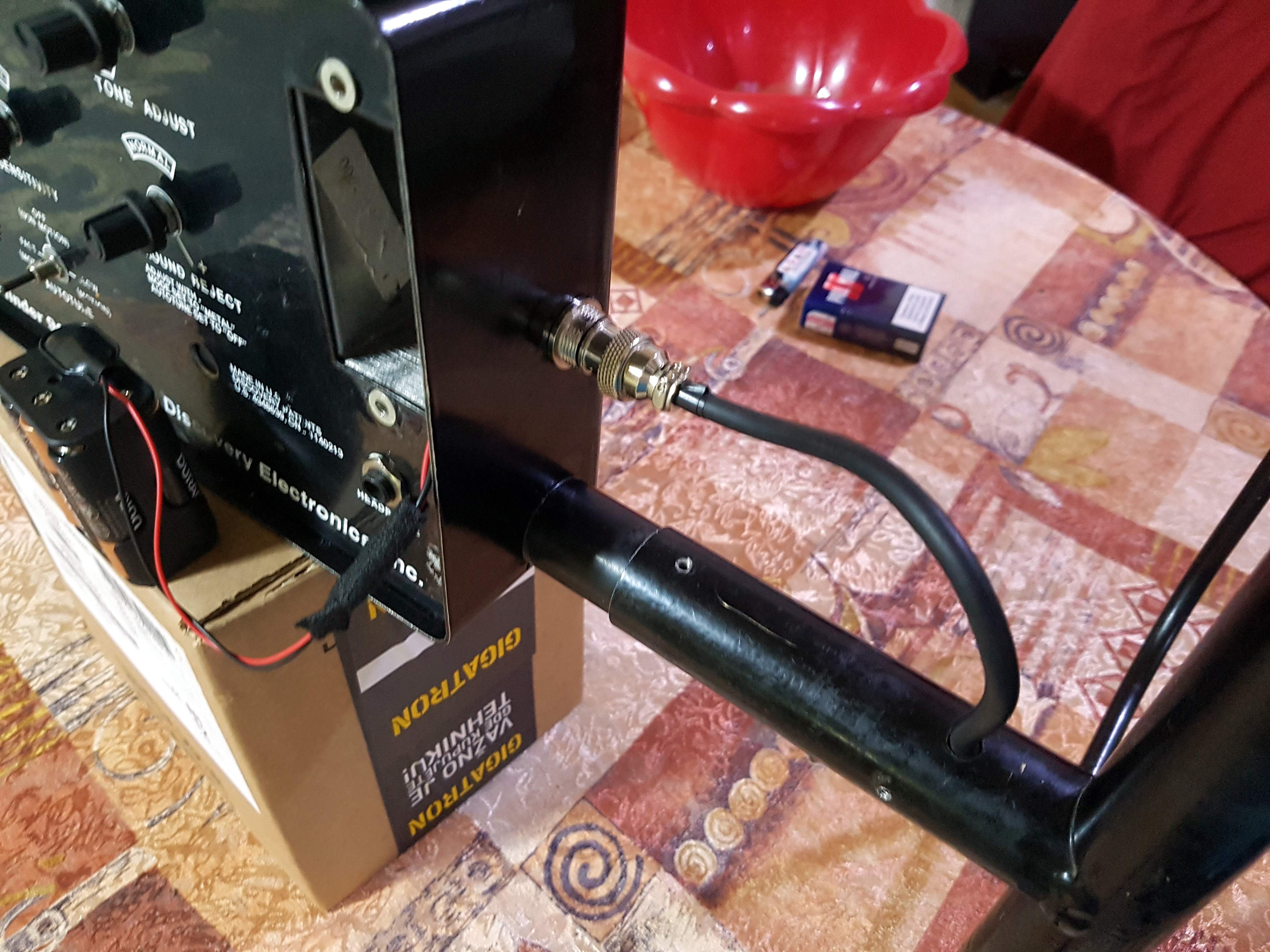

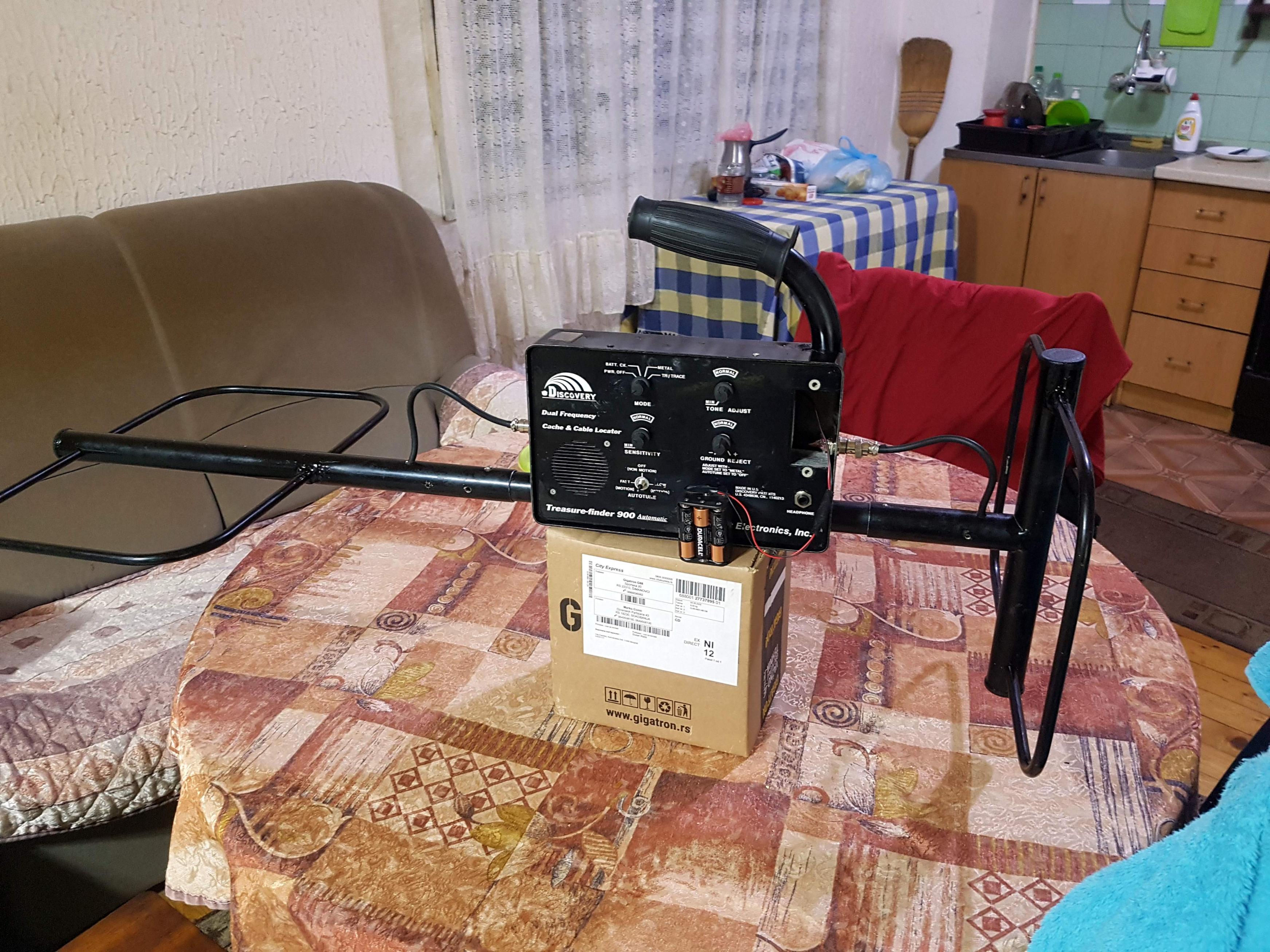

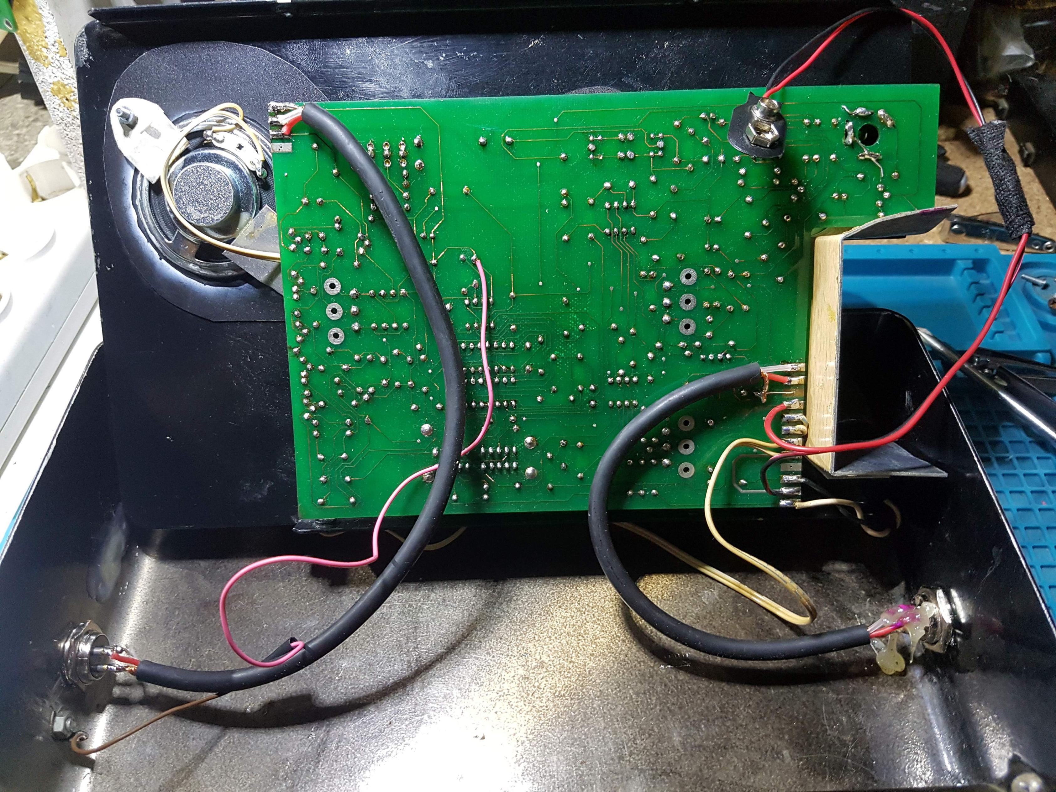

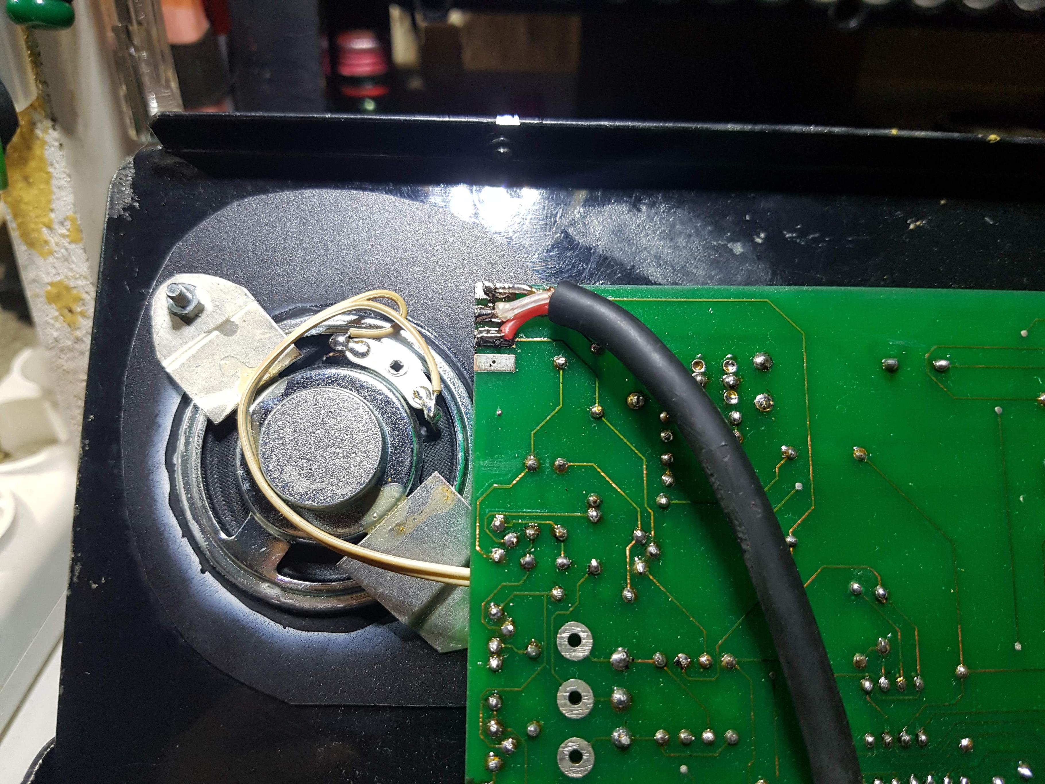

                    Finalizing few small details and wraping it up, it's done.

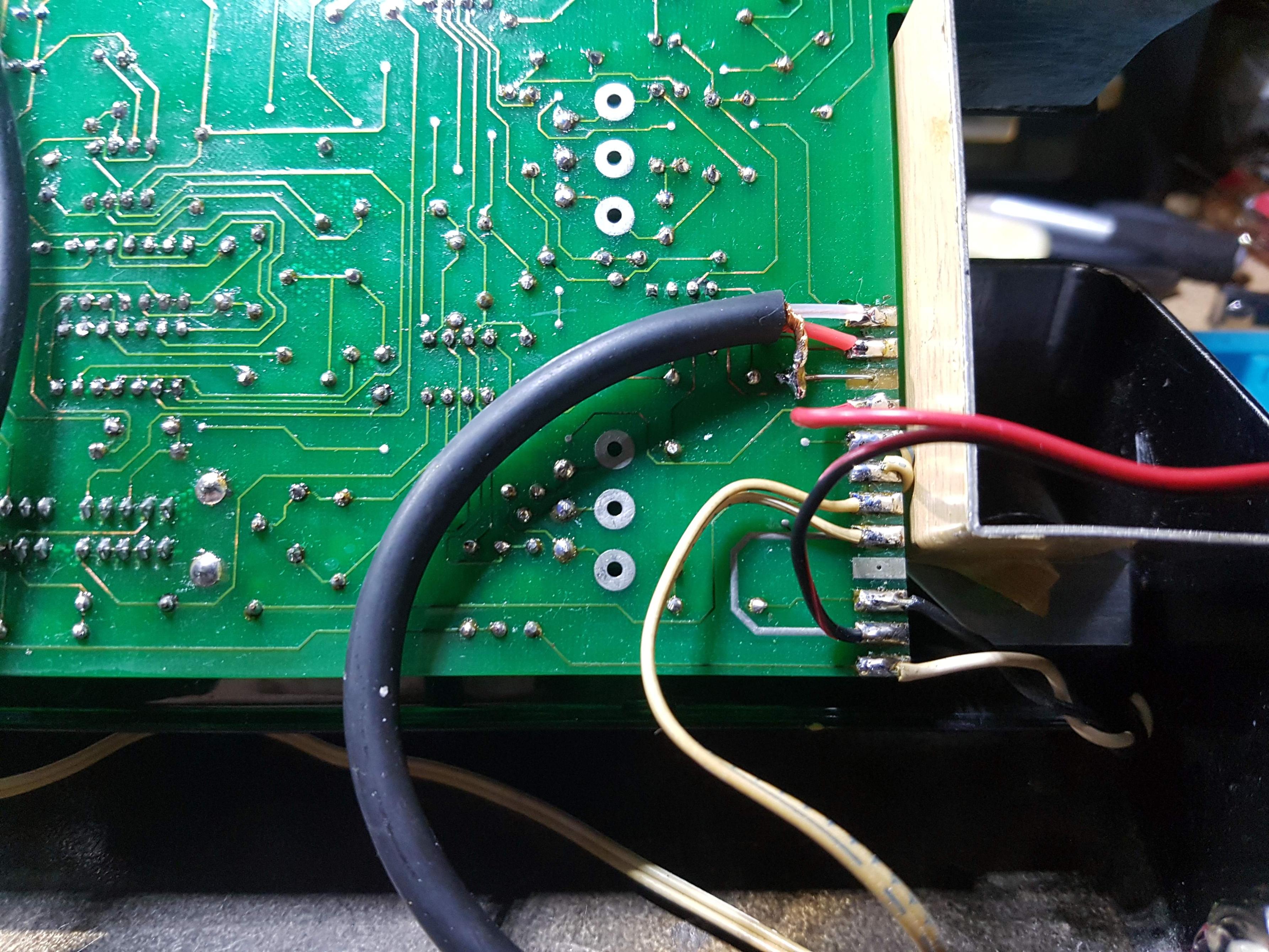

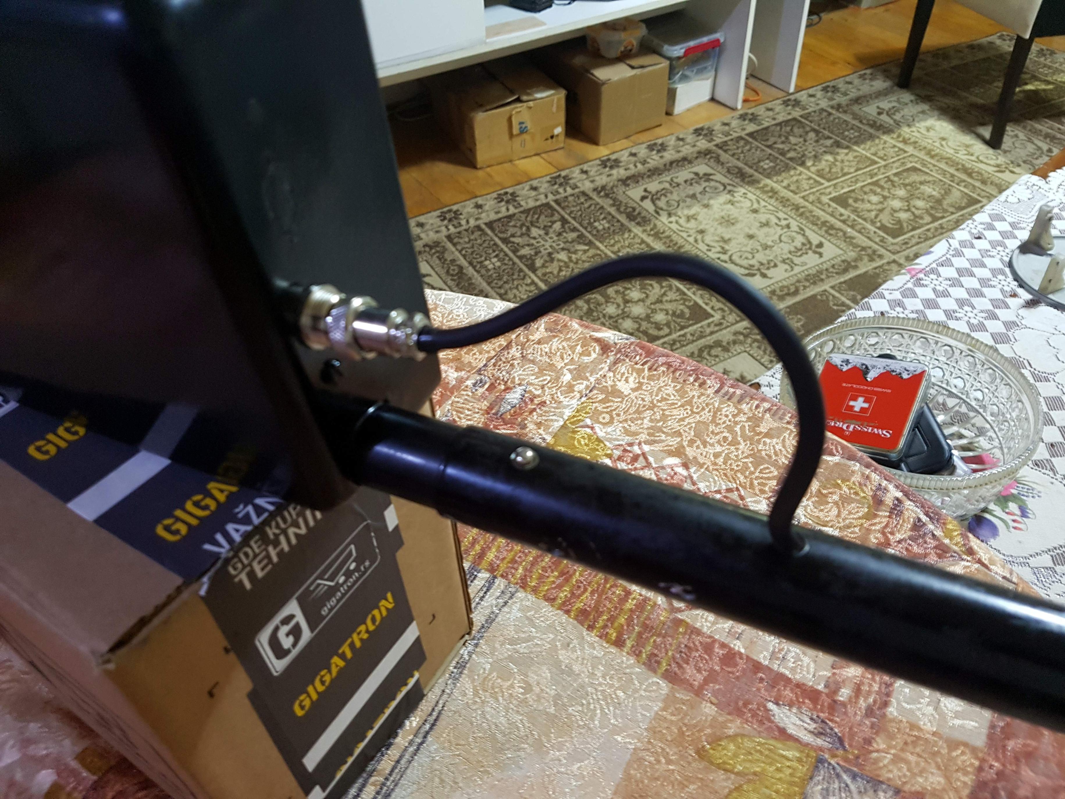

                    • Skippy you cursed me! I just put it all together and closed it, the first time, I turn it on... and it works "upside down"! So I had to open everything up again and swap the wires on the RX!
                      I have to take care not to mess with you in the future!

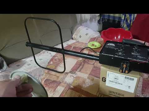

                        • Nice to see it all working. That 'upside down' mode could be useful for finding caches of highwayman money hidden in trees!
                          Do you have any way of properly testing out it's performance, for example comparing its depth with another two-box machine on some 'standard' targets ?
                          I am a bit concerned that the use of those green toroids may have lowered its performance. Also, we don't know if the RX and TX should be carefully tuned to the same frequency ( by adding capacitors / or adding/removing wire turns from a toroid ), or intentionally de-tuned by a precise amount. So there may be ways to get more out of this machine.
                          Did you measure the transmitter frequency ? I was curious about how much the big TX loop would affect things. The L and C tuning components suggested a higher frequency than the specification of the complete detector.

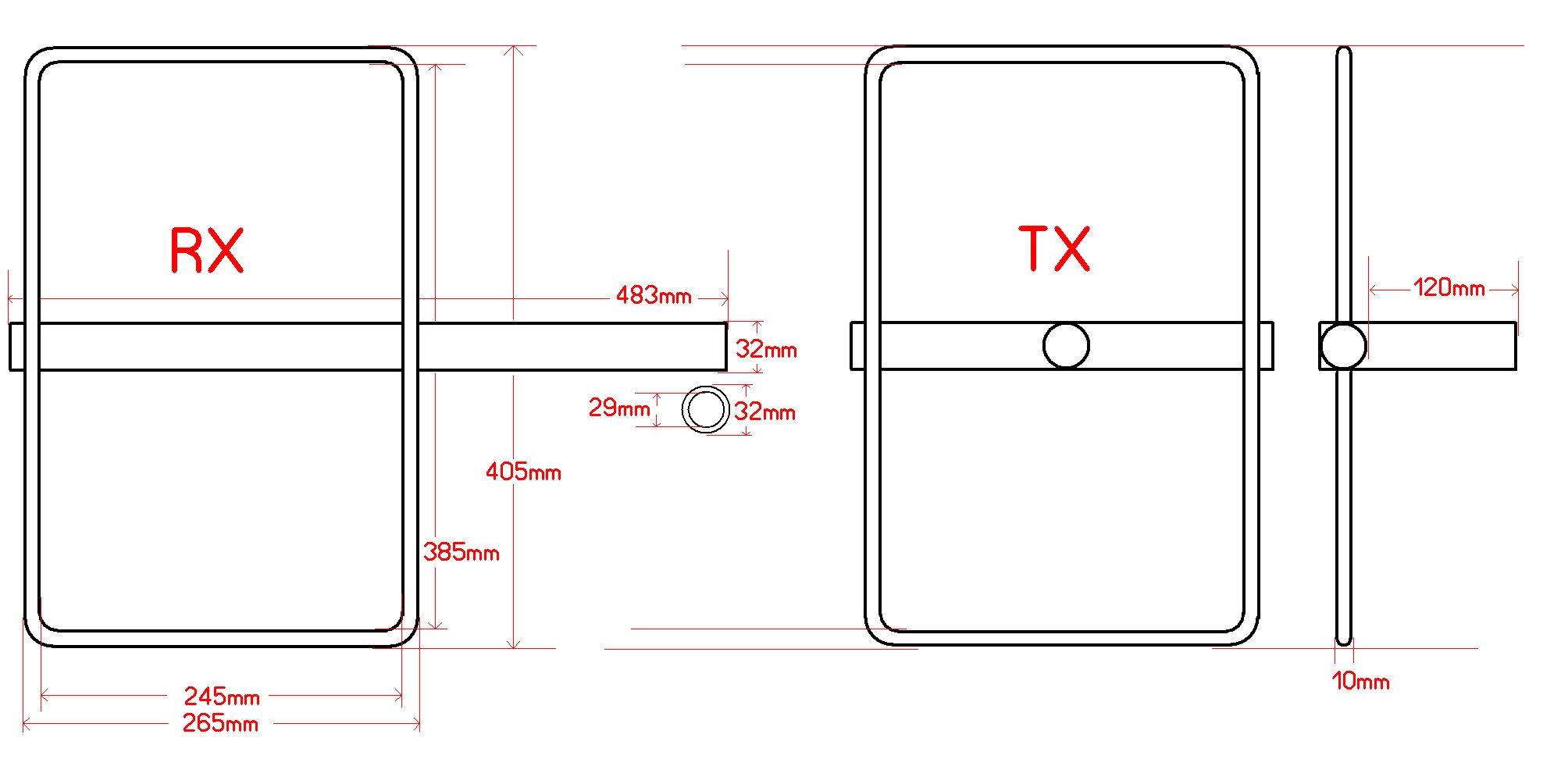

                          If you have time, it would be appreciated if you could tell me the dimensions of the antennas, and the spacing apart of them. They look slightly rectangular in the photo? This would be useful when I eventually try my maths simulation of a two-box.

                            I don't have the conditions right now. This is the worst time of the year to go out in the field. Infernal heat and highly elevated radiation.
                            I go down to town to get groceries, for half an hour... and then I feel bad all day. So I avoid going outside when it's hot like this.
                            Something is wrong with the climate, something has been changing drastically for the past few years. These aren't the summers they used to be.
                            So I can only evaluate the performance of the detector based on my rich experience. I had a TM-808 (two pieces spanning 20 years), a Fisher Gemini II,
                            a couple of older 2boxes whose names I can't remember...
                            And I still have a Garrett Master Hunter with 2box assembly in the attic (albeit broken).
                            Based on all that has been said; I would say that this TF900 works very correctly.
                            That's why my tests are not detailed, but I made a video just to show that it works.
                            In room conditions, it is impossible to test the detector well, especially not the 2box.
                            I have hand drawn sketches of the dimensions, I will transfer it to some program and draw it to make it better. Then post here.
                            The frequency is 12.xx kHz.
                            You may have missed a detail when I wrote that I measured and cut two 100% identical pieces of wire. Then wound both on both green toroids.
                            It is crucial.
                            It is important that those two LC tanks have as similar a resonance as possible.
                            Everything else is less important.
                            And the frequency is determined by those 2x14 windings.
                            In this case they are 2x12 because the greens are a little taller than the originals.
                            I will post the dimensions a little later.
