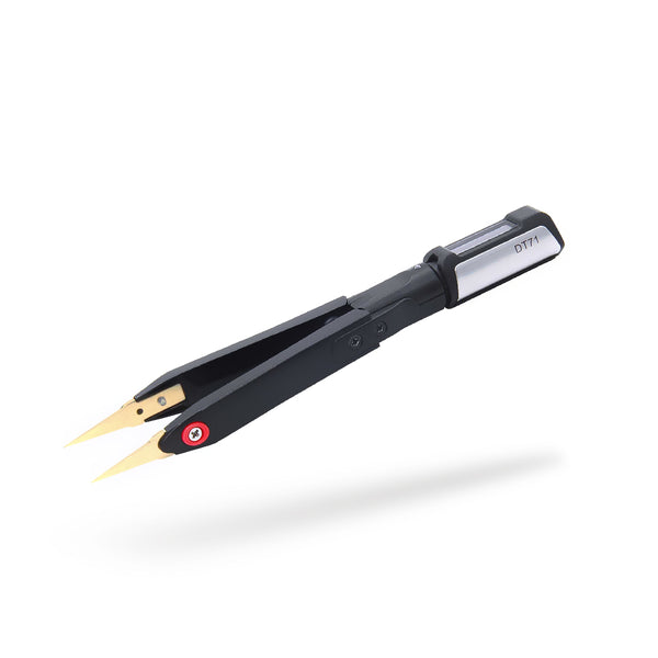

              can you give a link on your tester? also, what its range you measure in?
                https://www.sainsmart.com/products/d...nSmart+Catalog
                They are pretty much automatic.
                Continuity I used a regular meter.
