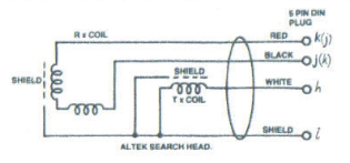

    HI ALL
    HOW I MAKE SEARCH COIL FOR ETI 1500 METAL DETECTOR.
    THANKS ALREADY..
    HELP ME PLEASE(COIL)
    HELP ME PLEASE....
    HOW I MAKE COIL, AT THIS SCHEME.( FOR ETI PROJECT 1500)
    (VLF/TR MODE). WHICH COIL TYPE MUST I USE.
      ETI 1500 COIL
      Rx: 50 ohms Tx: 12 ohms ,I think The form of coil same like MAGNUM

        hi salih
        I'm trying to build eti 1500 , but I have some problems with connection of SW1 and SW2
          It is one of the more complex detector projects that has been published, and includes a VLF ground-canceling mode, and a TR-discriminate mode.
          The coil info seems to be missing
          http://www.geotech1.com/pages/metdet...ti1500_300.pdf
          The switch connections are easy
          the drawing shows the physical
          or mechanical operation and has 3 banks of contacts
          and 4 positions
          as you rotate the switch
          the next contact will make, its an oak switch
            thanks...,I got your point, that was very helpful,now I can go forward.

              According Russian collegues, the ETI project 1500 operates well with Magnum coil and can detect gold nuggets because operating frequency is enough high (15 - 20 kHz).
