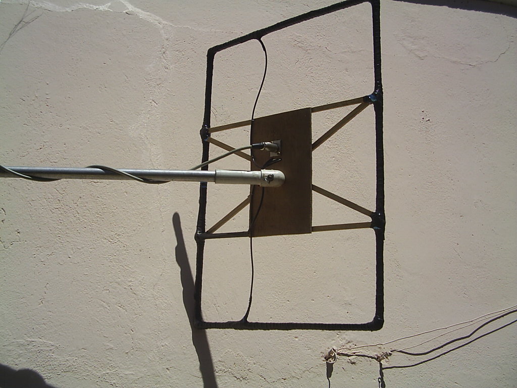

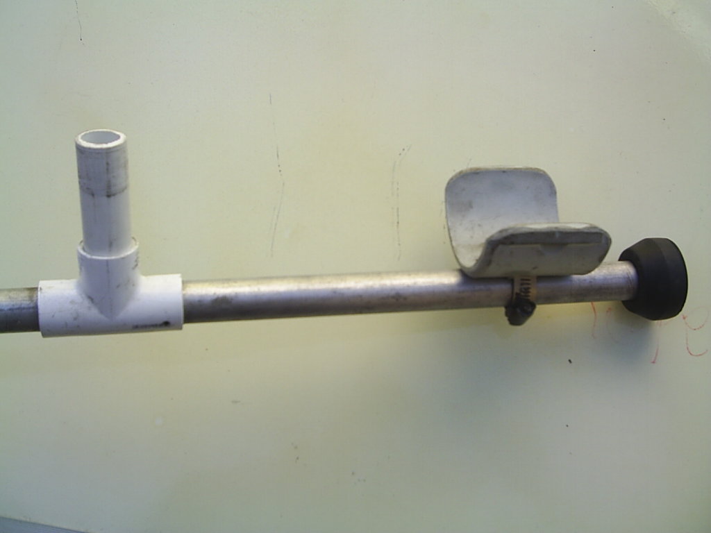

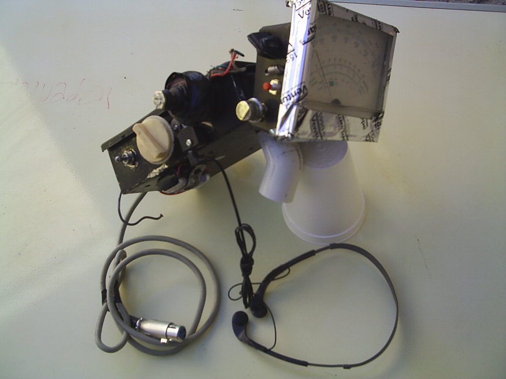

                      my bfo structure in pictures
                      friends of group, these is my bfo what i build, whit coil induction of 60x40 cms , have two rounds of aluminium tape , i not is suffcient,is quad coil , and some modifications of internal circuits, my problem is the excesive trouble of reactions of ground capacitance, is very sensitive and i can,t one shield efective, no sucess whit tape aluminium, no sucess whit secundary paralell coil, i nedd one efficient shield of yours experiencie
                      aqui les presento las estructuras de mi bfo que yo modifique, el bfo tiene cambios en el circuito tanto de grandes capacitores, como de blindaje, y de manipulaciones en la bobina de referencia, la bobina de rastreo fue embobinada sin la precaucion de contarle las vueltas del alambre, y basandome solo en equilibrar el enrollado de la bobina de referencia, y le fue puesto un marcador muy sensible, afortunadamente el bfo eficiente, solo la extrema sensibilidad al cambiarle en otras oscilaciones por medio de resistencias, pero en baja sensibilidad si actua el shield de aluminio
                      espero alguien tenga un tip eficiente para estabilizarle en alta oscilacion
                      un saludo a todos
                      detectoman mexico
                        I did not quite understand your problem. You may expecting to much from this detector, and the benefits of the faraday shielding. This is a BFO design and it will always drift a bit. Your big coil will be very sensitive to temperature changes and this will make the detector drift. This will not change by fitting Faraday shield. Also the beat note will alter as you raise and lower the coil to the ground, and a Faraday shield will make little improvement to this. The faraday shield will stop effects of wet grass ect. I must say I envy the excitment you must be getting from messing about with this. I wish I could go back and do this again. Digger
                          If you want Stability on searching the ground for objects, and Probably even better sensitivity, I would suggest you build a PI type Detector.

                            I agree with digger_barns and chemelec. Now you've spent some useful time investigating the capabilities of a BFO, forget about it and build something else. BFOs are nowadays only considered as toys. Their main problems are instability, drift and lack of sensitivity. If you're detecting in the river, then a P.I. detector would be a good choice.
