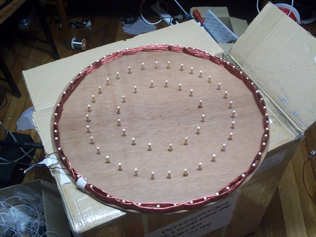

                      Building coil for ML SD2000, ended up too good
                      I'll relate the outcome of a coil building experience I had for a 12.5 inch mono designed specifically for the SD2000 I normally use. I have been building mono coils for many years and I have inproved them considerably. Some of the earlier coils were not the best.
                      Now back to the 12.5 inch mono and how I fabricate the coil. I use Litz wire but make the wire myself to my requirements. I use enamelled copper wire (0.2mm) and once the litz is complete, sheath the overall litz with a cotton layer. This is worth the effort as it reduces the intercapacitance effects within the coil. The coil is wound using a former. I start the first layer with 4 turns, then a thin cardboard strip is placed over this layer to form the continuation of the next round of 4 turns and so forth until the total turns have been wound. Each group of 4 has a thin cardboard spacer between the layers.
                      Once the coil is wound I then varnish the coil whilst in the former. The coil ends up as a rectangular flat coil with dimensions approx 15 mm x 9 mm and 12 inches in diameter.
                      Some specifications of the coil.
                      Self resonance is approx : 1 Mhz
                      Q of coil : 4.9
                      Inductance : 300 mico henries
                      DC resistance : approx 0.3 to 0.4 ohms
                      Once the varnish is dry I place a PE spiral wrap over the coil as a separation for the screen. The screen is then wound over the complete coil assembly.
                      Some more coil data.
                      Self resonance with screen is approx: 780 Mhz
                      Capacitance between coil + screen: 280 Pf
                      I then used a low capacitance lead 1.3 meters long of approx 67 Pf to complete the coil.
                      Almost final coil parameters
                      Self resonance of coil with screen + coil lead: 660 Pf
                      Q of coil: 4.5
                      After finishing the coil I gave it a field test at a small goldfield approx 200 Kms from home. I found a few nuggets and the coil was certainly sensitive to small nuggets but the ground balance drove me crazy. The ground where I live in W. Australia is highly mineralized. The continual ground balance signal changes made it difficult to detect and gave many false readings .
                      On return to home I had to desensitize the coil to make it user friendly. I did this by replacing the coax lead with one with a slightly higher capacitance and smaller diam inner core.
                      Final coil parameters
                      Self resonance of coil: 570 Mhz
                      Q: 4.3
                      Now a very good coil.
                      So in one sense I had made the coil too sensitive for the SD2000. I also tried the sensitive coil on my SD2200D which has automatic ground balancing again it was difficult to use.
                      Really if you are making coils for a specific metal detector keep within the broad specification required for that detector seeking of course the max sensitivity you can get away with. Matching coil to detector is a must.
                      Looking at the information from many other readers on the forum there are many ways to build successful coils. I hope this information will be of use to others
                      Stefan
