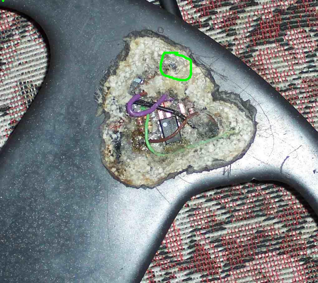

    The capacitor, in a green circle , is not work, closes on the ground.
    Change it with any small polypropilene capacitor with AC voltage range of at least 50V.
      Result:

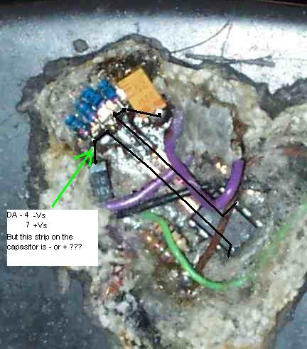

      After replacement of the capacitor the coil works perfectly.
      I always considered that the strip on the capacitor is plus. The black capacitor has been established so initially.
