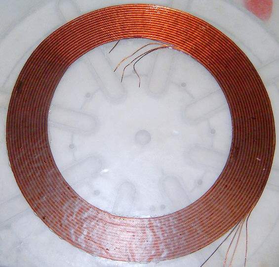

                Hows this for a Coil? Just Expermenting!
                4 Wires, A Double Tesla Coil.
                  Now, Having Finished this coil:
                  8.1 inches in OD.
                  Total is 36 Turns of 26 AWG.
                  Coil Width is .8 inches.
                  Mean Radius is 3.65 inches
                  Inductance is 461 uH.
                  Doing Tests with this coil on my Pi Detector, it detects my gold ring at 12 inches and it detects a 6.5 inch diameter Paint Can Lid at 27 Inches.
                    8.1 inches in OD.

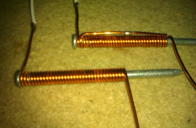

                          Mythbusting

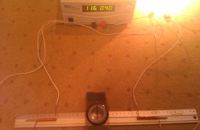

                          There's a lot of mythology surrounding Mr. Tesla, and researching this patented coil I've come across some fantastical claims. One that seems to crop up the most often is that the bifilar winding generates a greater magnetic flux for the same Ampere Turns all else being equal. That's an extraordinary claim that Tesla himself never made, as far as I'm aware, and it will be trivial to confirm or deny.
                          My mythbuster setup consists of two near identical 50 turn air-cored solenoid windings (the one on the right is bifilar wound as per the patent, and the one on the left is conventionally wound). These are connected in series to ensure identical current in each (developed from a PSU with a 50Watt halogen lamp as ballast) which I've dialled up to 4Amps. Mechanically they oppose each other on a calibrated track (aluminium ruler) and between them sits a compass. In the absence of the electromagnetic fields, this is aligned to Magnetic North. Now the coils can be moved to their respective nulls; the position where their opposing fields cancel each other out leaving the compass pointing to North.
                          The above picture is with the current off and the whole rig aligned to Magnetic North.
                          Next, with the current on and both coils placed 10cm from the compass, the fields null (as standard physics dictates) so the needle stays where it was. So much for there being a greater flux from the Tesla winding. To prove the methodology, moving either coil upsets the balance - even by just a millimeter. Here the coil on the left is being moved by 10mm.
                          Looks like this particular myth is busted. The coil does still have useful properties (i.e. the ones Tesla himself claims) but these only emerge in an AC analysis.
                            I'm not really getting what you are trying to say. Are you saying your air coil test samples are wound exactly like the iron core nail samples in your reference?
                            Why not just make the nail samples like your reference, battery supply, and do the compass test with them?
                              bklein,
                              I was trying to eliminate as many variables as possible here - the problem with having an iron core is that it tends to retain it's own magnetic field (Remanence). Maybe this has accounted for people getting different magnetisation from their testing?
                              An iron core in each solenoid would multiply the field (through its higher magnetic permeability) by the same amount (I'm pretty certain) so I think it's one varaiable that can be safely taken out. Not that I won't try it to make sure
                                Yep, the laws of physics are still holding here I had to demagnetise the nails before using this rig - there was a strong pull from both without any current flowing. Again the null is obtained when the electromagnets are equidistant from the compass. A few less turns but a greater flux than before but still the same result - the myth is still busted!
                                I won't be running this again with a battery in case anyone thinks that would make a difference. It probably would - but only because the current would fall as time went on. Maybe this is also why people think the Tesla winding makes a more powerful electromagnet - if they used it first they might indeed be able to pick up more paperclips
