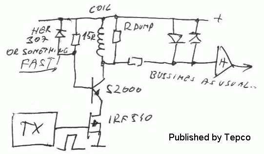

        Tepco, explain please what is the advantage of your cascode TX stage!
            Advantage of this "cascode" circuit is basically to provide higher breakdown voltage switch. Usually, it is hard to find MOSFET whit over 800-900V rating, and typically those devices have high Rds on resistance and large output capacitance. In this way, high voltage bipolar is used, 1.5KV or more capable, and lower Cout. Cascode is just easiest way to drive it.
            And advantage of this is minimizing, or eliminating breakdown condition (pulse width and coil dependent), thus minimizing nonlinear part of circuit behavior, and this will minimize ringdown time and enable faster sampling. (up to 30-40% faster, depending upon conditions) Try this trick and compare results, there will be improvement on almost any machine. Except penalty for higher current consumption, due to high base current requirement for upper NPN (almost comparable to coil current on some detectors).
            And of course, be careful not to blow up something. This will produce 1.5-2KV microsecond peaks, so coil insulation, input and dump resistors (use multiple), protection diodes (1N5819 instead 4148 ) etc have to be considered.

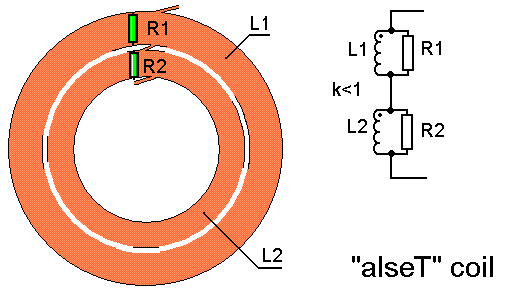

              Alset coil
              Alset coil - the opposite of Tesla coil
              Unlike the Tesla coil having a decreased resonance frequency due to increased stray capacitance, the Alset search coil for PI (see below attached figure) has
              increased resonance frequency. This is due not only by reduced stray capacitance, but by reduced self-inductance.
              Alset coil can be regarded as a flat spiral coil, which are missing several turns in the middle of spiral. In fact, it is made of two flat spiral windings (coils) connected in series. Their connection forms center tap to which we can connect two damping resistors. For critical damping they have greater resistance than a resistor damping the whole coil.
              The coefficient of coupling "k" between two windings is reduced due to the increased distance and different diameters. This leads to reduced self-inductance of search coil.
                Alset as in Tesla spelt backwards? Very funny
                But is it really a goal to reduce self-inductance in a PI coil? I would have thought it would reduce the sensitivity. There is no inherent common mode rejection with this winding either, and this is the primary advantage of the Tesla coil from my perspective. Like I said above, I think it's quite easy to nail the capacitance problem (while at the same time creating a coil that will take a 3kV flyback!)
                  AlseT coil, what a name! But this is exactly the point. If someone stretch this idea further, say 4 or 8 sections whit its own dumping resistor...and end up whit resistor on every winding, this will create artificial transmission line of certain impedance. Distributed L,R and C. And i suppose this will be fastest. Passive dumping? Remotely associate me to Ellen Ott (US6456079 and others) although no mention of transmission lines there, just passive dumping.
                  Really, if anyone here tried something similar, and what results can be obtained?
                  (I did, to some degree, using highly conductive coatings, even samples of conductive rubber etc, but due to lack of proper materials, testing and time i cannot claim anything. What is needed for test is printed circuit flat coil, some math and about 30 SMD resistors, all of different value.)
                  Anyway, nice idea, and even better name!

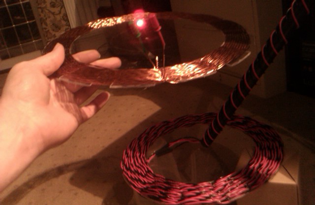

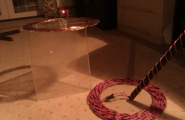

                      As a spin-off, I'm making use of a pair of my "failed" PI 12" coils to wirelessly trickle charge my "Sunday best" car when stored in the garage. The power RX coil goes under the plastic front bumper about 10" above the TX coil on the ground. Perfect alignment isn't necessary but I'm putting a charging LED on the dash to tell me when to pull-up (useful in its own rights). Still tweaking, but looking good so far.
                      • #41
                        Here's a quick photo demonstration of resonant power coupling - just an LED across the coil with a pretty big air-gap. The coil on the floor is way off resonance as well (450kHz but being driven with 250kHz - the resonance of the RX coil) matched coils would probably destroy the LED at this range! (those are 12" diameter coils to give you an idea of scale).
