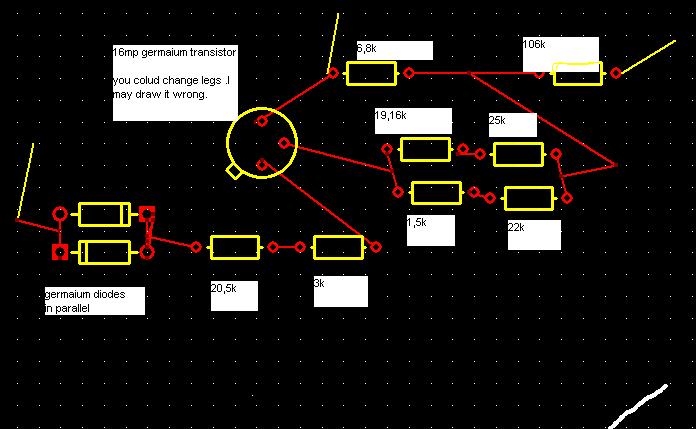

        what is the aim of germanium diodes in parallel connection.
        this could be connected to circuit to adjust something.
        because (yellows are wires.)wire in transistor leg uses the same wire with resistor network which have values of (0,82k,two missing resistor,5.62k,7.89k,10.18k ,13.4k ,18.9k ,19.77k ,30.7k ,41.8k ,48k)

          T1 ,T2 of this circuit and it's connections with cappacitances looks like mines.
          it has some similarities.
          http://geotech.thunting.com/pages/me.../US3875498.pdf

            If your father's recollection of the events is correct, then the secret is in the search head coil arrangement, not the electronics. This circuit is too simple to be anything special.
              Originally posted by okantex View Post
              hi
              It is quite common to see two parallel diodes in the feedback path of an opamp in order to produce clipping of the output waveform. Take a look at the Bandido II umax circuit diagram on this website as an example.
              Presumably these diodes have a similiar purpose here.

                  "It is quite common to see two parallel diodes in the feedback path of an opamp in order to produce clipping of the output waveform. Take a look at the Bandido II umax circuit diagram on this website as an example.
                  but in bandido diodes are parallel to cap,resistor and op-amp
                  in mine there is no cap ,resisitor in series and how can transisitor be in paralel
                  you know I am not EE.
                  if there is wrong in my ideas about connections of circuit ,please redarw it on paint program and sent please

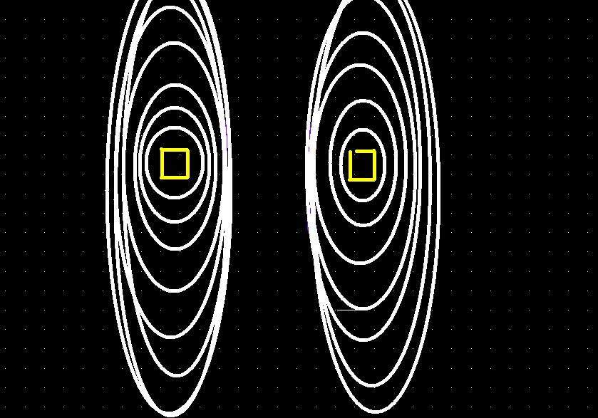

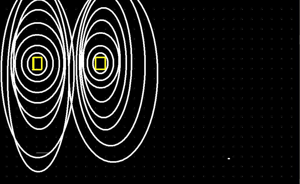

                    in mine there is only one transistor like this and it is( npn )in reciever part in my opinion designer useed transformer in transmitter .there current decrease and voltage increase and high voltage penetrare much.
                    I wonder something about transistors?
                    do the y just increase amper .or can they both amper and voltage at the same time?
                    I wonder what does my mp16?increase amper or voltage?
                    Does transformer has adventage over transistor ?

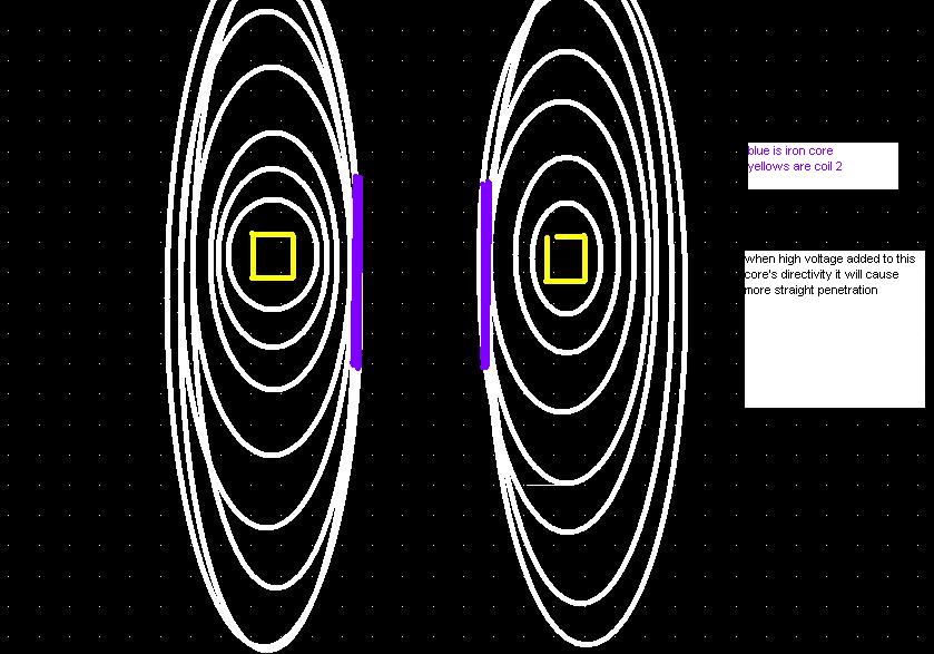

                    İf these high amper transistors used in circuit mens ,there iş high current in DRAINs .if so while reducing it to 0,1A ,we can increase vaotage four or five times more.
                    And form large fluxes.and by using iron core whose inerside isempty(hole),we will achive higher polarization and due to this more dept.
                    And while recieving reflected signal ,this iron wwill help us to collect more fluxes and increase amper.also means recieving weak signals.
                      sorry iron cannot be seen in previous pic because of fluxes.

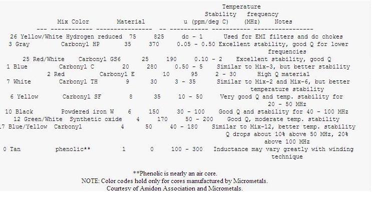

                            They are mainly used as power amplifiers and have a frequency response of about 100Hz.
                            100 Hz? Any iron-alloy cores can work at various kHz. Ordinary cores can use in frequency range few hertz to 15 kHz and special ferrite-alloys core very high. Of what you're talking? Maybe typo error? Is this a joke?
                            Here a link. Also post a table.
                            http://www.fis.unb.br/Fis3Exp/fcim.csdc.com/fcimis/compid/ind/toroid.html

                                Okantex said:
                                I learned all from the owner.
                                he said in head ,there was crystal and really small four selenoid windins .
                                four of them were positioned like a circle and perpendecular to 1. and 2.
                                The Magnetic Resonance Amplifier is in concordance with the image he post:
