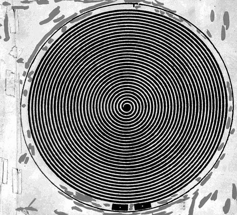

    Photos of the PCB coils can be viewed here.
      Please, somebody can repair the "noises" of the images (one is a film) with adequate program and post?
        The resolution on these images are way too low to be usable.
          It has an Inductance of 126uH and a DC Resistance of 25.77 Ohms.
          Even if it was done with 2 Ounce copper and Tin Plated, it would Still be about 12 Ohms.
          Sandshark PI coils are 358uH and 11 ohms.
            If you solder 1mm diam. wire over the PCB coil ,you will have resistance low then 3 Om.

                The real size of the coil is only 6 cm diam. but I increase X 1.5 = 9 cm. Look:

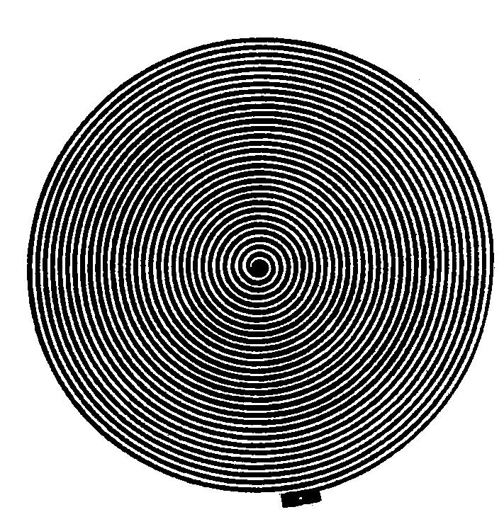

                  Try this ->
                  Download Easy-PC demo from http://www.numberone.com/index.asp
                  This has a feature that allows the creation of spiral shapes and tracks.
                  The demo is not time limited, but you cannot save anything. However, there is a way to save the image you have created:
                  Start Easy-PC.
                  Select: Add > Add Spiral
                  Fill in the dialog box to create the spiral.
                  Tick the "Circular" box.
                  Select "A" to fit the image to the screen.
                  Turn off the grid using View > Screen Grid
                  Select ALT + PrtScr to capture the image.
                  Paste into a graphics package. I used PaintShop Pro.
                  Cut and paste the spiral image.
                  Negate the image. (i.e. black on white)
                  Save to file.

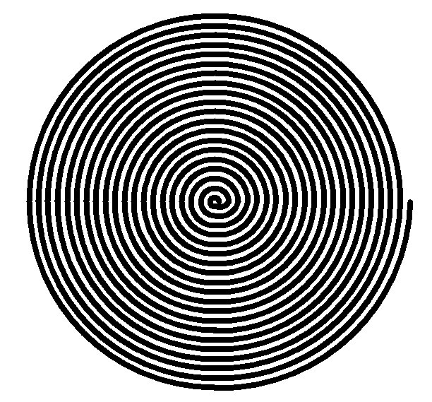

                  Here's one I prepared earlier ->
                  Note - you can easily create an image with higher resolution than the one below, but it's not possible to upload it here due to size restrictions.
                    Awesome... I own Easy-PC and didn't realize it now does spirals. Was added in V.10. In 15 seconds I created a 30-turn 10-inch coil. Does ovals too.

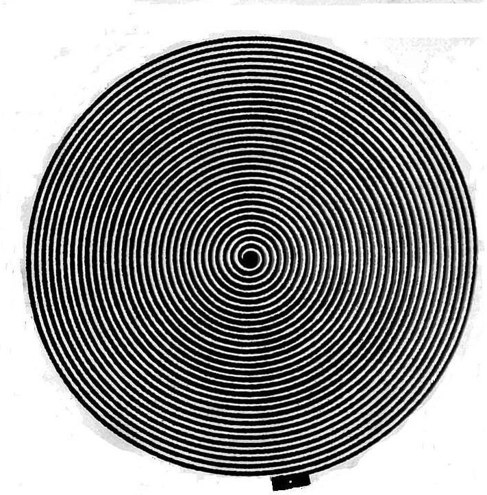

                        Downloaded Easy-PC, made coil design and printed using Output - plotting and Printing. Came out nice but still have to find a way to print a 12 " coil on 2 sheets.

                          Make a Smaller Coil, but With Closer Spacing and wider traces, of a size that will Print on a Standard Sheet.
                          Than Scan it and save it so you can than Increase (Double) its size.
                          You can than also Split it in Half and prit each half Seperately.
                          Capacitance is VERY LOW.

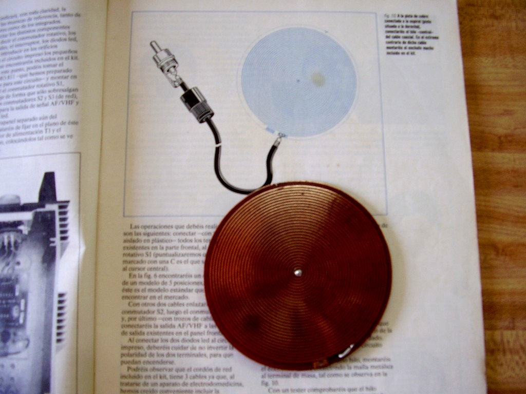

                                Double sided PCB coil
                                Today I made a double sided 2oz copper PCB coil.
                                Capsule shaped (straight sides semicircle ends)
                                50mm (one third) gap between the windings
                                Length 285mm
                                Width 150mm
                                Turns 33
                                Track width 1.0mm
                                Track interspacing 0.5mm
                                DC impedance 6 ohms
                                Inductance 250uH
                                Webers (flux) .00081250 (19.5 volts coil energization)
