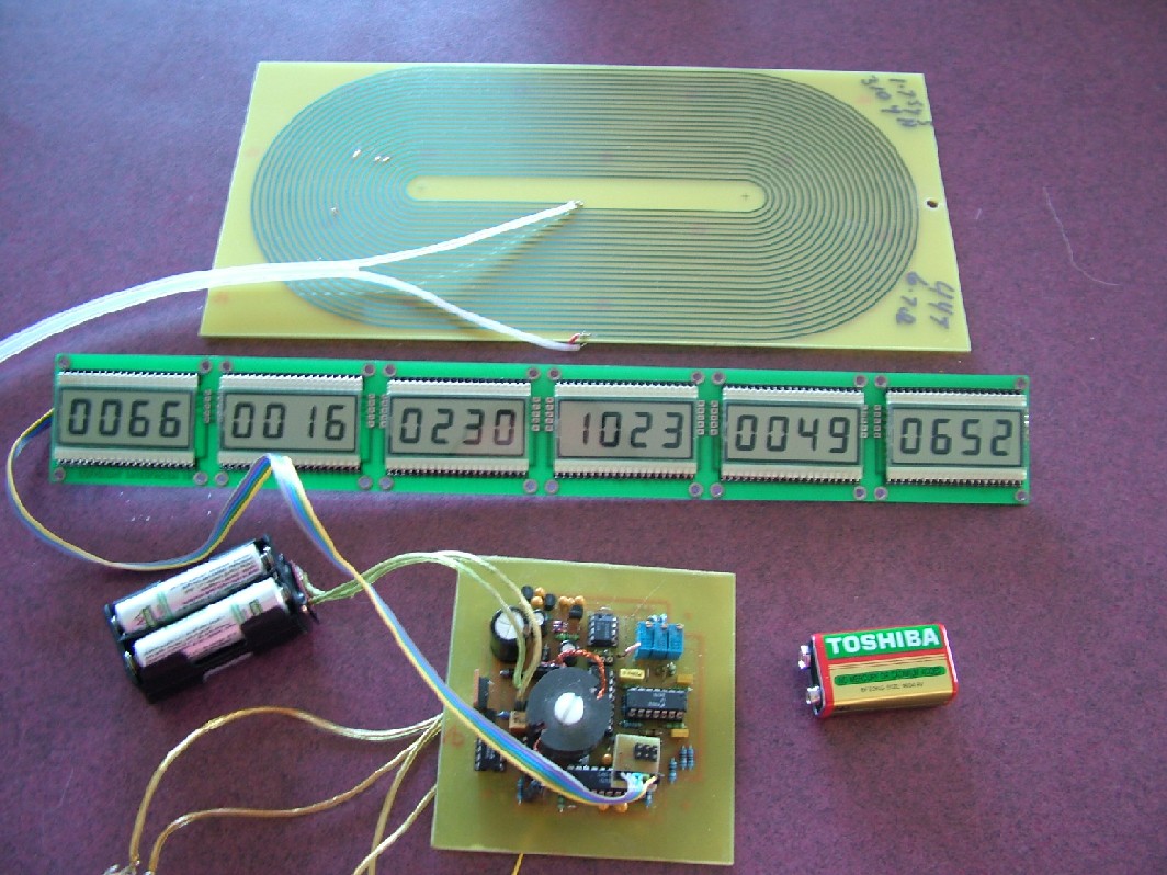

                            • #74
                              Attached pic is my PIMD, the 9V Toshiba battery is for size comparisons only.
                              The LCD screens really aid programming the Atmel micro-controller.
                              The unadjusted screens from left to right are, sample 1, sample2, sample3, Differential op amp from sample 1 and sample 2, difference between sample 1 and sample 2, and finally, raw battery voltage reading.
                              Things to note, pot core for SMPS generating 19.5v for the coil and +5/-5 for op amps and micro.
                              The PCB coil shown is referred to as "most recent" in previous posts.
                              bugwhiskers
