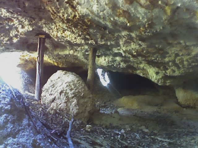

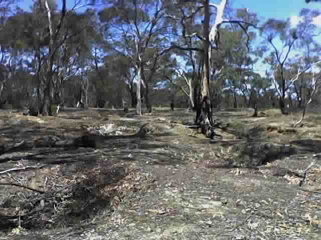

                            • Pics of some old gold country.
                              The attached pics were taken just outside Ararat, VIC Australia. One shows what's on top of the ground and the other what is underneath. There is still gold there, 2 nuggets totalling 1.7grams were found with a GP3500 in 10 minutes, the prospector had other things to do so he went home.
                              bugwhiskers

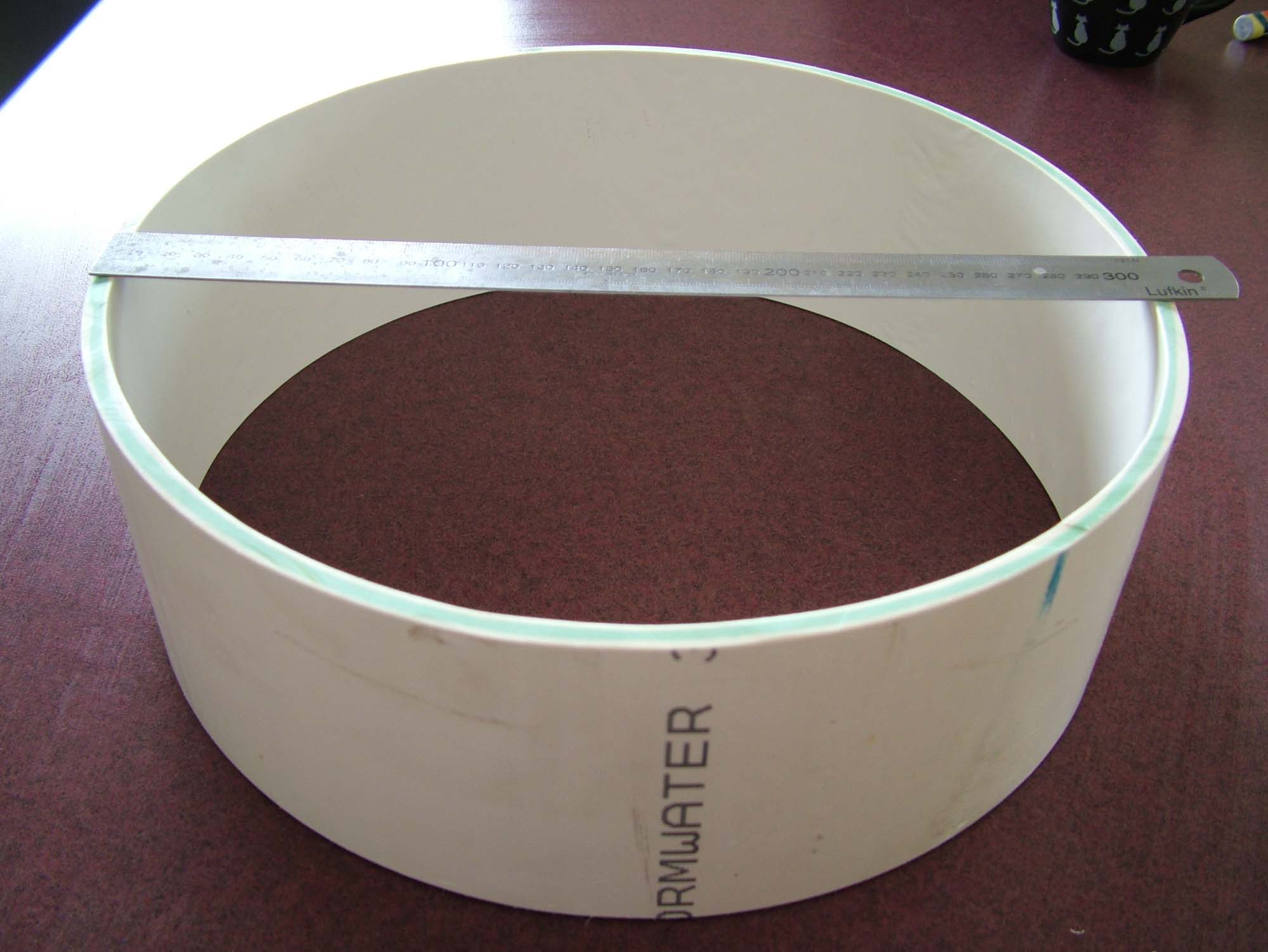

                              • Coil former
                                Hi bbsailor,
                                Yes... I am still alive...bad time of year, visiting in-laws and out-laws.
                                Attached is a pic of the coil former I spoke of earlier. It's PVC stormwater pipe 300mm ID, around 313mm OD. I have yet to put a cut in it to facilitate coil removal. Off to look at your new coil document to get some ideas on wire, #turns etc.
                                bugwhiskers
