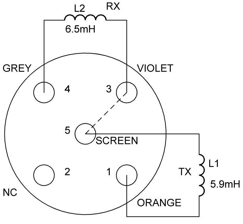

    Coils
      Coils
      The coil connection details are incorrect. In fact, the last diagram is one that I created while trying to debug a faulty Tesoro Laser.
      Here's the correct wiring:
        many thanks for the useful informations.
        What about wire gauge ? 30 AWG seems ok to obtain 22 ohm of resistance (KT315 data for tesoro concentric) on 62.832 meters (100 turns) : is that correct ?
        I have to wrap the TX and RX in opposite direction like in the drawings, right ?
