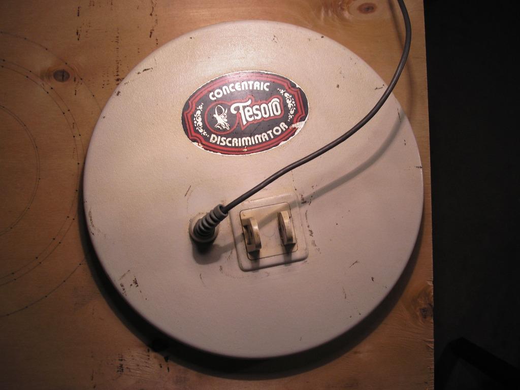

    I lost my head.I building Tesoro Bandido, I used original coil, but it did´nt work.In pin 7 IC7b (by Carl schematic) is signal with amplitude 0,6V.Looks-like coil not balanced.It is used coil but outside view is OK (not opened).In all metal position (with switch S1, auto-tune connected) it detects 2cm coin at 22cm, but if I open S1, it detects coin only at 2 cm.Can You give please some ideas?

      Hi Max
      I cheked connections several times and all looks like OK, yes one lead of RX is connected to GND and I tested my pcb in several rooms of my house, but nothing. I have original Bounty Hunter Discovery 3300, I tested it in my workroom, to see how it works, if there are noises, but nothing, it works OK.
      In days I try to test Tesoro coil in other shematic to be see, is it really unbalanced (I dont understand, how original coil with no deformation can become unbalanced at all).

          Hi Max
          I tryd my Tesoro coil in other (Volksturm project) shematic and it saw too coil unbalancing.Yes, for me now two ways, balance the Tesoro coil or made new coil.
          I opend it and still don`t understand, what is wrong in original coil.Inside looks like OK, nothing broken and nothing moveing.
          Satel

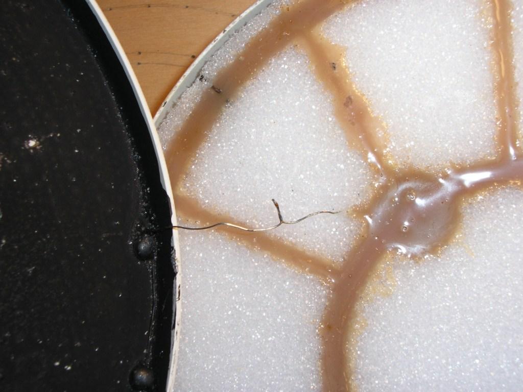

            Yes - I have a Tesoro Laser coil that looks ok. Even the inductance and resistance values measure as correct, but it just doesn't work properly. This is a big mystery.
            One day I will investigate this coil more closely, but at the moment it's a dud.

              Hi Satel,
              yes it seems ok.
              Don't know if can be in this case...but...maybe the problem is around cable guard or something else, not on woundings.
              Sometimes cables broke in a subtle way...you have a lose and unstable connection and this may result in unbalace. I suggest to connect a digital ohm meter to tx and rx pins with stable contacts at connector then try to move the cable to see if any change in readings occourrs.
              If so some broken cable causes problems.
              I think that small mV variations could occourr also with no perfect connections between coils and circuit here.
              Just an idea...other things seem ok...I mean positioning and epoxy layer.

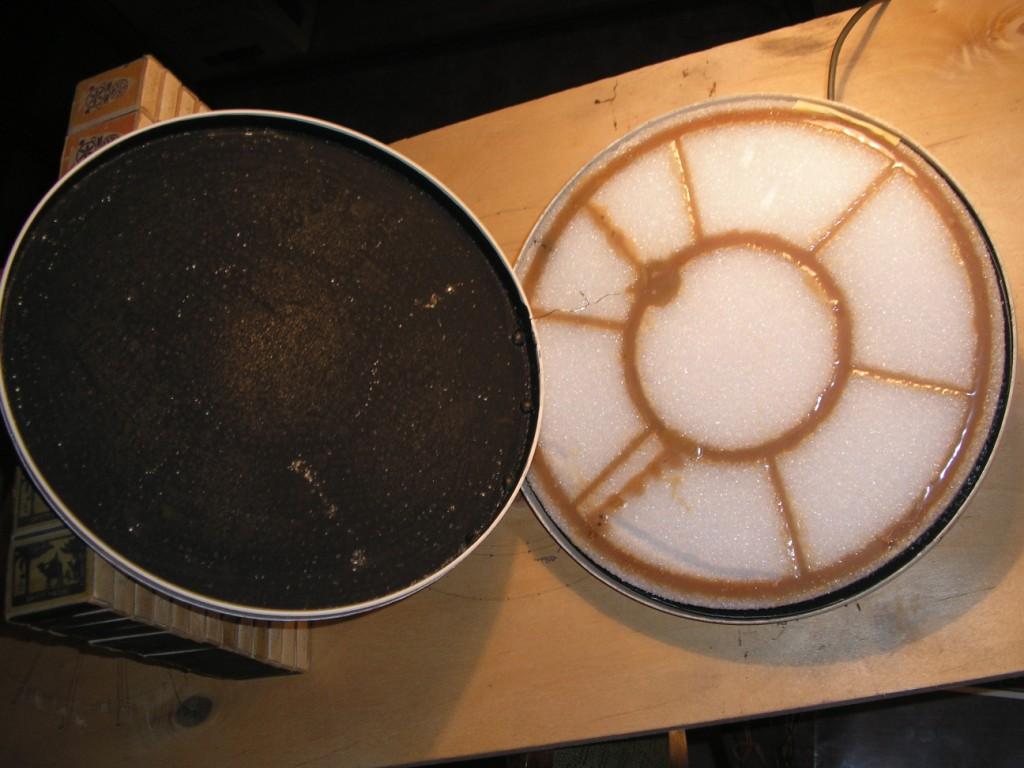

                Hi Max!
                If You remember, at last I have a problem with nulling Tesoro Bandido coil (my original Tesoro concentric coil was not balanced).After little break, I return back to this detector, I made new coil, and the same story.I start thinking, that something in my nulling procedure is wrong.
                Now my question is: When You balanced Your coil, ch1 of oscilloscope You connect to TX (collector of T1 by shematic Gary Lecomte)? and ch2 You connect to RX, (RX in parallel with 47nF cap and lead resistor 1k) directly(without shematic) or You connect ch2 to pin 7 of IC7A (by shematic of Gary)?
                Sorry my long question and I hope, You understand it
                Thanks,
                best regards
                Satel

                  Hi Satel,
                  I connected tx coil to tx pads to have 10Khz oscillations on tx coil. Then measured rx-rx1 signal using 47nF cap and 1 Kohm resistor in parallel with rx-rx1 leads directly connecting with my oscilloscope probe.
                  In nulling I connected directly rx-rx1-cap-resistor to probe and not to rx pads on pcb. I'vent used ic7 at all for this. To avoid offset problems that may occourr if not balanced first...and mc33178/mc33078 haven't direct control on offset nulling - so, then too, it's nothing in schematics to do offset nulling on IC7.
                  You only need a scope and a probe to test for voltage null on rx-rx1 coil.
                  Someone used ic7 to do this nulling but I think is incorrect for the reason explained above.
                  Best regards,
                  Max

                    Great thanks Max!
                    Thats my mistake was-I tryed balance the coil in shematic.Shame me! I control again my original tesoro coil and its OK, null is 7mV.Now I can continue with my other parts of schematic.
                    Best regards
                    Satel
