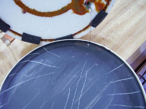

            I never did try to see what depth loss occurred but I found if I simply made slice marks in the mylar sheet such that the sheet looked more like a thin center strip with a bunch of fine thin strips much like tinsel hanging off of it, the stuff still worked well for shielding and wasn't detected. I ended up gluing a piece of this mylar to a round piece of thick paper the size of the coil housing and then cutting thin slices in the mylar. I would check to see if it I could detect it and once it was weak enough, I tried it for a shield. It worked fine.

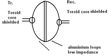

                This Wilson detector has coil housing with a certain kind of paint and with some marks. I think one of the best solution is to shield only the coil of the sensitive part, this is the receiver coil, and leave free of shield the transmitter coil.
                Also a low impedance coil based on aluminium loop can be a solution. But here you need a system for to eliminate vibration of the loops...
