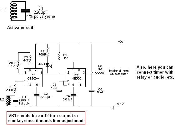

    I'm a little bit of a newb at this so bear with my simpleness. I'm wanting to make a coil system similar to those used for shoplifting alarms. I'm just wanting to detect when a 'device' is inside the loop of a single sensor coil. I was thinking about using a PIC to do any figuring out of stuff that needs figuring out, but not sure how to exactly go about it - preferably it wouldn't be triggered when in the presence of metal objects - just the slave coil. - What's the best - easiest/reliable method of doing this? Do I pulse a frequency and look for a return? Do I look for a frequency shift when a similar tuned coil moves into range? Any suggestions would be greatly appreciated.

      Coil sensing schematic and website (LOOK ALL THE LINK) and GREAT INFO!!! in pdf:
      http://www.abelsim.co.uk/doc/help/tbellex2.htm

        Hey, that's perfect info - just what I was after thanks - tho I can't seem to find the CS209A anywhere does anyone know of any suitable replacements?
        Cheers
          I've found a TCA355 manufactured by Siemens which might do the trick, how do I figure out the frequency that the coil/capacitor resonator will resonate at? Thanks
            CS209 Used to be made by Cherry Semi (Yes the same people who made the keyboards) but now it's an OnSemi (Motorola) device.
            This device is still used in countless probes like the Sherlock, and many others. Not very sensitive though.

                  The CS209 was Discontinued years ago
                  But I Also have the CS209.
                  But be aware that its maximum detection distance is LESS than one Inch.
                  There is a Simular, Newer device, part number "TDA0161".
                  I have it also, but its also a Poor detection distance, like the CS209.
