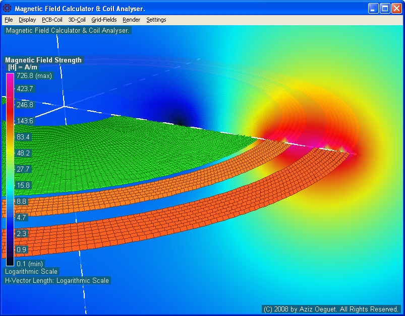

    During last days, unsleepy nights and weeks, I improved my coil analyser software. This will help us, to understand and improve search coil configurations in the future. Give me more time, to finish the software coding. It is really impressive to change the 3D-Display in real-time.
    Following screen shot of current software.
    Aziz
    A lot of work is done during last days but not enough to get a good software to analyse the MD coils. I am still working on it.

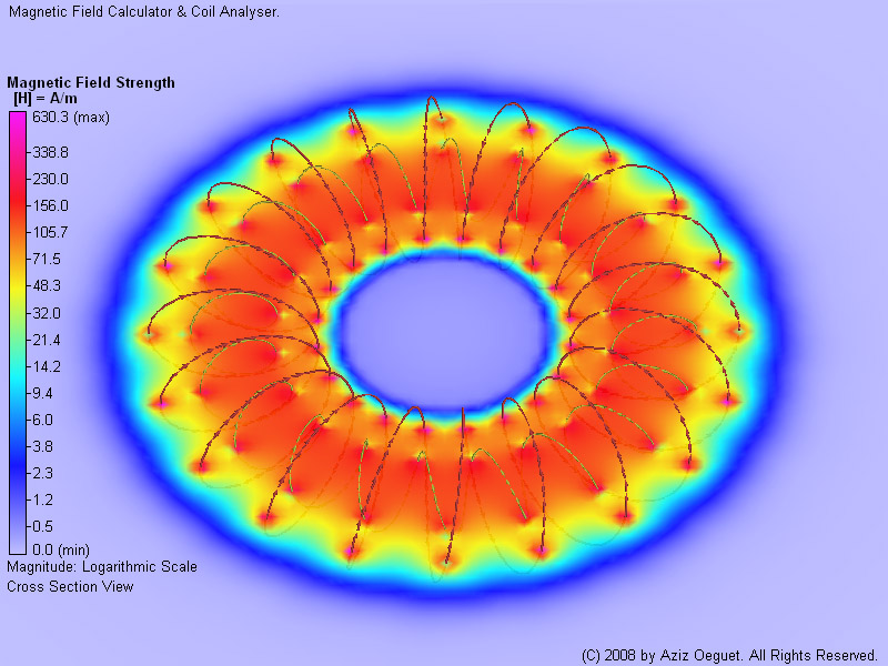

    Interesting double toroid coil arrangement (see below). But nothing for MD - just for education.

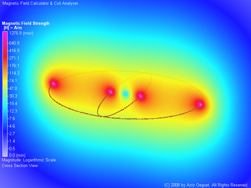

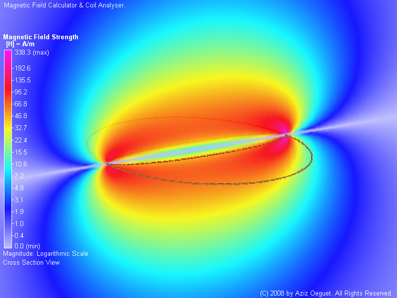

          Hi bbsailor,
          I just implemented the coil design software to generate DD-coils. It was easier than I have expected. I have combined two different elliptical coils with Radius a, b and a2 (short Radius). The this gives a more practical coil form factor. Indeed, the cross section magnetic strength field looks like very interesting. Without analysing deeper, I put two cross sections (x-Axis, y-Axis) of same coil configuration. 10 windings, 1 A. Winding directions see wire parts on graphics.
          For further analysis, I need the following feedback:
          - Radius A (big elliptical radius towards x-axis)
          - Radius B (big elliptical radius towards y-axis)
          - Radius A2 (small elliptical radius towards - x-axis = negative x-axis direction)
          - Number of windings of each coil + direction
          - Current flow (same?)
          Aziz

              It looks like a DD coil pattern matches what a DD coil field pattern should look like. DD coils have a wider field pattern than a mono coil field pattern that is more pointed in the center.

                give me more time, to implement new graphics functions. Due to the asymmetry of the coil arrangement, I want to display cylindric rotated cross section fields. Then I will start analysing some of the configurations, that you mentioned above.
                Indeed, the magnetic fields caused by two transmitter coils, gives a more depth range possibility. Of course, this applies not for DD-coils with only one TX coil and one RX coil.
                The graphics on DD coils above are individually log-scaled. On the next graphics I will do equal scaling for all graphics, that can be compared easily together (same color for magnetic strength).
